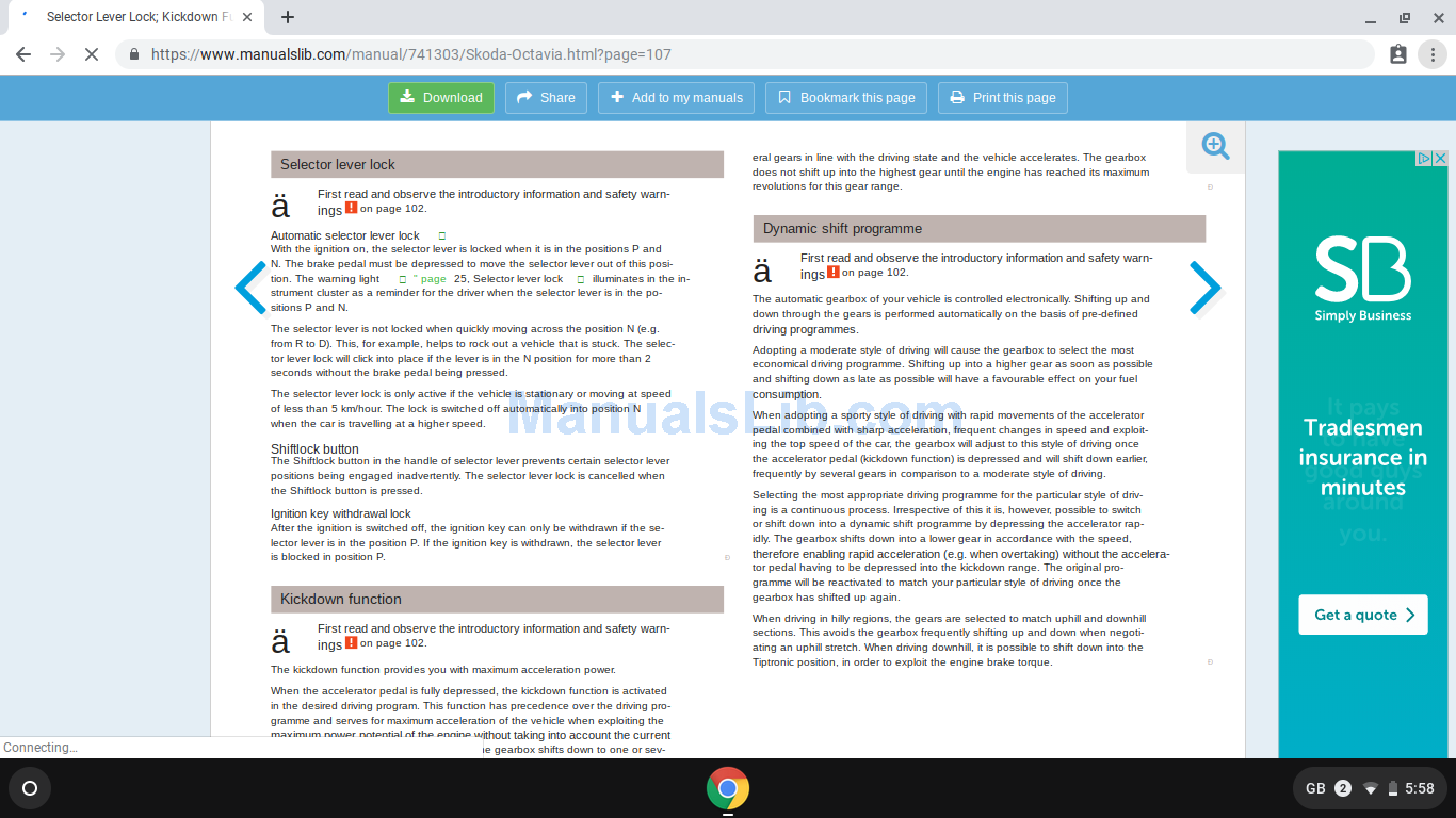

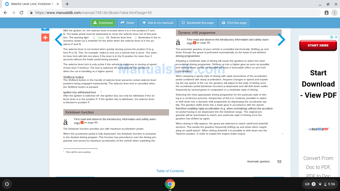

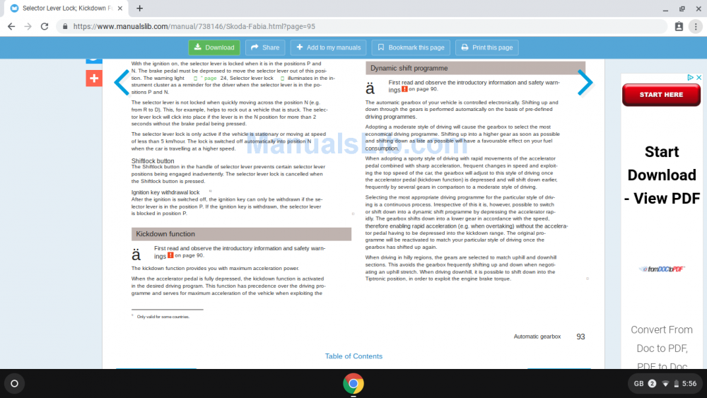

DQ200's 'Dynamic Shift Programme' Just in D the DSG behaves the way you want it to for getting a shift on and then reverts back to its more fuel efficient shift patterns.
