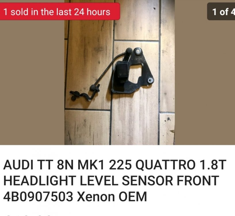

He reckons this looks fairly close to it?

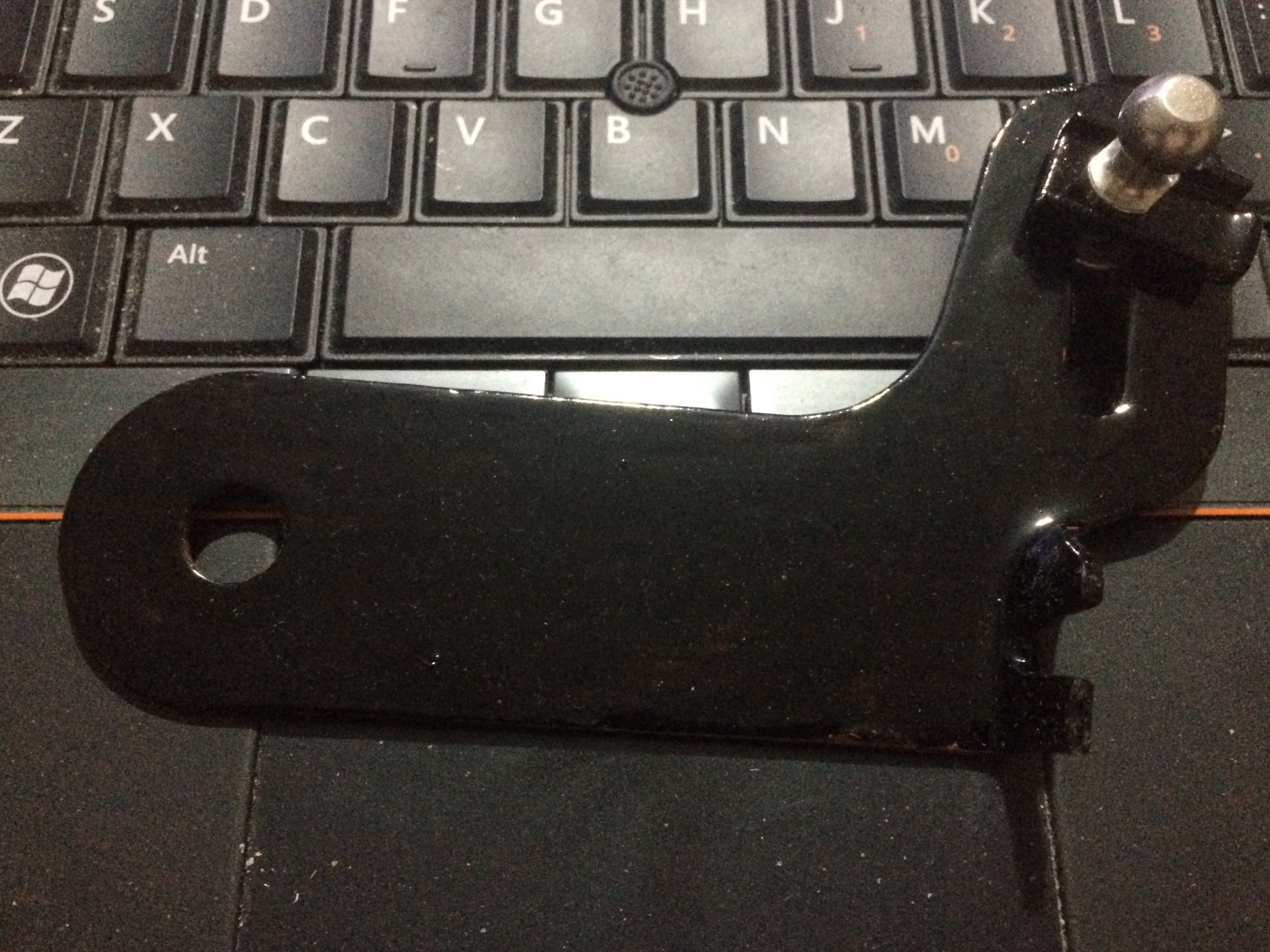

The sensor and the arm/rod look the same just the bracket that fits on the front wishbone is different it should be like this
Think it's possible to just buy a plate and transfer it over?
That plate should be available from Skoda/TPS use that link I put to get the part number
