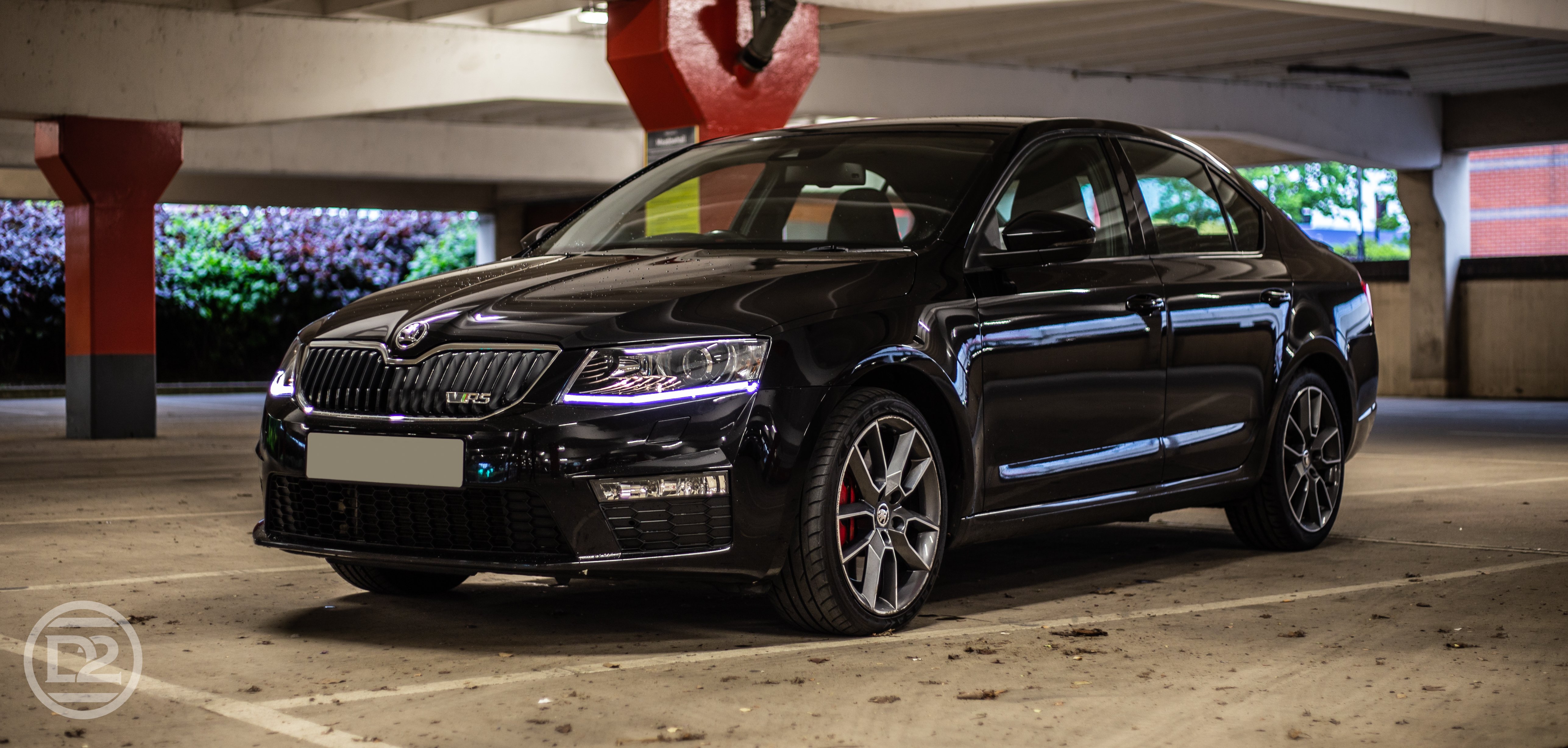

re wash - ( found some Demon Shine Snow foam kicking around) Snow foam with lance, Usually use Chemical guys or Dodo Juice snow foam and let soak for 15 minutes, the car was heavily soiled as i made the dealer promise not to wash my car and it had been delivered from Scotland.
2 Bucket Method - I was shown this a few years ago whilst at a show and swear by the method. The soap i used was called Iron X , gets rid of the fallout and iron particles to leave the paint smooth. For those that have never used this method, both buckets contain grit guards , one bucket contains your soap and the other contains just clean water make sure to use lambswool mit. Every panel you clean you then dip the mat in the clean water and squeeze. This gets rid of grit and grime to prevent scratches.
Clay bar- I usually add this in if I'm not happy with how the panels feel afterwards. Bilt hamber or Megiuars are two that ive used.
Polishing - I used an Orbital buffer with varying speeds and Mezerna 400 swirl remover with polish and an Orange Pad. This got rid of the bigger swirls and smaller scratches.
Wax/Sealant- Best stuff ive used in a long time is called FUSSO ( mostly used by the jap show cars owners) The particular ones i used are by Soft 99 and called King of Gloss (Sealant). It has great hydrophobic properties that give nice beading when it rains and generally keeps the car's maintenance washes down within a 3 month period. Ive also found Sonus has really great waxes as well but haven't used it on this occasion.
Windows- The water is quite hard where i live so i generally get water marks if I'm not quick enough with the drying towel whilst the car is wet. I use general window cleaner by Astonish to get the grime off and then finish it with Autoglym Glass polish.
Engine bay- I use a foaming spray by a company called Gunk. Foaming spray ive found to be the best for this type of stuff because even when you over shoot your still taking grease off something else. I leave it to soak for 5-10 minutes depending on the grime levels.
Tyres- Enduro gel by Megiuars, ive found nothing that lasts anywhere near as long as what this stuff does. Even works great added to outer plastic trims.
Alloys-  Auto finesse iron out is my go to for this. Ive tried a few others one being devils breath from Chemical guys ( AVOID ) dreadful product that leaves you putting in more elbow grease than what is required. I then seal these as above.
Interior- Carpets/seats I use 1000/1 soap detergent and brush it into the carpets and seats. I leat it sit slightly before further agitation. I then use a wet vac and extract the Nastiness.
Dash- Ive just tested Turtle wax interior shine with air freshener. I have to say for £4.99 its a great product but i have nearly used 3/4 of the car on one go to bring the dash back to life. Tiny scratches on the plastic carbon trim i removed the majority with Autoglym Metal polish. This was a trick i was shown in the motorbike world to clean plastic lenses and screens. A small smidge added to a cloth and buff and then clean off with the cockpit shine.
Thats my method.
