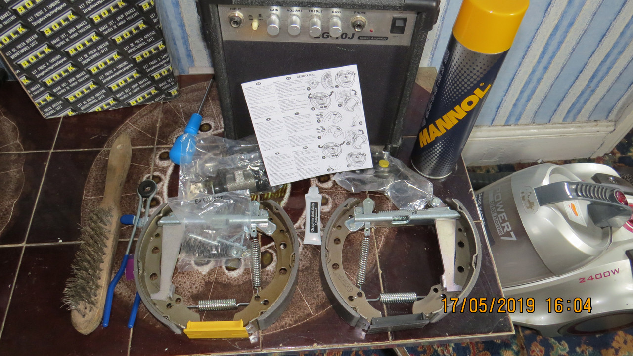

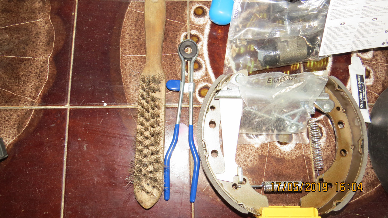

heres the update guys
got the drum brakes, brake cleaner and the hose clamp. just need to wait for the glide piece and grease then i can start on the job, hopefully will turn up tomorrow :)
finally done it, only took 2 days :D
foot brakes sensitive and handbrakes is quite tight. all in all, very good work :)

...Unbelievably, Mr Auto are selling clutch kits from as little as £35.10! This is for a 1.4 diesel so may not suit all but hey!
The brand is Bolk... I have little inside in to their quality but Mr Auto seem to stock many of their components so they must trust them!
Obviously fitment is an issue but the closest thing to that in price for a decent, known brand will be around the hundred mark.
I think I would be inclined to fit one if I was planning on selling the car, for sure. I would look around a bit, for other users to get feedback of the quality, if I was keeping the car and thinking of fitting one.
The thing is, unless you know what a clutch fitter has fitted, you could still be buying such a low cost part, despite being charged for a higher value one!
Looking at Froggy8's photo's, he/she is happy to fit Bolk parts and if you fit their stoppers, well then, anything goes!
