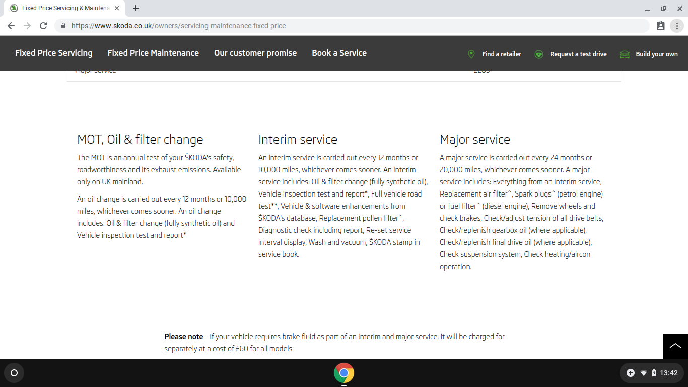

Edited by Skoffski
1 hour ago, froggy8 said:
ok lets say its the rear drums, do i just need to replace a pipe or is it something else?
As below :-
15 hours ago, spartacus68 said:
My money is on the rear cylinders. If they are leaking, renew the shoes too.
18 hours ago, AGFalco said:
rear brake wheel cylinders
And then bleed the brakes.
Thanks AG Falco
