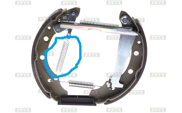

ok have ordered this yesterday and it says i should get it tomorrow so can try fit it this weekend but cant help worrying that i might need to take the middle wheel off( dont know what its called) or maybe take the side spring out of the kit and put it in an angle so the side metal plate can go in first then once i have manage to put the kit in then put the spring back?
https://www.mister-auto.co.uk/brake-kit-drum-brakes/bolk/bol-c121076/
Fit the top ends of the shoes in place on the new wheel cylinders first.
If you look at the photo in the link to the parts you ordered at the bottom of the right set,
You will see a yellow block which needs to be taken out before they are fitted.
( it is black on the other set and this also needs to come out when fitting the set. )
If you remove the spring from this bottom half of the set it is a lot easier to fit.
Refit the spring before you lever the ends of the bottom of the shoes on to the holders.
Hope this makes sense.
Thanks AG Falco

do you mean this spring that is in blue circle?
