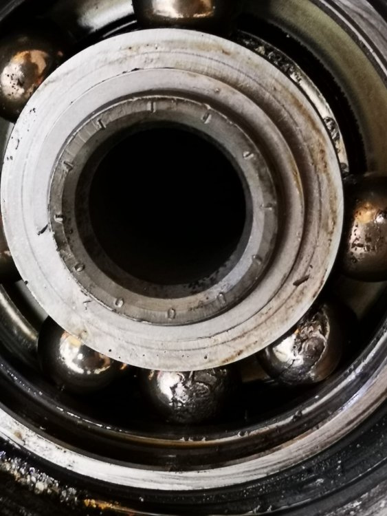

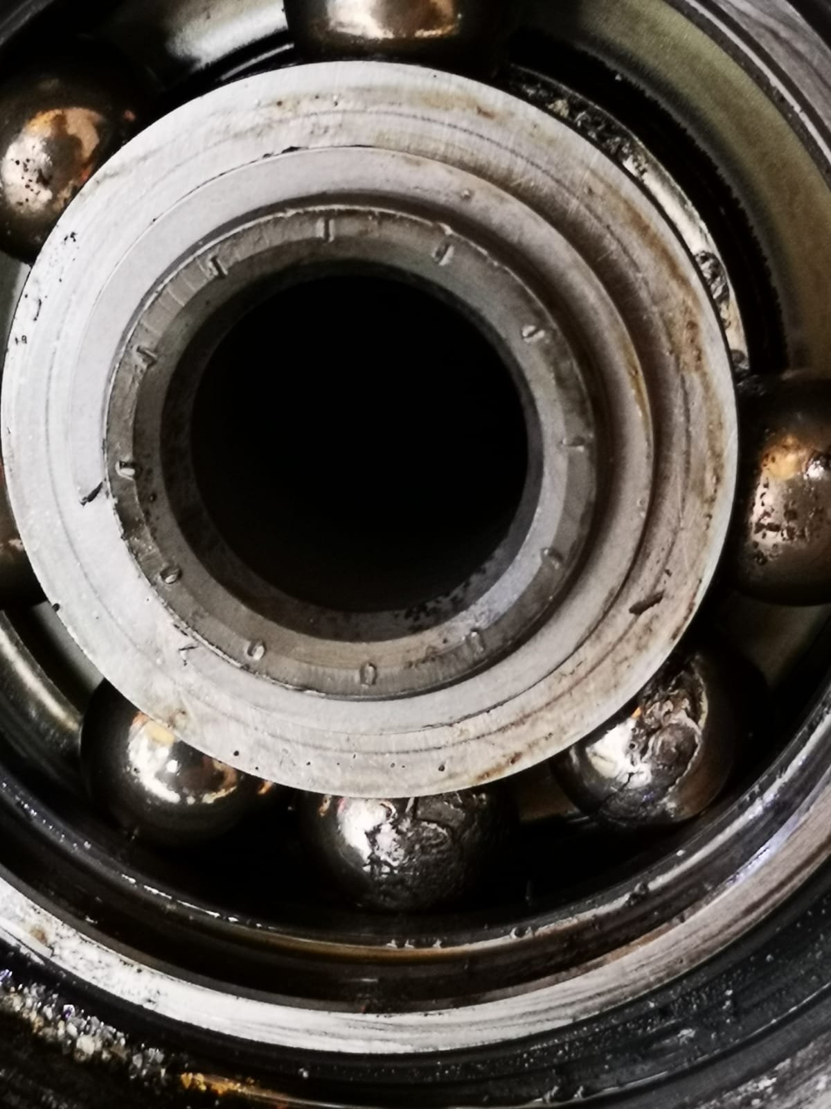

To close this query off, I decided not to swap the boxes/DMFs/Clutches from the '16 plate to the 62 plate car.
I bought the noisy 62 plate one, had the box out and the clutch & flywheel appeared to be OK.
We popped the plastic cover off the tail end of the gearbox, and the end bearing on the input shaft was in a sorry state.
Drained the box, there was a bit of metal flake in the oil and on the magnet.
Opened the box up - everything else looked perfect.
So - swapped the bearing (machine shop job to press it off/on), rebuilt box, replaced clutch, also did discs/pads all round, front ARB links and the o/s/r wheel bearing.
All back together now, and it's quiet as a monastery. Lovely.
According to the machine shop, this bearing failure isn't at all rare on these 'boxes.
