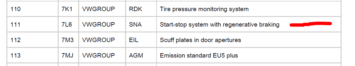

Well howcome my production specification says regenrative braking system ? I dont think you know what you'r talking about, as this system at braking utilizes engine braking to spin the alternator to charge the battery.
Well let me assure you that I do know what I'm talking about because I'm an auto-electrician by qualification  and as far as I know my own car does not have this feature even though it is top of the range Superb L&K with just the full Monty when it comes extras with the exception of keyless entry and ignition and hill hold as I did not want these features. My car is 2013 model, if yours is 2014 then it might well be different. Are driving a Superb or an Octavia because your seem to infer that your talking a Superb but on the member details section of your posts it states Octavia 2.0 tdi DSG, 2005.
Even with regenerative braking, it should not be that noticeable as it only designed to keep the battery fully topped to enable the Start/Stop system to function as many time as it can in order to reduce your Co2 emissions, so if is really noticable, refer it back to the dealer.
Well the Mk3 Octavia Greenline model came with regenerative braking to top up the battery as well as 15mm lower ride height, low rolling resistance tyres pumped up to higher pressures and stop/start to ensure it could achieve 88.3mpg.:clap:
Well from that I can only assume that my superb is a bit more top of the range than Yours, my Superb is MY 2015 (produced late 2014). Model 3T FL. I would advice you to read SSP 426, which i have just found, which describe this system.
