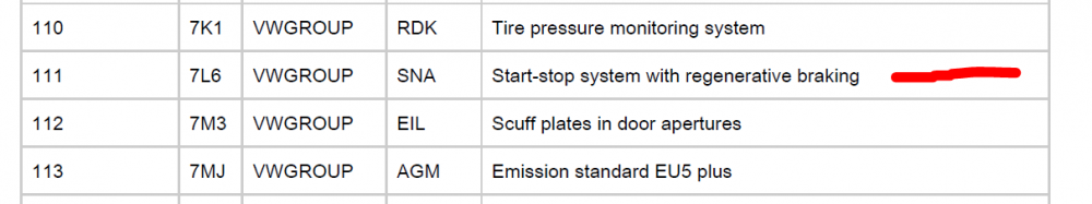

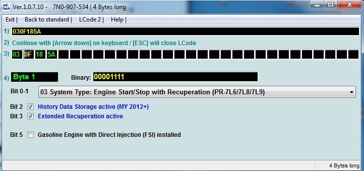

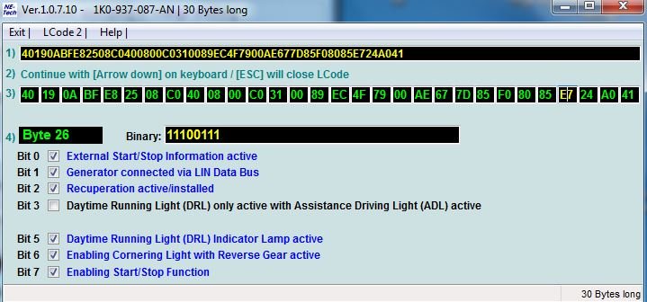

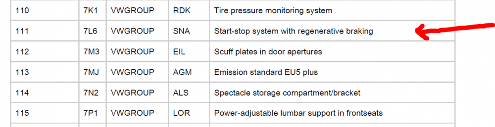

Well the production document for my car, says something different! Pls. look at photo.
As well as the Battery regulator module installed in my car. See photo.

Eeehm... The first photo taken from production specification on exactly my car. It says, and i Quote "Stop Start system with regenerative braking".
The screenshot from battery managment says the same.
The last photo is from the 09 BCM module - which states that recuperation is active.
How can you then claim that there is not regenerative braking on my car ?
