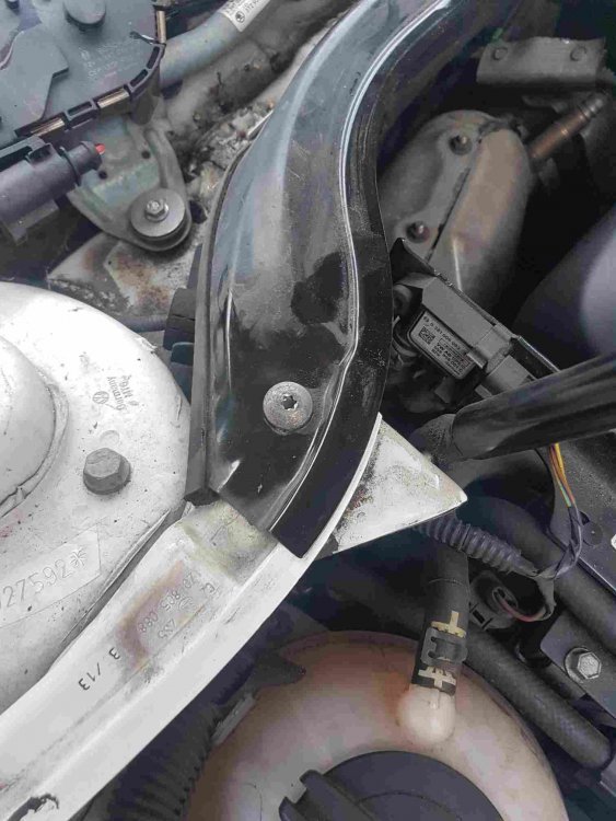

Hi
Sorry for delay, but I've stabed  myself into hand with one of my knifes, so I was out of order for 2 weeks.

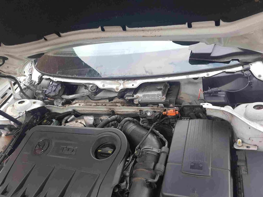

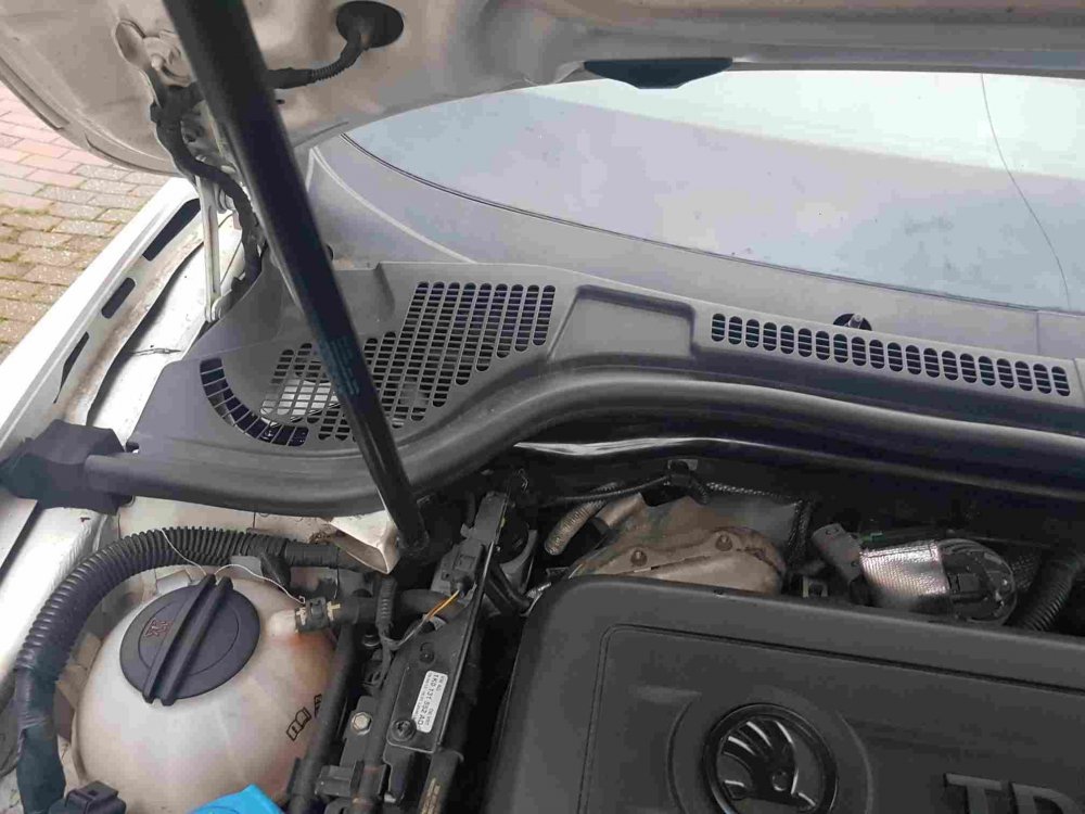

Few pics for how to:

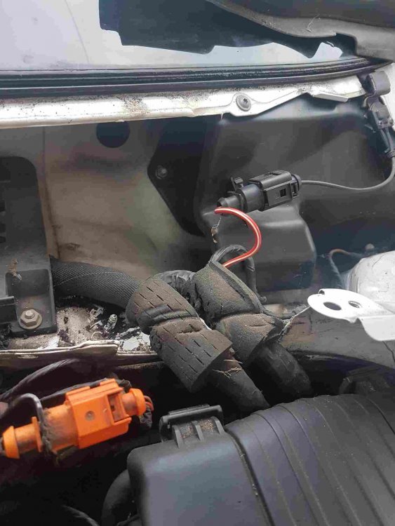

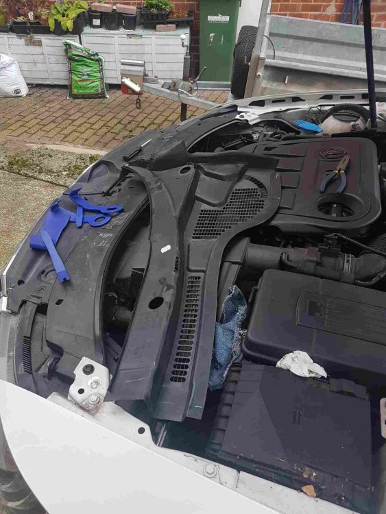

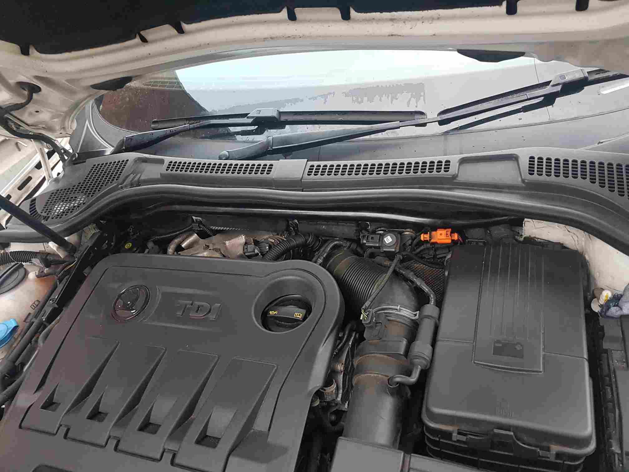

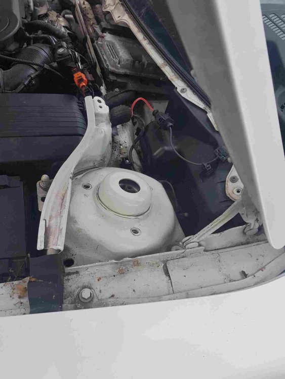

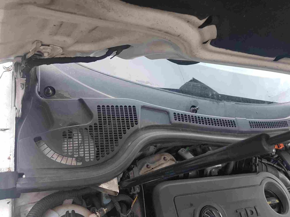

Take off both wipers. Spray some wd40/oil penetrator and wiggle them of the shaft.
Remove both cowl trims. Start from the middle and pull them off gently. It's only "push fit" type fitting. YOu can use narrow nose pliers to make job easier.
UNscrew 2 torx bolts (t30 I think)
20201017_160800.thumb.jpg.335c833c8258d24f98a22cc43ea1e0a3.jpg20201017_160805.thumb.jpg.41b38fdc24edee08cb2408031b6e453f.jpg

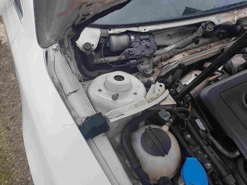

Remove metal "wall"
20201017_161405.thumb.jpg.0407281c563b128298deb563339251cc.jpg20201017_161409.thumb.jpg.607f5097d309f0271b369954b0c47c25.jpg

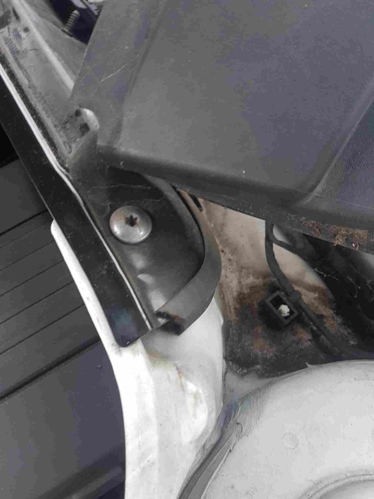

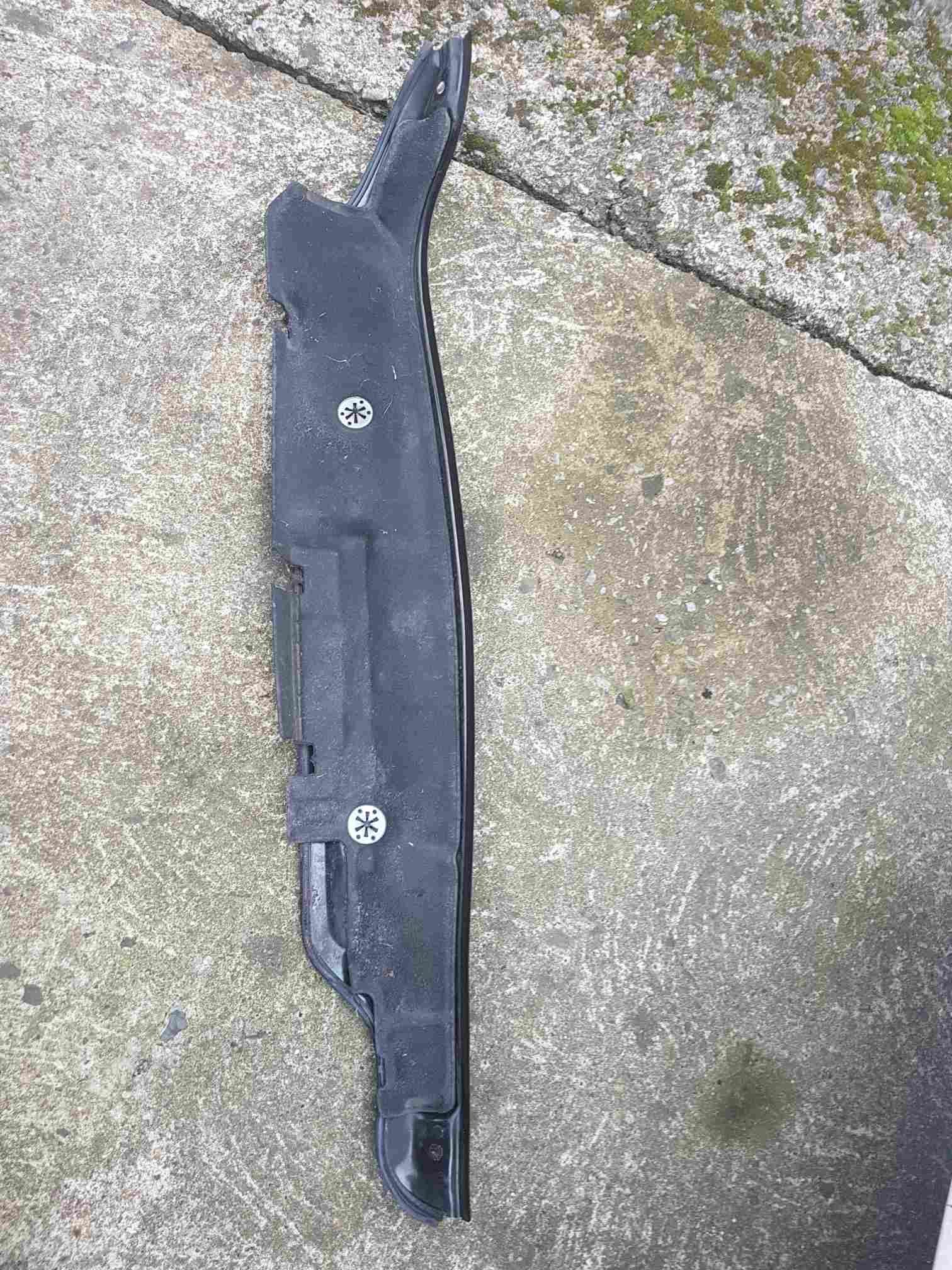

Remove plastic trims
20201017_162448.thumb.jpg.51e67b6c7aeca18755ea4f4b8981e2a7.jpg20201017_162456.thumb.jpg.bbda67a743644b7b83748a03f3d3eadd.jpg

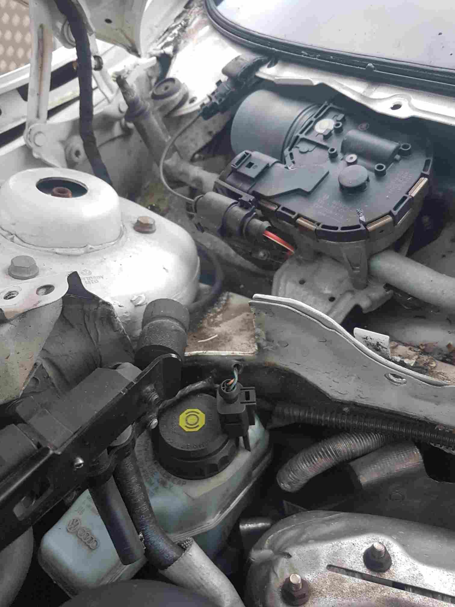

REmove 6x 13mm suspension bolts. Do that in stages, not in one go.
20201017_163425.thumb.jpg.d4fe2ce1b769a74360dea095c962b91d.jpg20201017_163445.thumb.jpg.99b488c7ba474439777023c08bdfa165.jpg

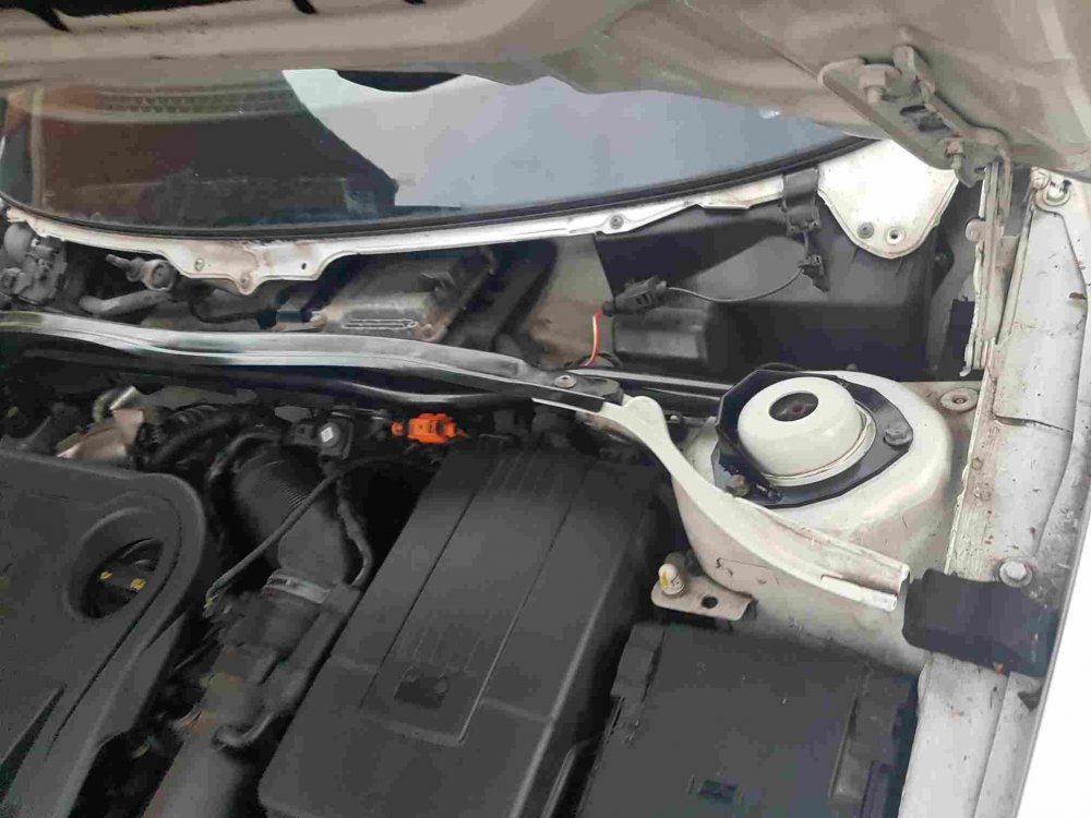

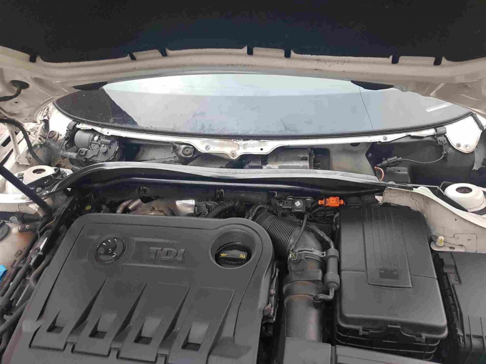

Install strut brace - use same screws. They are long enough.
20201017_165902.thumb.jpg.24458cd2709f0482a85ca4dd372122aa.jpg20201017_165910.thumb.jpg.79463f348fa22d9c200ea52799eeed4d.jpg

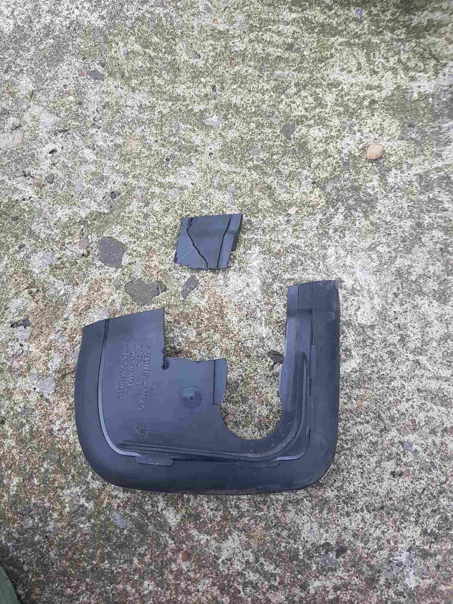

You will have to cut one trim (if you want. You can just leave hole). Other side can be left without plastic.
Metal "firewall" may need cutting if you really fussy. Mine is not cut, you just have to persuade it to fit ;)

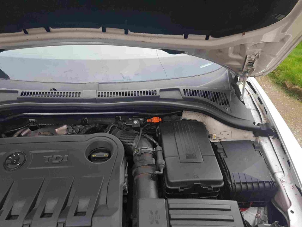

Put everything back together.
Most annoying job is to remove  wiper arms and cowl trim.
