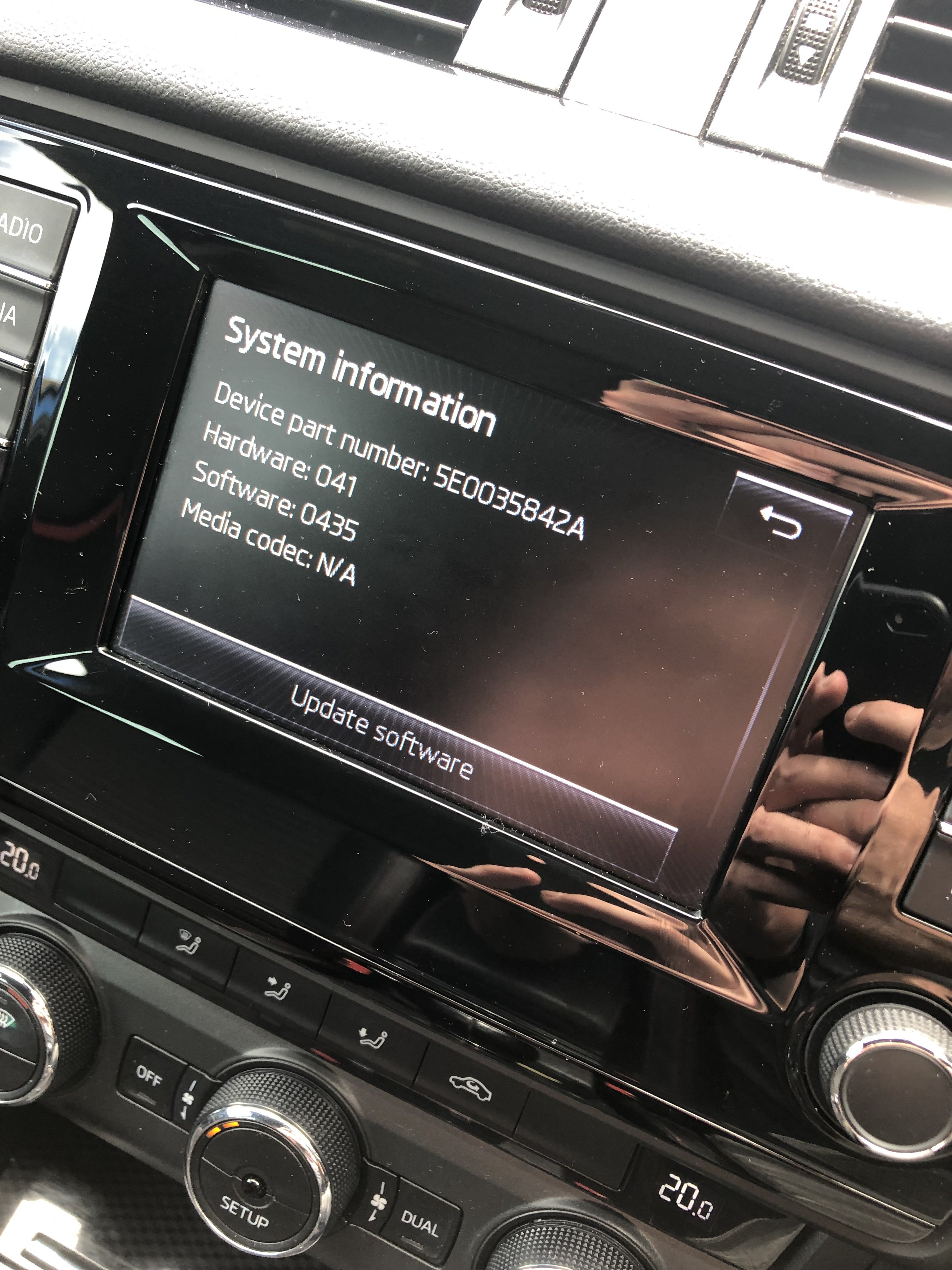

Can I get apple CarPlay to work on this, if what I need to change to get it working?
Looks like an MIB1 system, what year and month is the car?
Apple car play/Android auto can only be activated by a dealer on an MIB2 system, which were fitted mid 2015 I believe.
Dealer inputs a licence code, costs about £120 as mentioned
Ah, my cars a 2014, could I just get a new screen and have it activated or is there more involved?
The screen is just a screen, there is the glovebox unit also, which contains the processor and connections. Not usually viable, is probably cheaper to fit an aftermarket unit.
That is indeed a MIB1, to get CarPlay you will need to change the screen, the radio and the USB. Pop over to my build thread and you’ll see loads of info on there as I’ve done this twice now :)
I’m guessing that will cost a far bit? Not overly bothered but it would nice if it could be done without spending a fortune!
Depends which radio you want. MIB2 Amundsen with an 8 inch screen fully activated is running about £500 all in these days, just over double for a MIB2.5 Columbus like mine.

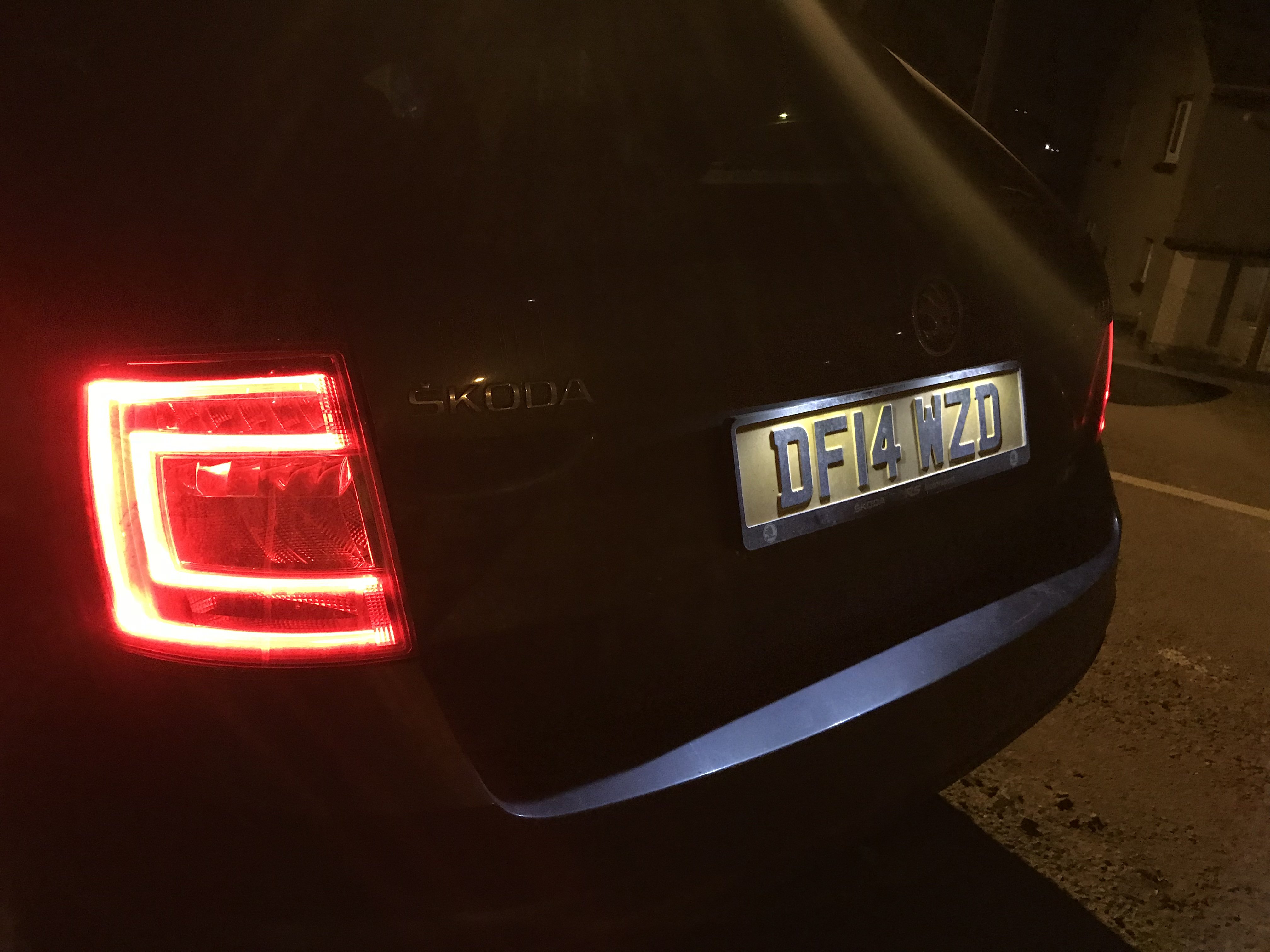

Has anyone bought the Ebay Leds for the interior and license plate. I know buy cheap buy 4000x but in the past I haven't done too bad with Ebay canbus free ones.
There are genuine led units you can fit for the number plate. You'd be better getting the led units rather than a led bulb in the halogen housing.
For interior I used some Osram ones off Amazon. Bit pricier at about a fiver a bulb but a perfect white 4.5-5k rather than the blue tinge 6k+ ones you usually get cheap on eBay. Also warrantied for a few years too I think.
Have you got the links for the bulbs ?

Just remember that LED plate lights and sidelights etc will need coding to run LED’s, otherwise you will get bulb failure warnings. Also changing the front indicators requires cutting the back of the headlight and then putting repair bungs in which can be bought from Skoda. Interior is not monitored by CANBUS so it doesn’t matter in there.
Is this where ive seen the programming function that has been stickied ?
ive always just ran canbus error free bulbs and never had an issue back when i used them on my VXR and that was a nightmare canbus system. Take it is totally different system.
Yes, to make changes on the car you will need an OBDEleven device or VCDS. There is a lot that can be done with these cars. You can get error free LED’s for the exterior bulbs but they never last. You can get OEM LED plate lights from an FL for not a lot of cash and they look so much better. You will need a coding tool to tell the car it has LED lights.
