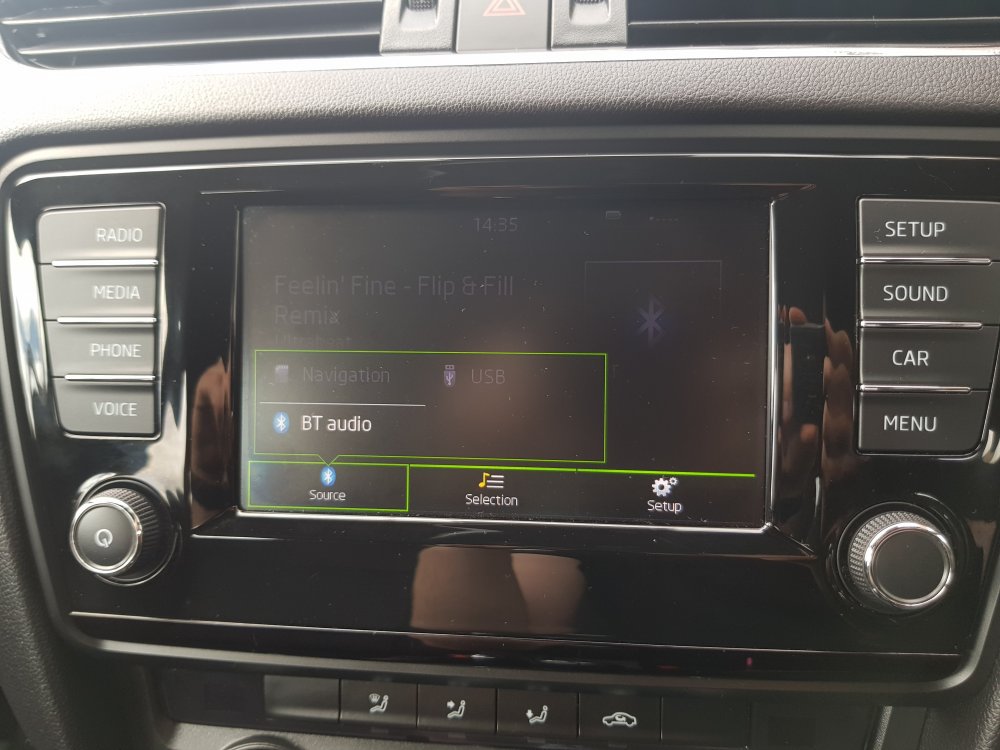

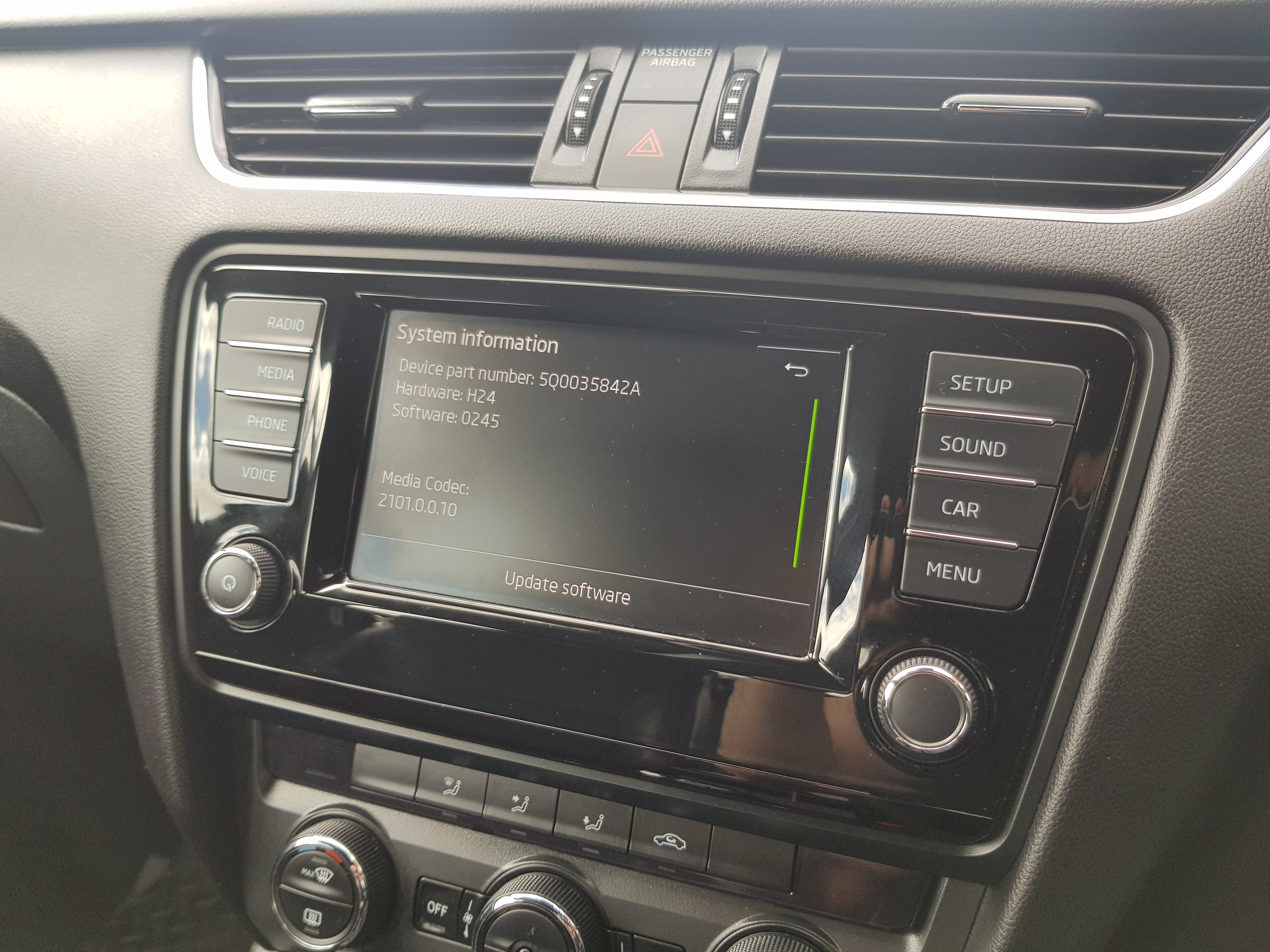

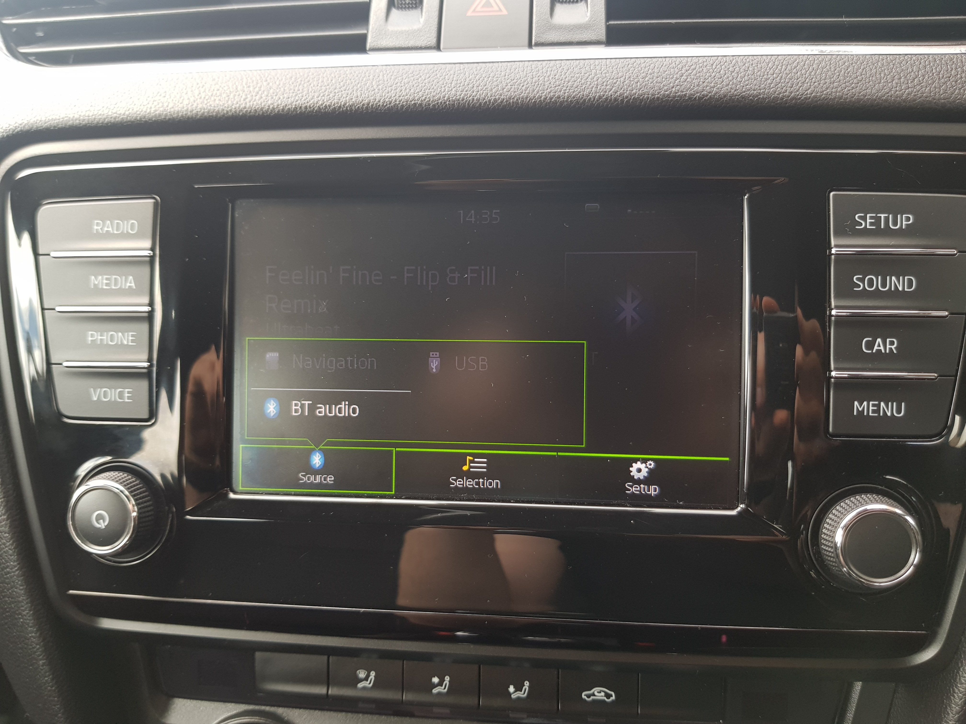

Ive just picked up a 2015 VRS TDI manual in black and i am struggling with the sat nav side of things. The dealer was adamant that the car came with sat nav even though it doesn't have a dedicated button on the infotainment system. I did get the full SD car with sat nav for 2015 with the car CW22/2015. I can see that it shows on the screen under media but it is Greyed out.
just to rule out corrupt software I've pulled the data off the card and reinstalled it. Ive seen that a couple of posts state that my car year/radio doesn't have the sat nav included. Ive also checked the update portal which shows no map updates for my the bolero system mine has.
Just wondering if anyone can point me in the right direction as to what i have to do.

I'm not 100% sure (more like 99%) but I don't think the Bolero has Nav, nor any of the GPS hardware required to allow Nav to function.

If it’s a Bolero it will not have nav absolutely no question. It needs to be an Amundsen or a Columbus. Unfortunately, it’s your responsibility as the customer to check the spec is as listed but you could always go back and try for some extras out of the dealer for mis listing the car as adding the nav is costly. Whether it’s a big deal to you in terms of that as an added extra is irrelevant, you may get something if you complain which makes up for it somewhat.

I don't think the Bolero from that era was capable of SATNAV.

*rechecked the sd card and it still shows it greyed out so guess I don't have it.

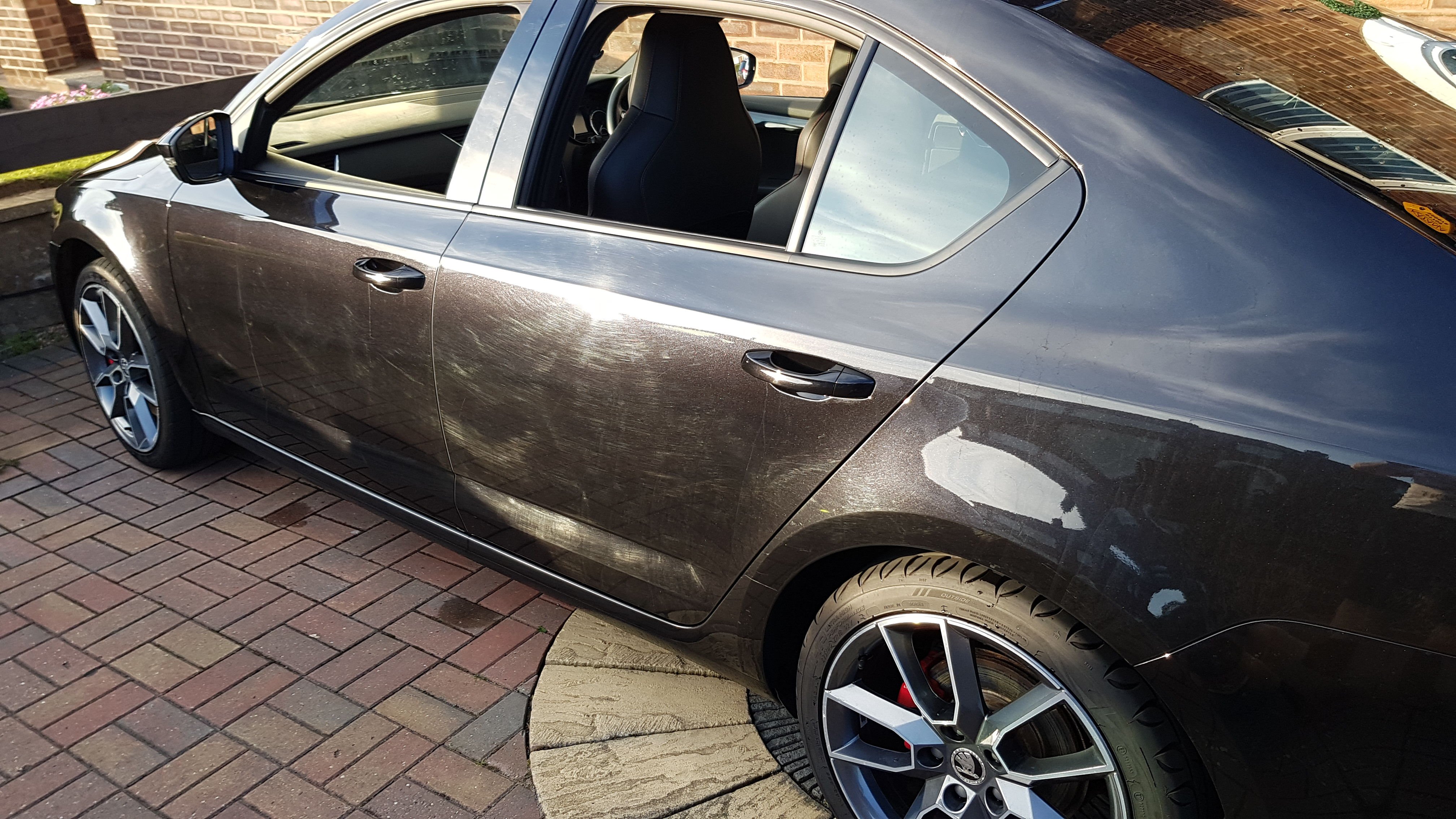

Also added pictures, and how bad the paint was on the car.
That’s a MIB2 Bolero, great news, it will have SmartLink for Android Auto/Apple CarPlay/MirrorLink which is better than the factory nav anyway. If that’s not been activated it’s £137 but if it’s not activated you can use the fact that the car was advertised with nav as leverage for a free/discounted activation :)
Not sure why it would have the nav tab at all because it shouldn’t, it doesn’t have the nav hardware.
Yeah, no sat nav on a Bolero unless the previous owner installed an aftermarket Kenwood system and didn't change the button. Keep the Media button pressed for a while and see if it does anything, if the Kenwood system is in the car then the sat nav should start, if it does nothing then definitely no sat nav.

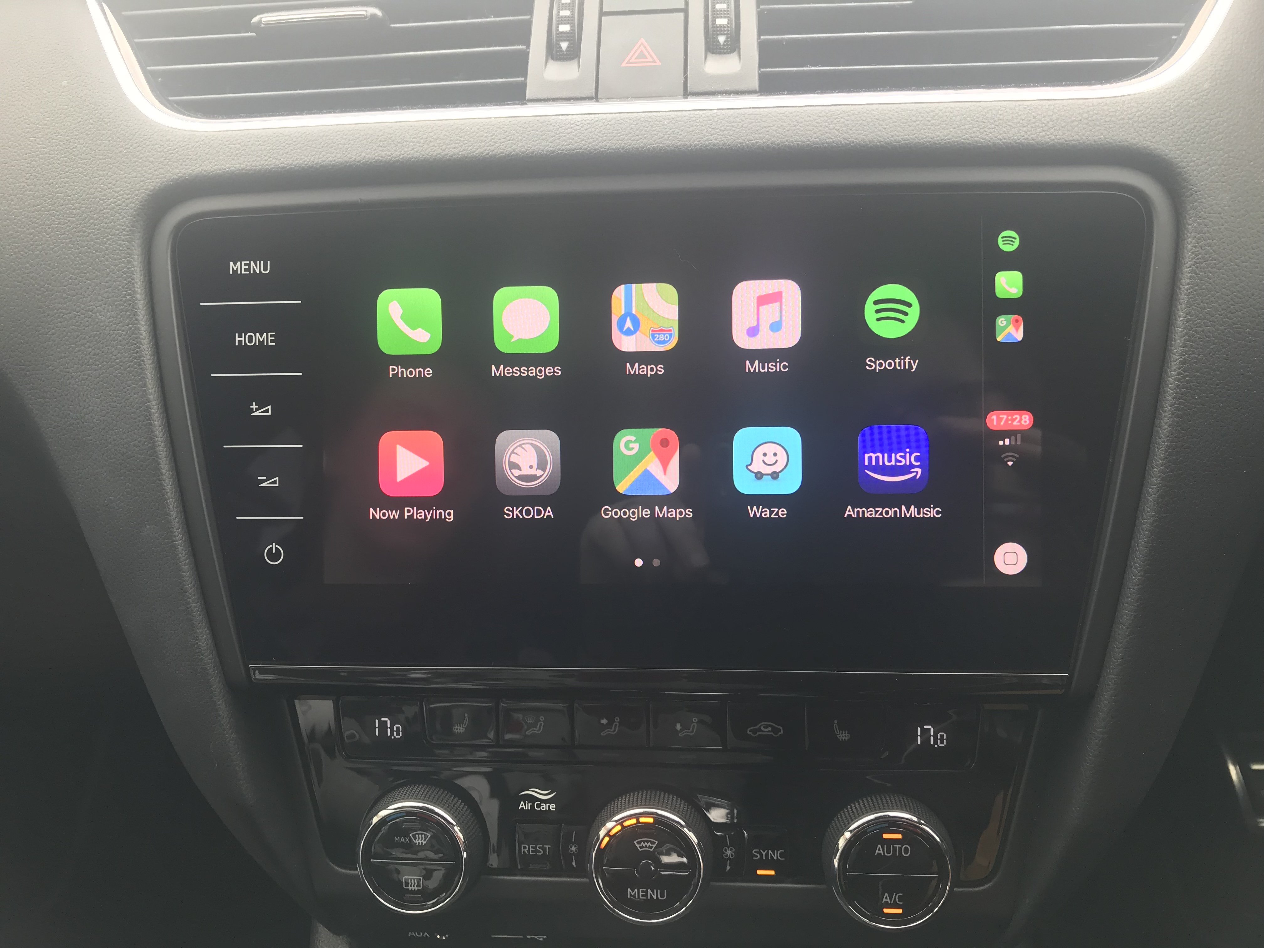

Smart link is in the options but states that it needs to be unlocked by a dealer. Guess this is the £137 activation that I've seen in your posts sasha ?
Yes it is. If the advert or the dealer told you that this car had sat nav and that was something that you feel you were misled on, go back and argue your case for free/discounted SmartLink activation. Then you can run your phones nav and music streaming through the radio and it’s worth every penny IMO.
Does it run it bit like live link to smart tv's ? so it will piggy back the phones GPS and hardware systems. Seems to be a good concept so will certainly be giving it a go.

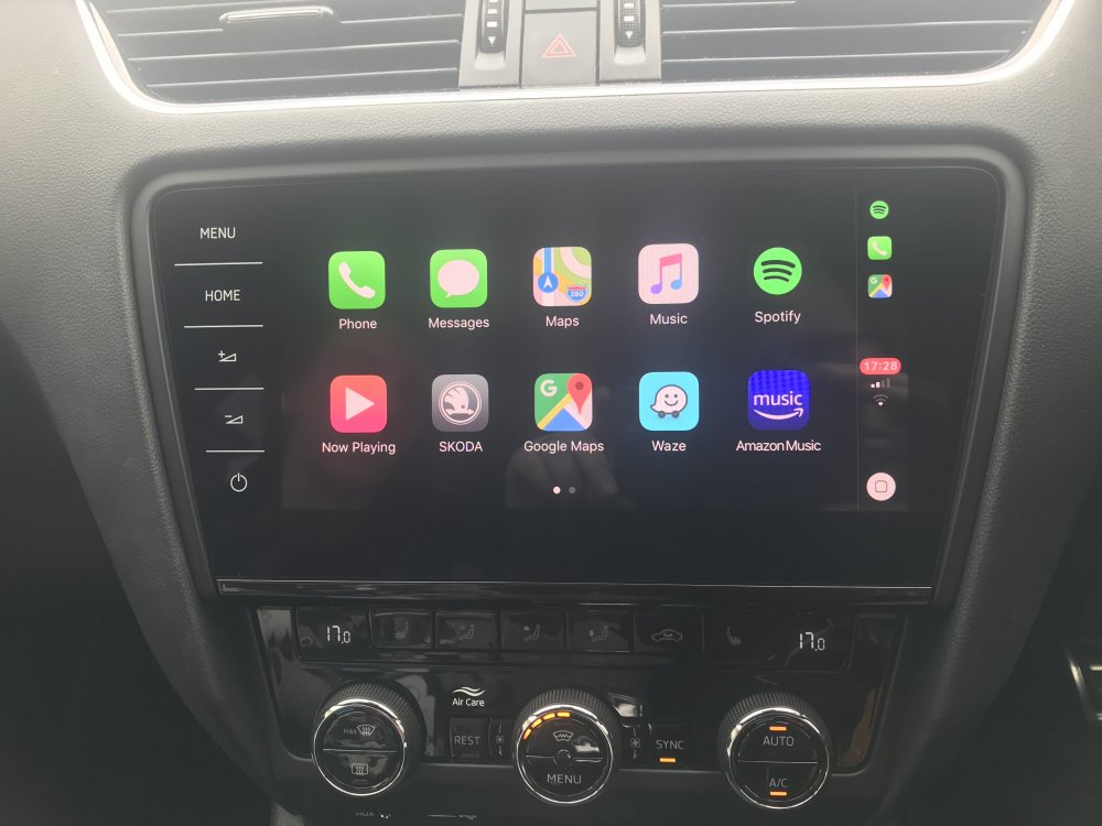

Yes via a wired connection. If you have an iPhone it’ll look like this. An Android phone will look different.

Looks like the paint's come up really well after that clean, 3 hours well spent. What products did you use?
Ive created this with the methods, polishes and waxes i used.
It's looking a lot more full of life than when i picked it up. Im hoping that the weather sorts itself out so i can do a full paint correction on it soon instead of just removing some of the swirls. However depending what happens today with the car dealers it may or may not be going back to them if they rant will to sort the wheels/Nav issue.
