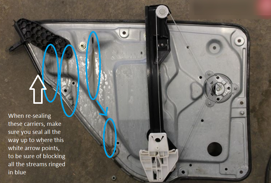

The fixes are easy and would have been applied to most MK1 Fabias ages ago. The door carriers behind the door cards just need sealing around the edges with sealant like Plumbers Gold, silicone, etc. You don't even have to remove the carriers, just the door cards. It's also worth poking a bit of wire or whatever into the drain holes in the bottom of the doors to make sure they're clear.

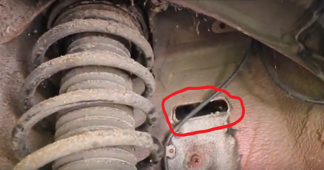

If it's also leaking at the scuttle it might be that the scuttle drain holes are blocked with leaves, etc, as it's quite common. You can access the drain holes by taking the plastic arch liners out.

Sealing tip for rear doors...
596ca92d74193-Mk1-Fabiareardoorcarrier.w
