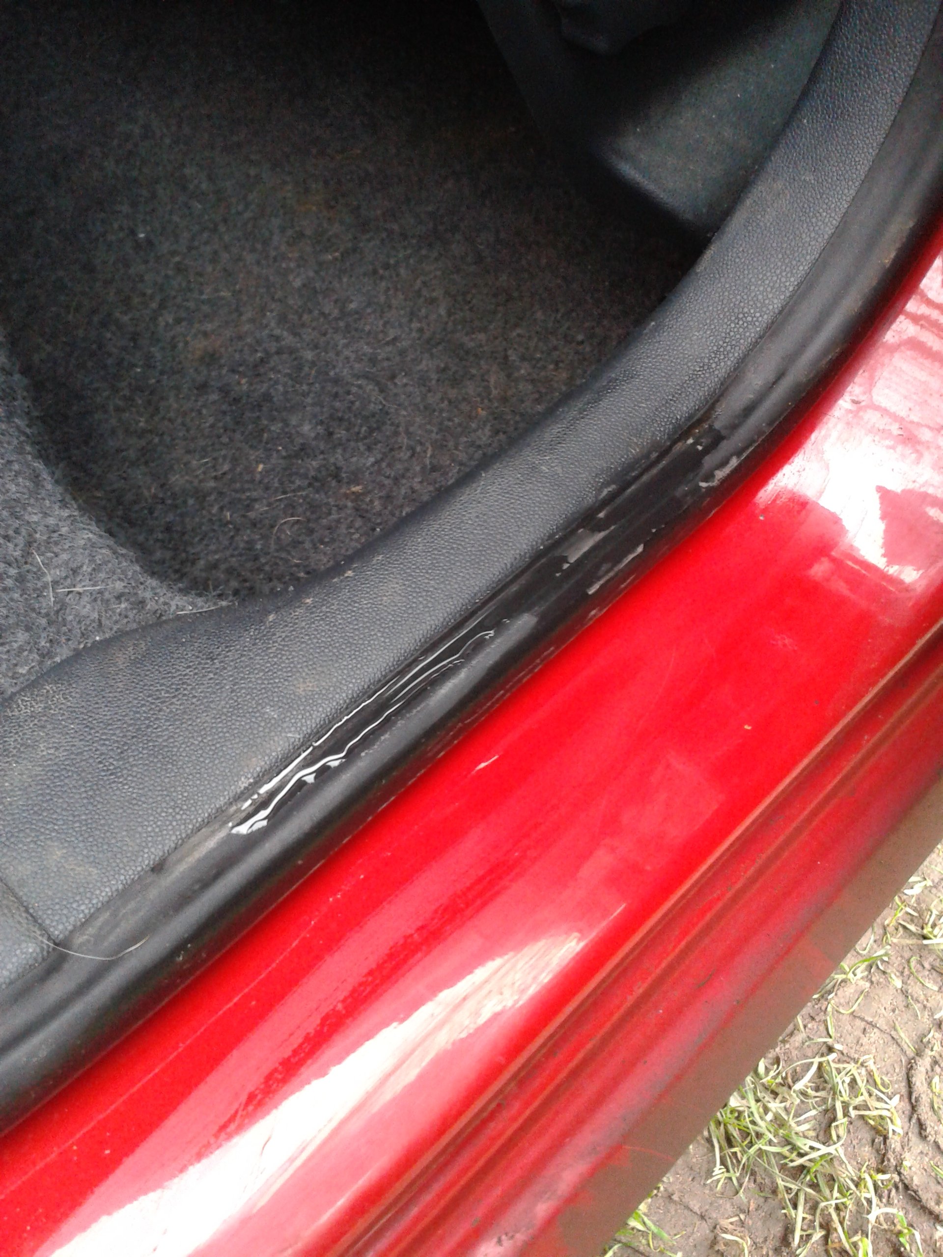

Keep an eye on the rubber seals at the bottom of the doorways as you open any door after rainfall.ย  Little tiny puddles on the horizontal bit of the seal = door carrier still leaking;
no puddles = happiness.

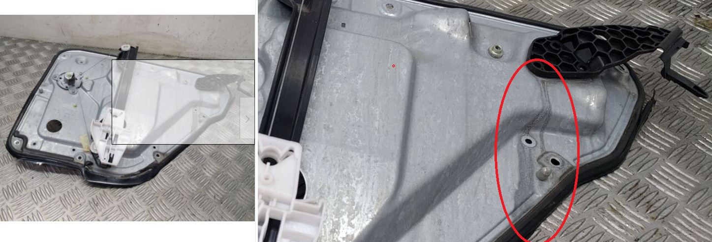

There is a crap piece of design involved especially on the back doors, but it's not the seals.
It's the brackets that allow the locks to come out with the assembly carriers (and back in). They actively divert water onto these carriers that would otherwise drip down the middle of the door harmlessly without challenging the carrier seal.ย  You will see watermarks like this on any carrier that is removed, much more so on the rear doors as the quarterlight helps channel it exactly onto the bracket.
ย
