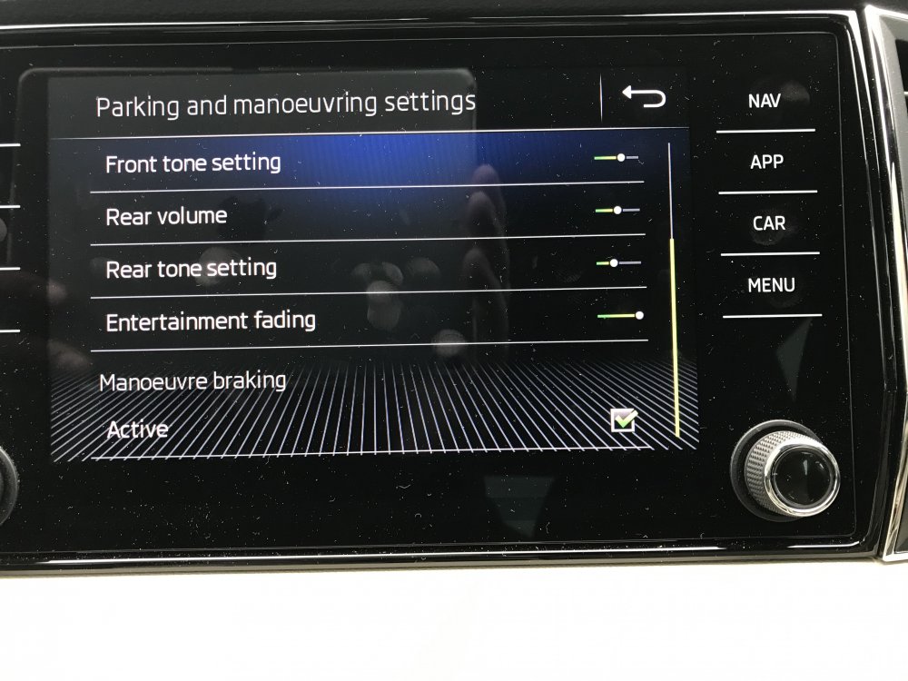

Yes, there’s a ‘tick’ to remove in the ‘Parking Settings’ on the media screen.
Manoeuvre Braking
2 hours ago, Berisford said:
Manoeuvre Braking

Hi guys. This was a Skoda dealership fitted towbar, fitted as part of the sale for half the normal cost. I’ve only had this vehicle for just over a month, and the first time out with a trailer came as a shock when the brakes slammed on when reversing. Didn’t have the problem with my previous two Octavias but they didn’t have the same auto braking system. I’m due to take the trailer out tomorrow, so I’ve already followed your method described to disable the auto braking, fingers crossed. Thanks everyone, I appreciate your help.

Used the tow bar last week and after taking your guidance re the manoeuvre braking, all was well with no reversing issues. Thanks everyone.
