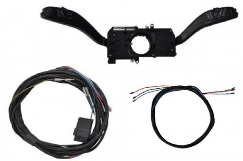

try this:
Edited by camelspyyder
you need to check what set up you have, there are different ones
Wire will be needed...
https://www.ebay.co.uk/itm/Cruise-Control-Gra-and-Mfa-Retrofitting-Installation-Kit-for-VW-Polo-6r/362366023404?fits=Model%3APolo|Plat_Gen%3A6R_&hash=item545eb2b6ec:g:sM8AAOSw4EJcm1aS
or
https://www.ebay.co.uk/itm/Cruise-Control-Gra-Installation-Kit-without-Mfa-for-VW-Polo-6r-up-to-Year/292337573116?fits=Model%3APolo&hash=item4410ad5cfc:g:xcoAAOSwqVVbMNQy
I bought just stalk from Aliexpress and wire set for Polo 6R. In my Toledo I had to add wire between steering wheel and central electrical module... and 1 to ECU in engine compartment.
This seller is from Germany... He added instruction in a pack and offer installation. So you can ask him question what do you need...

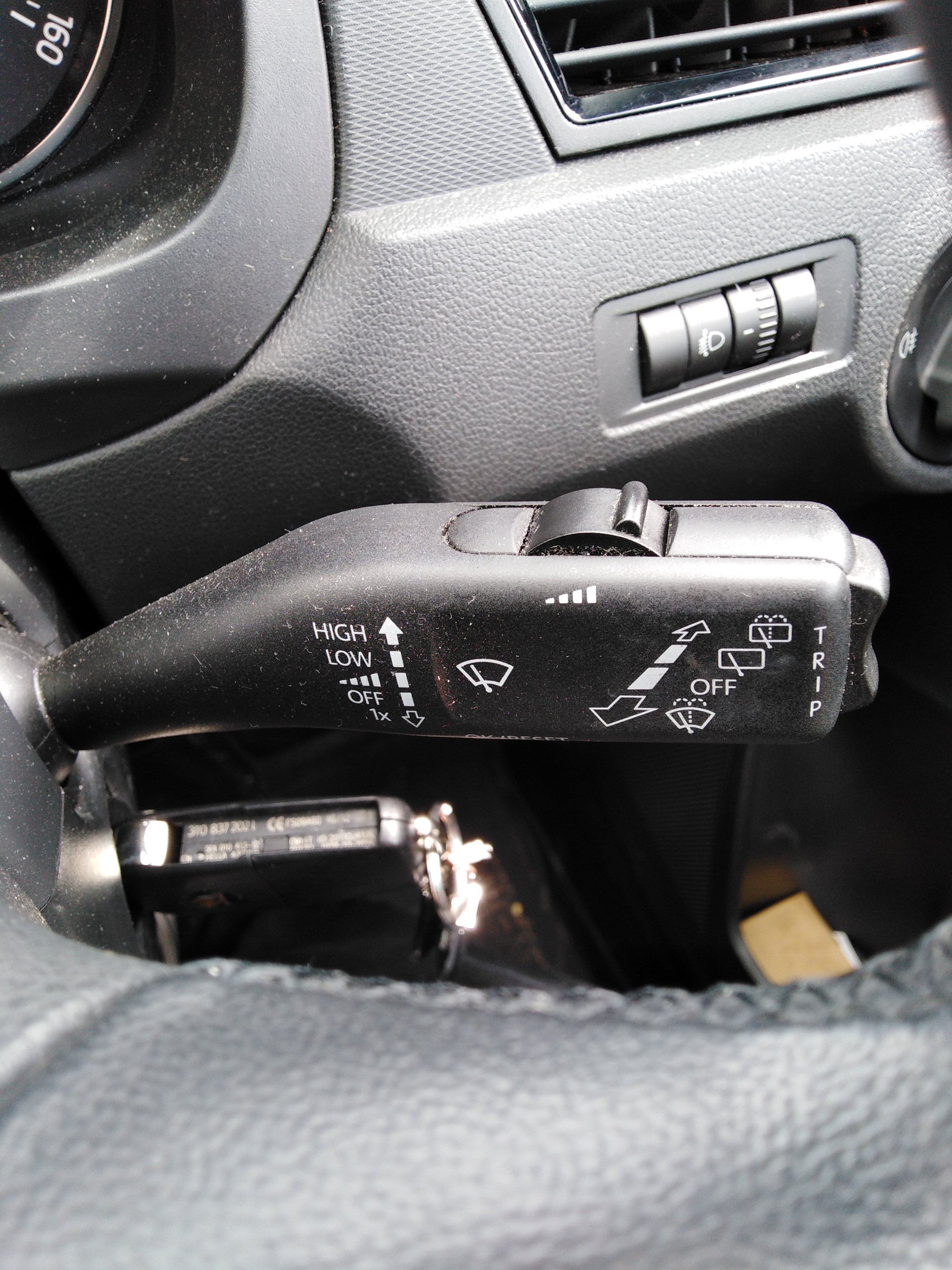

show me your current stalk, please...
Here is the picture attached.

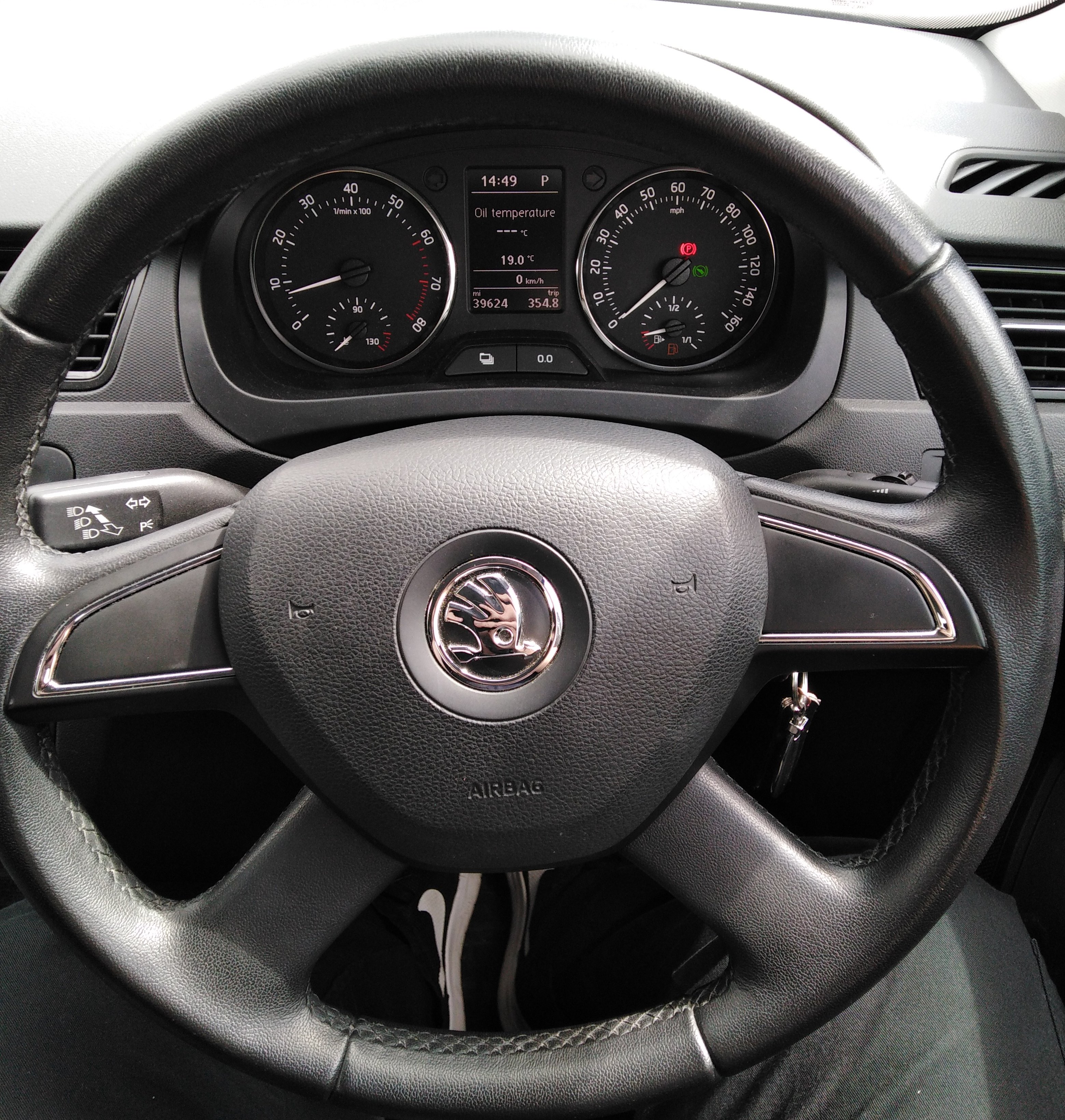

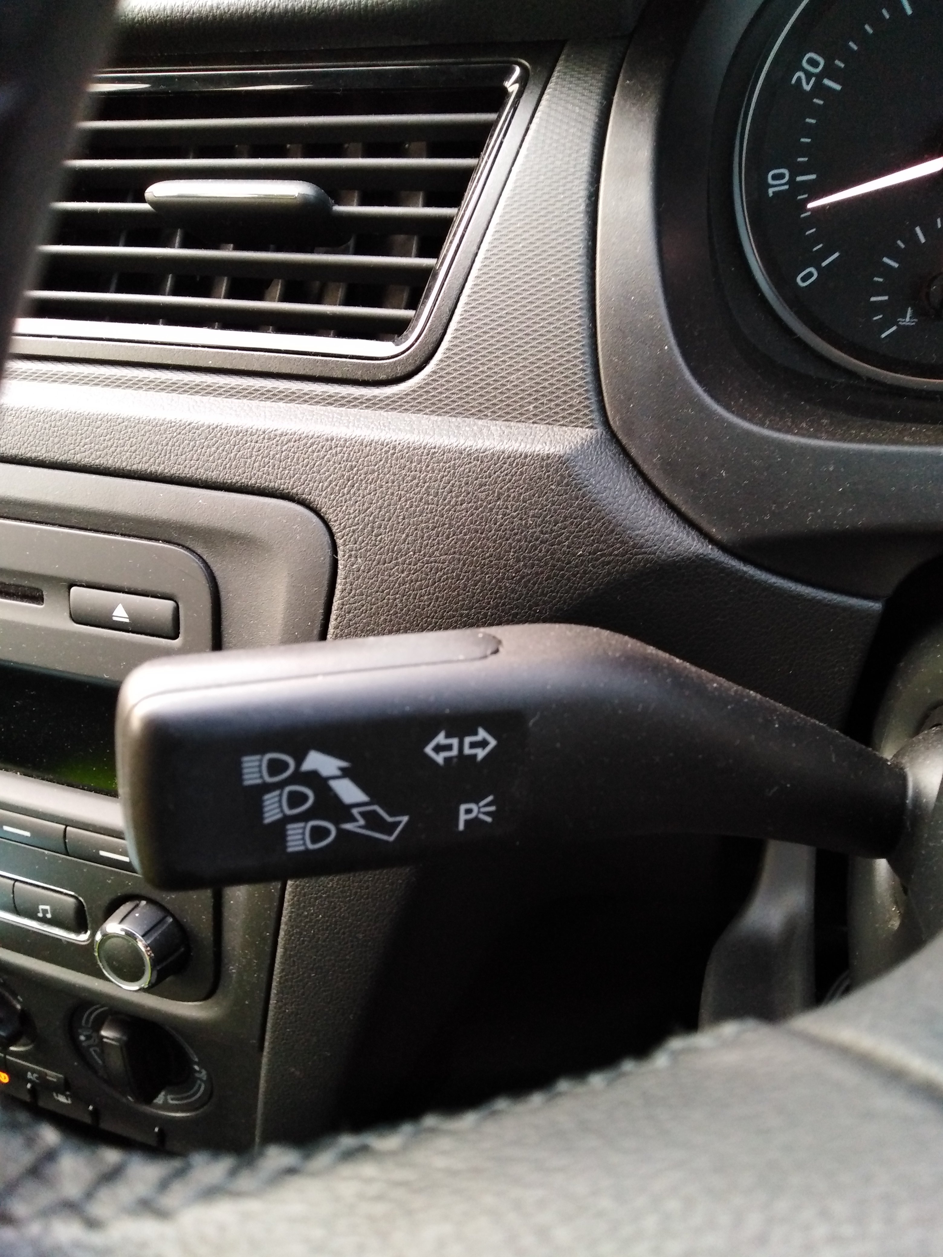

all, please... right hand side as well...
and steering wheel...
Edited by 67igor1
