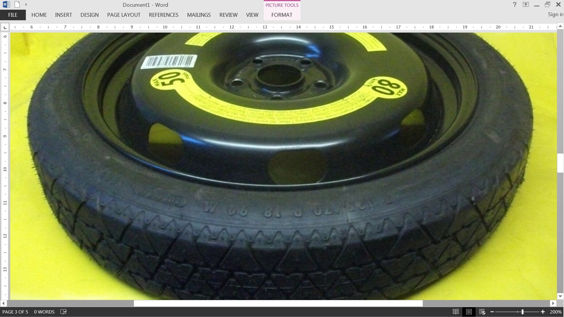

I’ve seen the following advertised (it’s a T125/70 R18 tyre) as a space saver.
Has anyone any views and does anyone know if the fit in the spare wheel well?

I’m going round in circles (no pun intended) with Space Saver tyre sizes.
One is advertised for the Superb with 18in wheels has a T125/70 R18 tyre. The outside diameter of tyre is 630mm
This is 5.5% less than the car’s 18in wheels with 235/45 18 W tyres.
Talking to a Space Saver manufacturer he says that this is OK but keep the journeys down. They do 17inch with a T125/90 R17 tyre and 18inch with aT125/70 R18 tyre. Both have tyre diameters of 632mm.
There is some good news. If this Space Saver could be used, it easily fits in the spare wheel well!!!
Any comments please would help.
Regards retiredbri
Space Saver wheel  and a wheel that saves space is very different, but both will be Emergency Wheels / Tyres and you will need to slow down.
If you need to use one you still need space to carry the full size wheel / tyre that came off the car if the boot is full, why not get a wheel / tyre to match the 4 on the car?
tread isn't too big, have you read first page and opened links?
opposite dealer says, diameter is problem
On 02/06/2019 at 09:43, MartiniB said:
-5.3% _ -6.7%, this huge size difference cancels usage of cruise control
about inches of disc, even 16 will be ok, size of tire is more important than size of disc

Try eBay for a 125/70/19 off am Audi A5. That’s much closer to the original size.
Thanks but I got the 18in version. I'm now adapting the expanded polystyrene in the spare wheel well to fit and still support  boot  floor in the Normal position,
Regards  retireredbri
Ahhhh yea I did that but the spare fits directly in the floor then you get a polystyrene insert with the tools in that fits in the wheel
