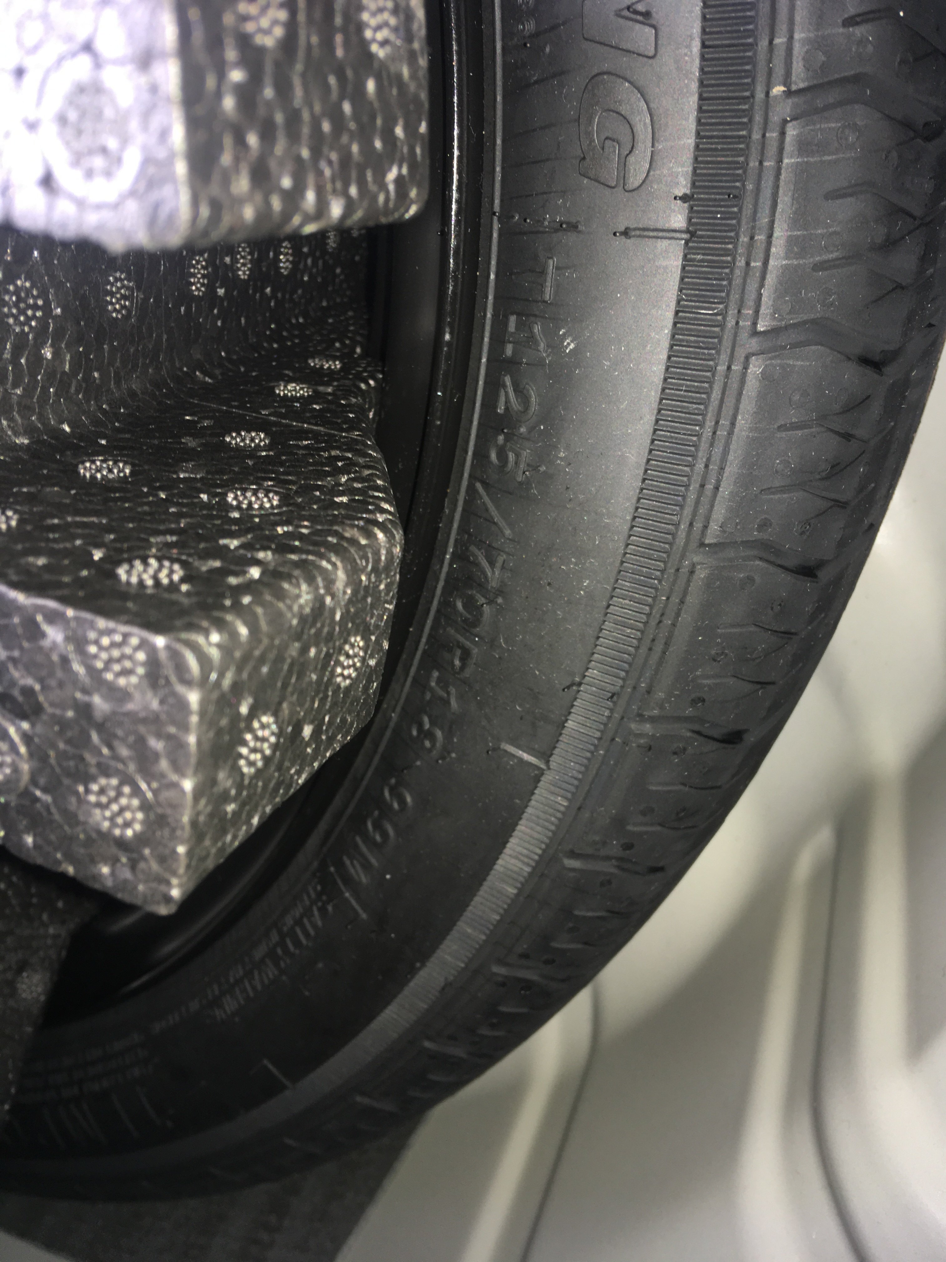

Just checked mine and it’s a 125/70 R18

I have a 2016 L & K and ordered a spare when I ordered the car (£100.00) and it is an 18inch get you home skinny tyre complete with Jack, wheel brace, wheel wedge and a locking key, plus a little gadget for removing the plastic wheel nut covers.

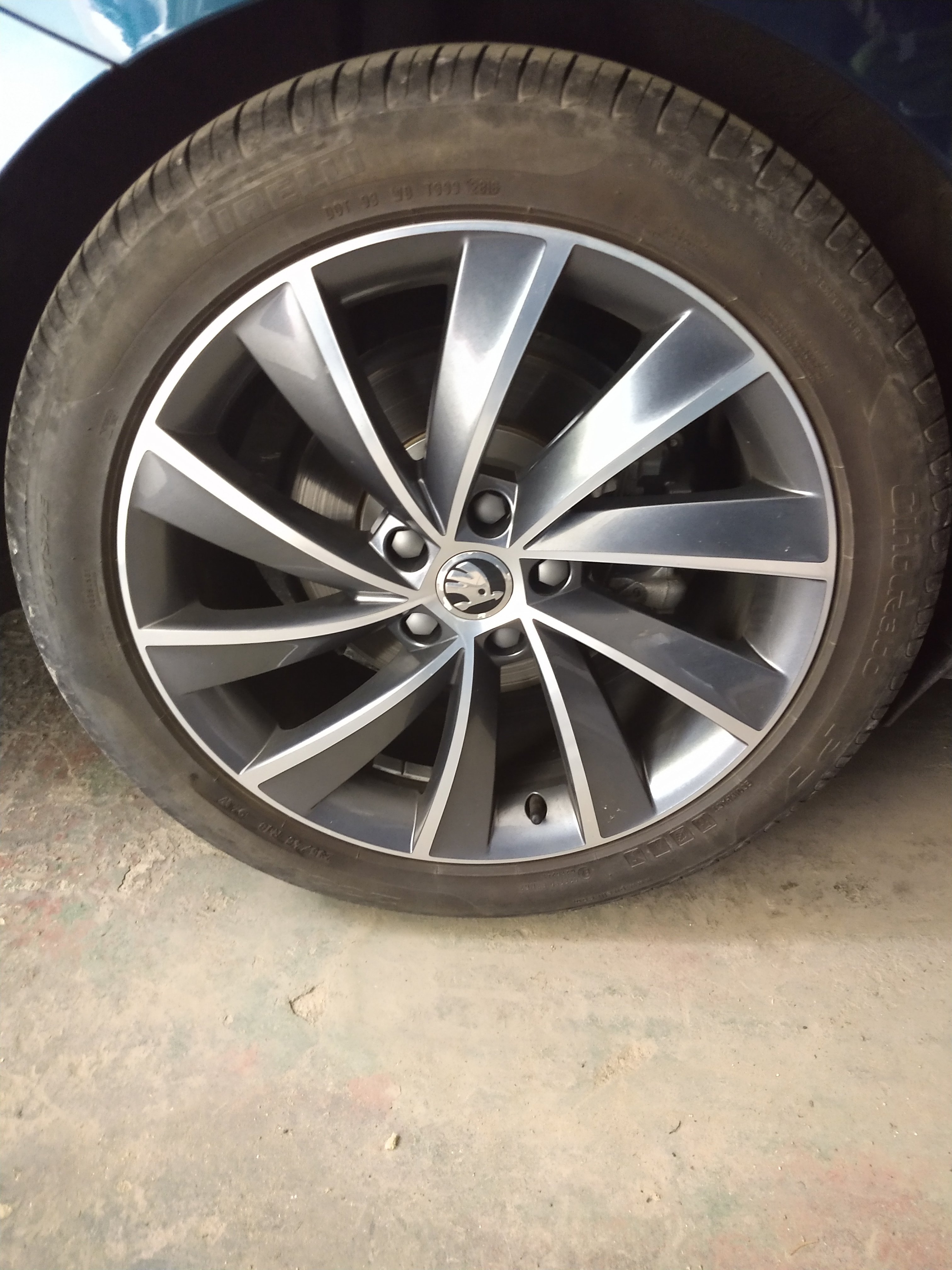

I must admit that while I was out watering some new grass I’ve laid yesterday evening I was looking at the brakes through the 18” alloys and there did appear to be far more than one inch clearance from the rim each side. Maybe I will get the new wheel out later and give it a test fit.

Actually, on the ŠKODA Superb 206TSI 4x4 it has the following Spare Tyre (18inch, not 17inch):
Continental T125/70R18 99M CST 17
