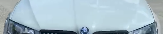

  • Panel gap between bonnet & wing on passenger side is too big. Looking under the bonnet the bolts holding the wing on have clearly been disturbed and bolted up in a different place.  Also the arch liner should be "tucked in" behind the edge of the wing but it's "tucked out" in one spot. It's definitely been taken off / adjusted for some reason. Weirdly it doesn't look like the wing has been painted to me.  If it has, it's a bloody good job - the orange peel matches the other wing which looks original, and there looks to be a similar amount of dirt on the back of the panel. The front bumper has had some kind of paint repair, but looks a tidy job. Front headlights are both date marked with the correct month / year which suggests to me they're original and there hasn't been heavy impact.

Gap difference pic.

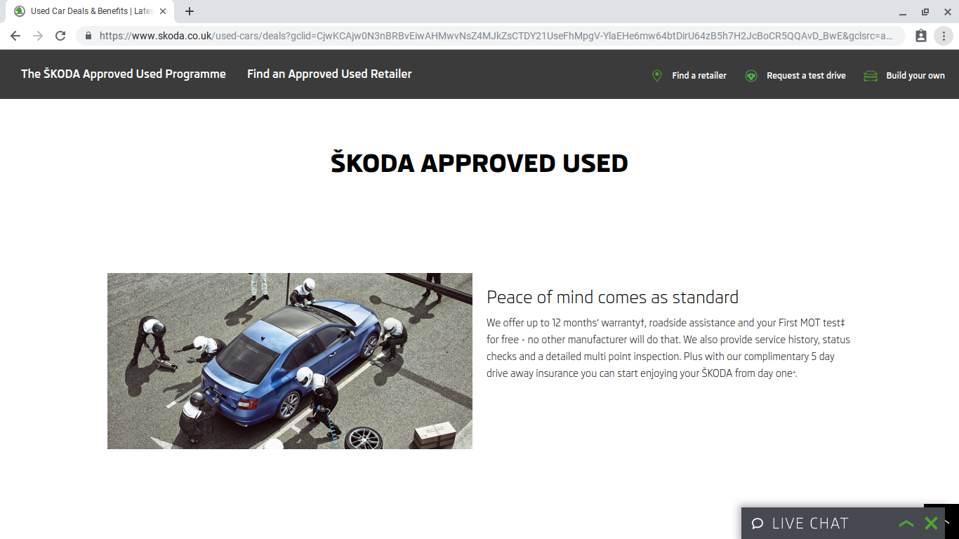

So much for them to do.
Like a VW Approved Bodyshop correct the panel gaps if their technicians can not be bothered.
Full Alignment check carried out.
Matching Tyres on axles.   & a bit of spending money and doing the checks that they say will be done as vehicles come from many sources.
Who was this Registered to an individual, VW Finance or AN Other?

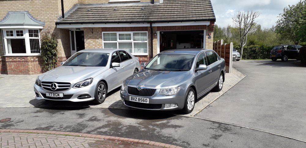

By the way, here is the old and new, the old Superb has a brand new bonnet on it, fixed under Skoda's 12 year anti-perforation warranty @ 8 years old / 170,000 miles. It was done at a franchised Skoda dealer bodyshop. One side of the bonnet now sits lower than the other, panel gap variations, missing plastic clips on the underside etc. etc.
Buy the best car you can find (this one) and perfect it yourself.

Interesting counter opinion. Fairly sure the wing is original as there's very clear marks on it where the bolts used to fasten.  If it was a fresh wing then surely those wouldn't be there.

The Wing can be off another vehicle of the same colour.
