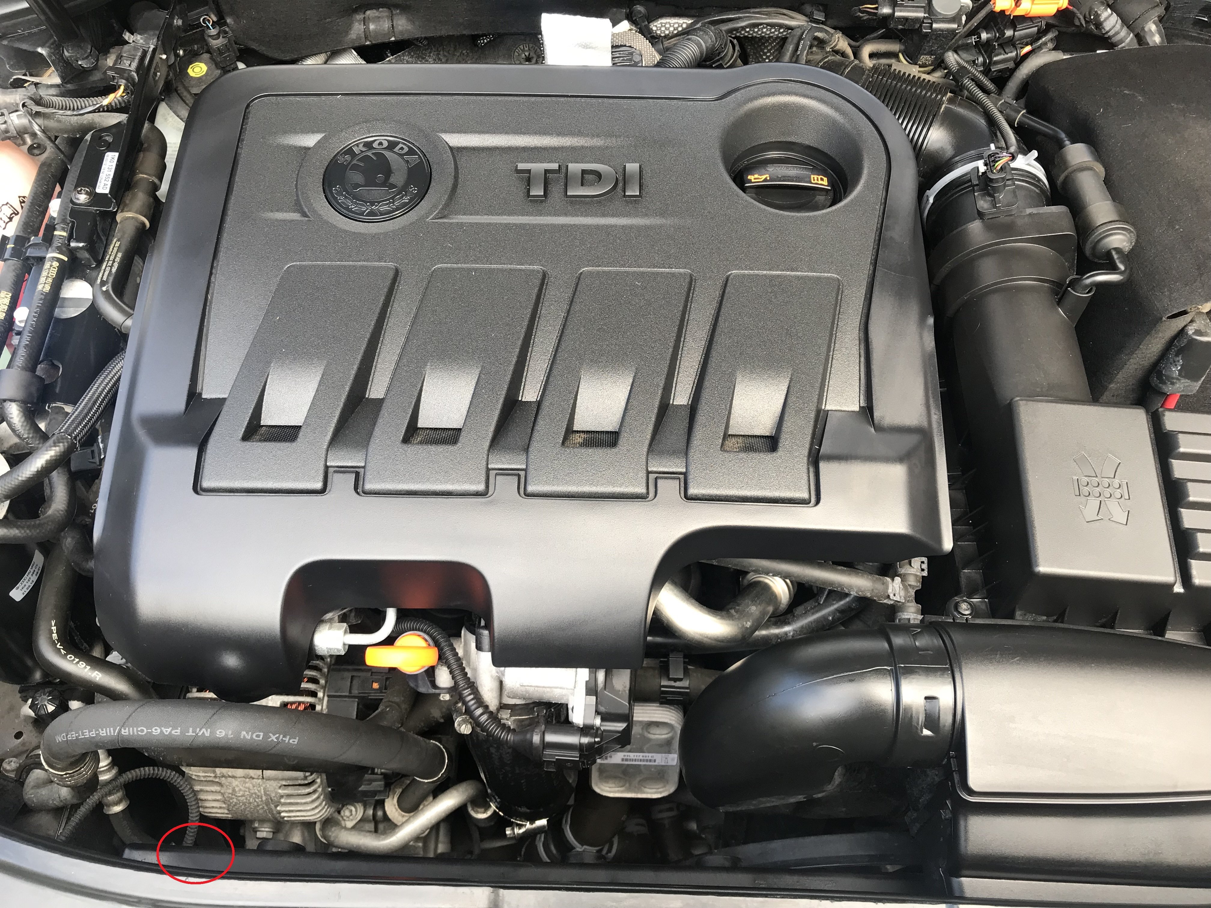

The high pressure sensor G65 will be screwed into the high pressure pipe (thinner one) on the left side front of the engine as you look down, Follow the thinner pipe from the compressor and it will be screwed into that line.
Where the red circle is, looks like the loom goes to the sensor there.

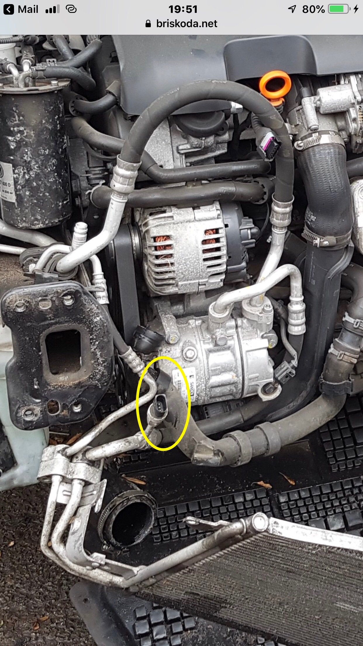

Had a look, think this is it:
If so, think I can get to it from the top especially if I remove the lock carrier.  Will save a few £££s if U decide to change it.

Ah, its gonna be a bit tighter with that engine shoehorned in there. Try removing the wheel arch liner first.  It unscrews, has a Shrader type valve so you won't loose your gas.

Access isn't quite as bad as it looks but going in through the wheel arch might be the best idea.

Recent post shows exactly where it is 👍
