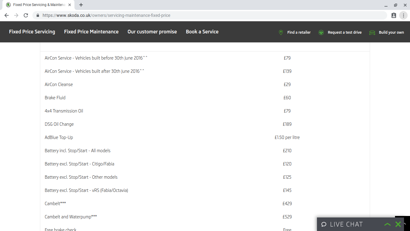

Unlikely Haldex is included, that is another £79, and be sure that is the filter done not just oil change.
Then there is the brake fluid change, extra cost.

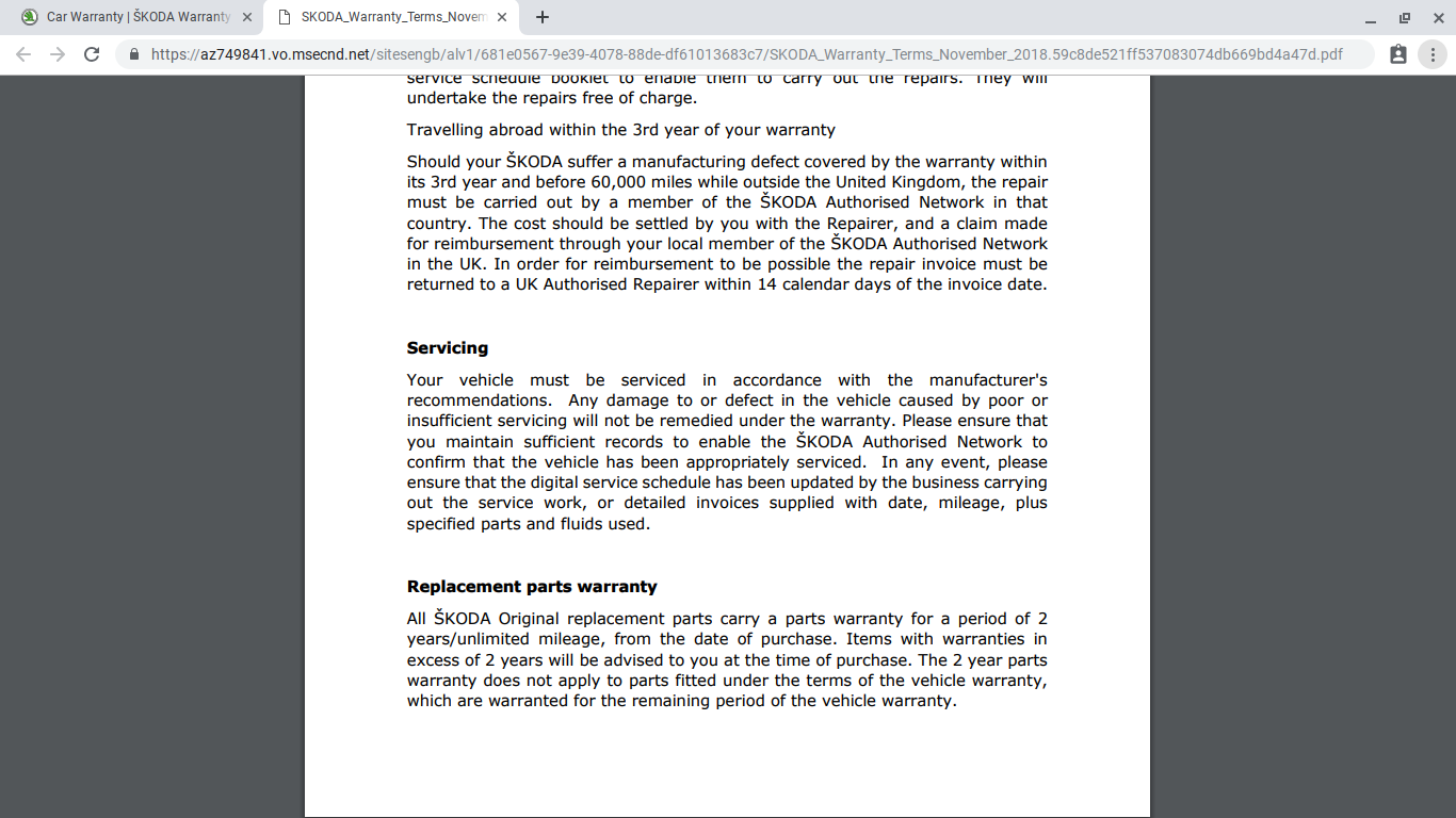

You do not void your warranty at a VAT Registered establishment / person using the correct OEM fluids and parts.
Plenty Independent Specialists with the gear and an idea.  Trained Techs that no longer would work in the Dealership Network...

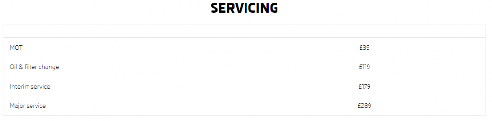

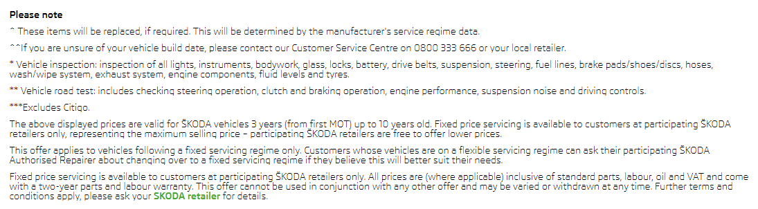

The £189 is the older price a lot of dealers charged for the 'interim service', which is the oil, oil filter and pollen filter. Seems your dealer is a little out of touch, or trying their luck.
The reason the car is asking for a service is because it's set to the 'fixed' interval... 12 months or 9,300 miles (15,000km), whichever is reached first.
Your annual mileage appears to be just over 12,000 miles. This puts you on the border for either fixed or variable (up to 24 months or 20,000 miles, the car decides for itself).
Personally I prefer fresh oil once a year, it's the life blood of any engine and turbo and a key contributor towards longer term reliability, so I'd stick to fixed.
How old is the car? If it's 3 years or older then your eligible for Skoda UK's fixed price servicing @ £119...

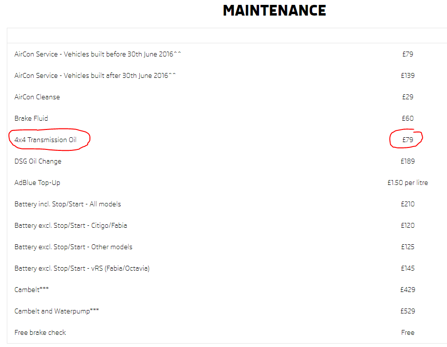

I'm not aware of any additional costs associated with vehicles equipped with 4x4, other than the required Haldex oil changes.
Note, the Haldex oil change is specifically called out under 'Maintenance', not 'Service', which makes your dealers argument for the 4x4 system affecting the fixed price servicing nonsensical...
It also isn't specifically called out in the T&C's, although note the last sentence "Further terms and conditions apply"...
We're talking an engine oil service here, which we all know is 5 litres of oil, an oil filter, sump plug and 30 minutes of labour.
If your dealer won't do it for £119, find one that will.

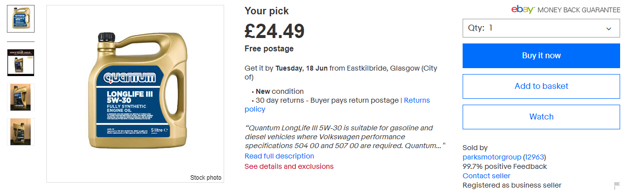

Given that the oil can be bought online in 5 litre tubs, delivered to your door for a little under £25 (as linked above), I'd imagine a 20 litre cube, or bulk drum will be even less.
£20's worth of oil on a £70 oil and filter service at an independent sounds about right, especially when a franchised Skoda dealer can do it for £99 (recently increased to £119).
Good point, however not everyone will want to buy their oil from e-bay (amid rumours of non genuine product sold cheaply, old stock and what not).
A couple of other examples for balance (carparts4less, pre discount code) attached.
Also a common misconception that all franchised dealers use Quantum oil, they all can sell it over the counter for sure, but that doesn't mean that's what they use in the workshop.
Even if you round up the oil to £30 as an average, £5 for a filter that's not a lot for labour let alone disposal costs and overheads, it's a good deal for sure.
