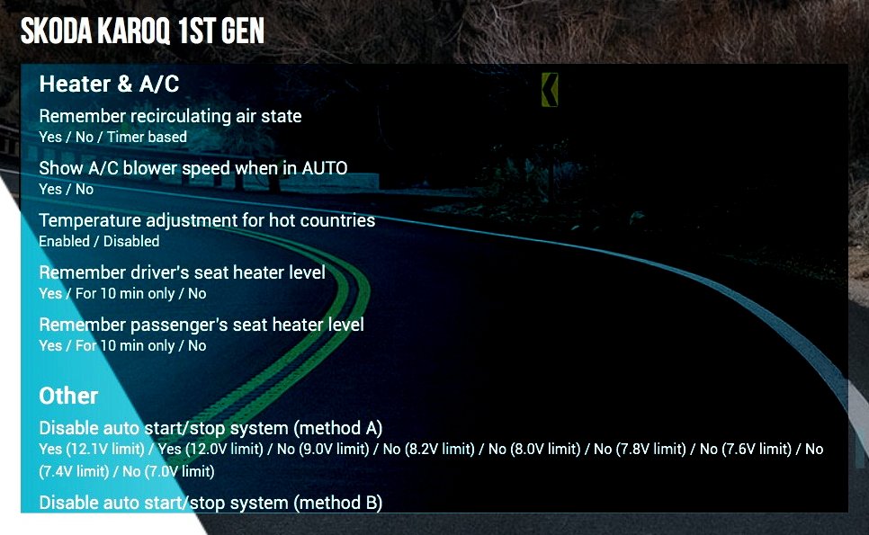

    UPDATE - Amazon delivered Carista today and on my 2018 Karoq Edition in a matter of a few minutes I had activated the gauge needle sweeps, audible beeps on locking/unlocking, increased the coldness of

Thanks, but even on the lowest setting the aircon is not as cold as the Fabia. Carista's webpage does indicate that a setting can be changed ("for hot countries") so I just wondered if any Karoq owners have done this and can actually feel a difference.

UPDATE - Amazon delivered Carista today and on my 2018 Karoq Edition in a matter of a few minutes I had activated the gauge needle sweeps, audible beeps on locking/unlocking, increased the coldness of the air conditioning (from 8.3º to 6.3º), and deactivated the auto start/stop system. There is nothing technical to learn or decode as everything is in a simple ON/OFF one-line description so if you want to return anything to the factory default you simply reverse the setting you changed. I 'm using the free one month trial that comes with the product. So far, so good!

After changing the setting with Carista I did notice my A/C feeling a bit cooler yesterday so it has made a difference but if I could make it go even colder I would. Next week will be the acid test when the weather is supposed to be getting hot around 32 degrees.
