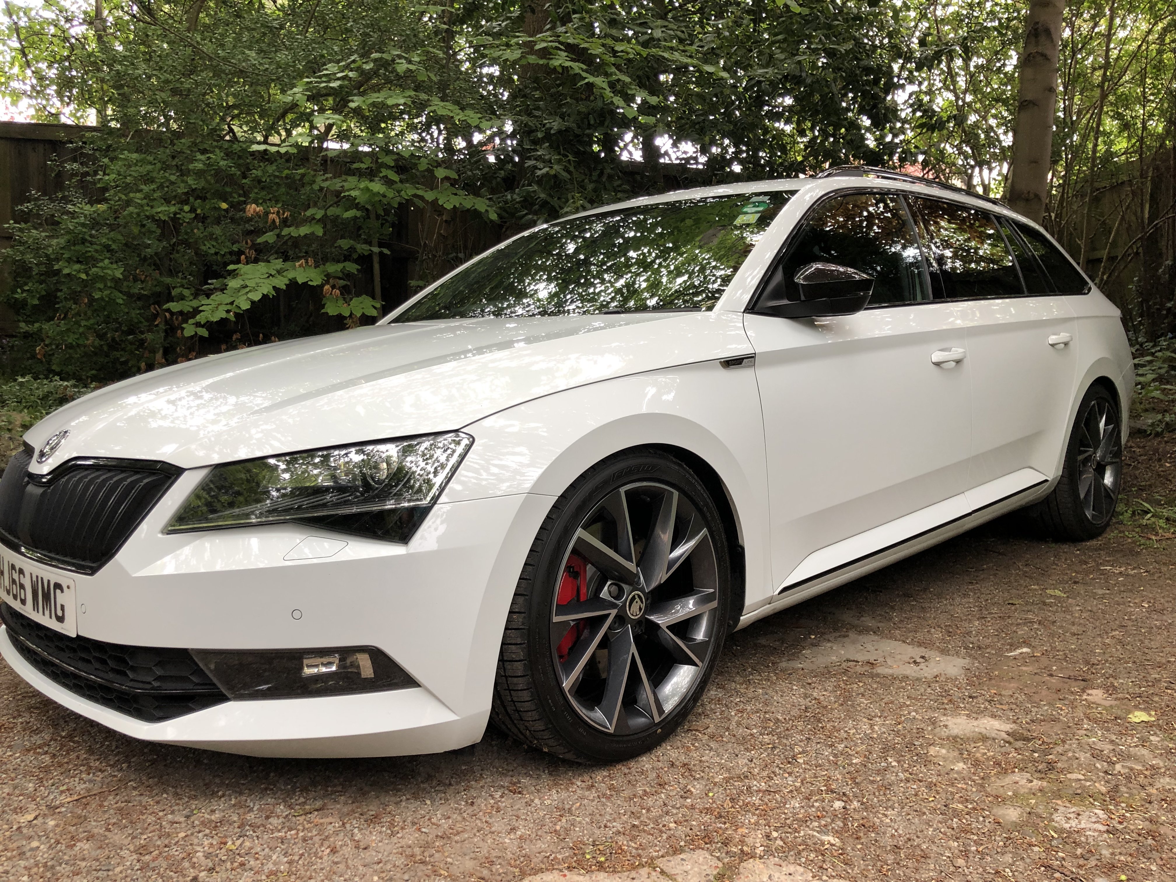

They’ll be fine. There are a couple of us that have used H&R myself and markbro on here. Check out the thread and there are pics of my sportline lowered and marks non sportline
my rear tyres on the estate don’t sit in the arch even lowered and the fronts are just peaking inside

As you might remember from the other thread, I am with the OP on this one. Imo, there is a unfilled "gap" (pun intended) between the stock arch gap and the H&R drop. Right in-between the two would be my ideal setup for a car that looks more purposeful than stock but does not shout lowered. This is verified easily against other sportier sedans/combis that from factory sit lower than a stock Sportline but not as low as an H&R car. There seems to not be a solution currently for whoever is after a mild drop (which is why I've left it stock as it's not too bad either).
