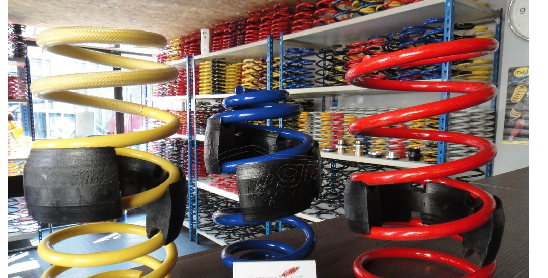

There are milder options. Eiback Pro kit and H&R both do 30-35mm which is still usable but for my like (visually) is a tad too low. But since no other springs exist that would lower it even less than 35mm, I contacted a suspension specialist and they suggested what they call spring buffers. Essentially it's a piece of hardened PVC, with the necessary profile to fit in between two coils and prevent the relative movement between them when the spring is initially compressed, so the spring doesn't drop as much as it would and the car ends up sitting 10-15mm higher (on average). However, it's not a rock solid part so it still absorbs part of the forces (and also allows the spring to extend when needed) and is thus considered much better than say milling the spring itself, which I would never consider any way. They said they fit them on several cars where they permanently need to carry lots of weight in the boot (dog houses, heavy speakers/woofers etc) or when customers don't want the full aftermarket spring drop and that they don't affect the ride or need any maintenance.
I was completely unaware of them so I am thinking of giving them a try to be honest. Worst case you can easily remove them, they install just by lifting the car up on a ramp I think.
Edited by newbie69
I think Skoda call them transport blocks and often leave them in for customers :biggrin::biggrin::biggrin::biggrin:
Nice find. Although, worst case is - overworking the remaining coils and fractures close to the blocks ;)
Unlikely, but you are now operating the spring in a way it was not designed, with all the unintended consequences ...
Or, you could go for upgraded adjustable shocks and tailor the compression and rebound to perfection :)

Yeah I won't say that I knew of or had tried this solution before really, I had to speak with them on the phone to be convinced it can actually work. From what they told me, when this buffer is placed correctly (in the middle of the spring - not at the ends) you don't get any adverse effects from its installation. If it was some random product I found on ebay I would be too skeptical over such claims but the fact they are an actual suspension shop and they install this solution to customers that need slight raising of their cars gives me some confidence. I'll report back if I go ahead with it.
