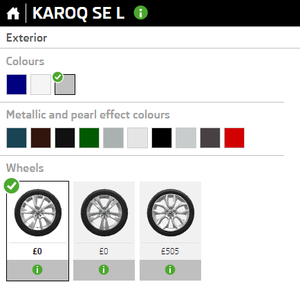

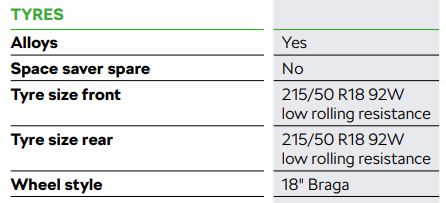

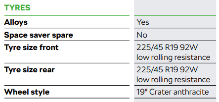

Which wheels have you got fitted?
The 18" Braga, Mytikas, or the 19" Crater?
Thank you everyone who have replied. I have checked my tyre pressures several times over the last three months. They were set at 2.3 bar when I collected the car but I reduced them to 2.1 bar the next day in line with info on the petrol flap. My tyres are Bridgestone 215/50 R18 on the Braga wheels.
