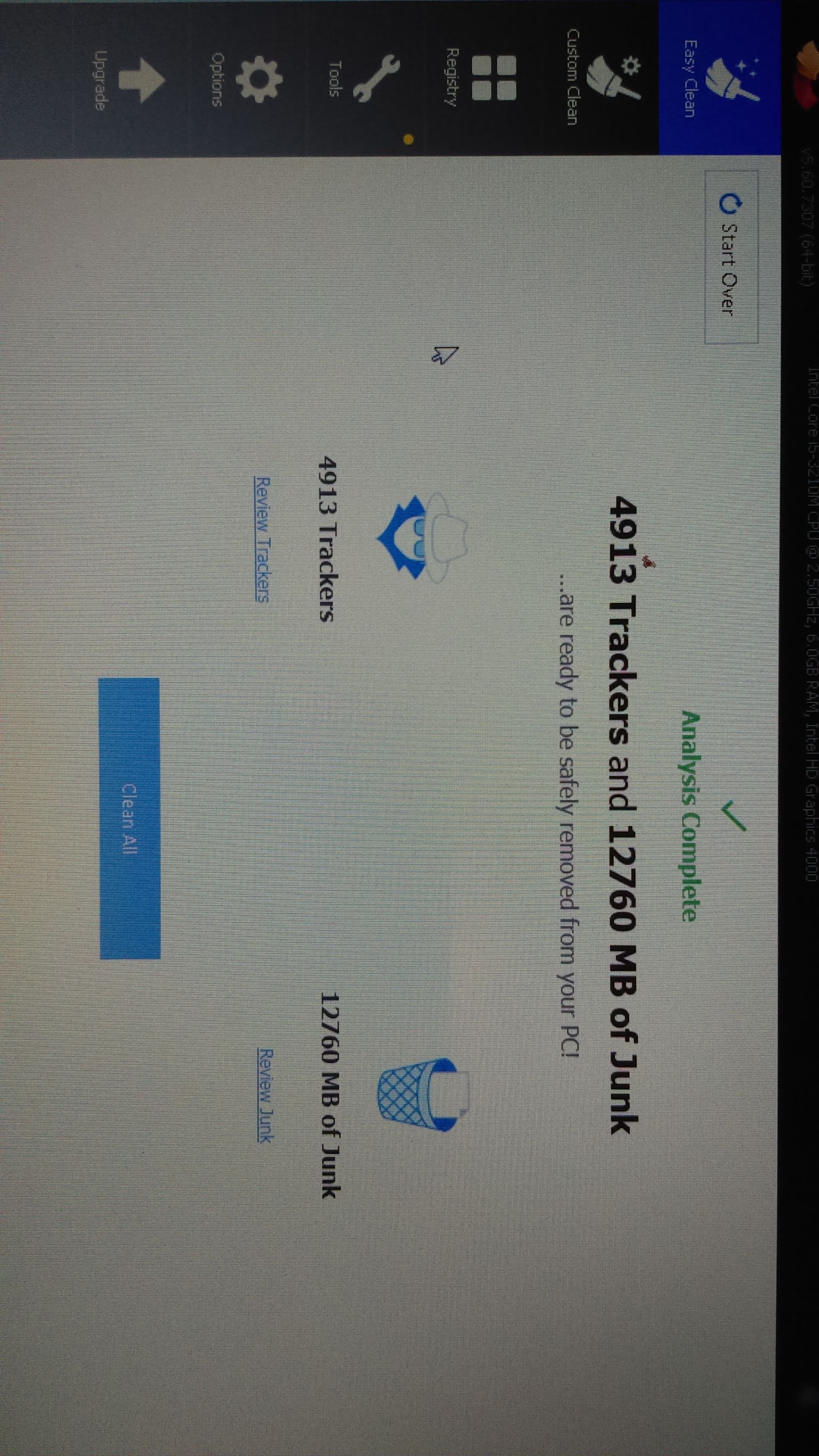

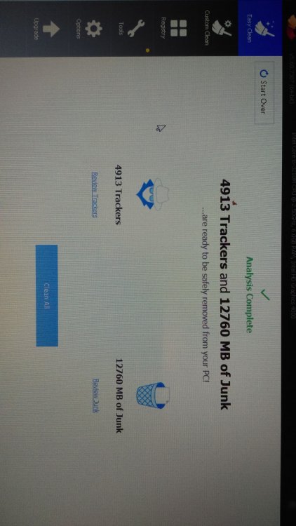

Just remember a little maintenance aleays helps a bit too... ive neglected the "household" laptop since i was given a work one a couple of yrs ago...
Just ran ccleaner for the first time in 2yrs..
Everyones watching!
Cant wait to see what the registry clean finds!!
Edit
Only 112 reg issues. Thought it would be alot worse
Edited by mac11irl
