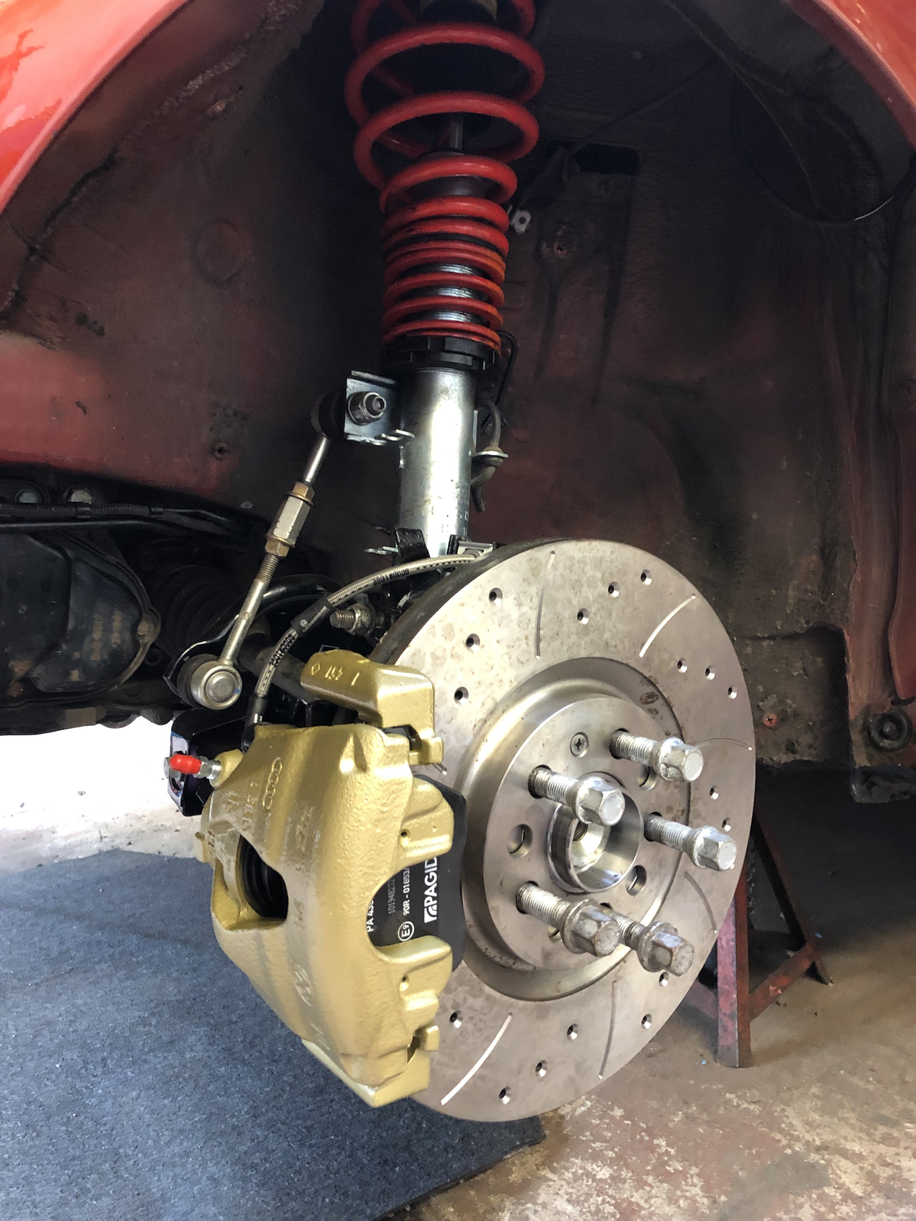

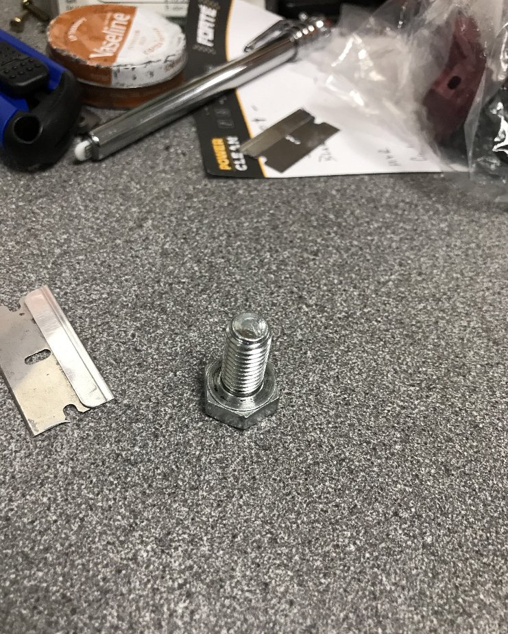

How about this, new caliper fitted on this Bora by the customer. Couldn’t bleed it out. No fluid coming at the n/s/f at all. Queue firing up the parts cannon changing ABS module, master cylinder, servo etc.
Then as a last ditch effort took off the caliper. Something odd about the banjo bolt
^ Haha! A plain bolt 🤣
