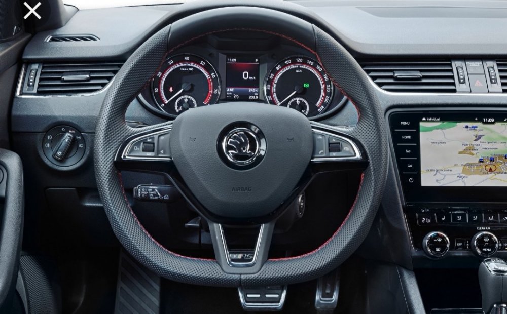

I want to change the steering wheel of my skoda octavia 5e3 2014 ambition with 4 spokes to the new multifunction steering wheel RS flat. But i have some questions about it, anyone knows if my airbag fits one this new flat steering wheel?

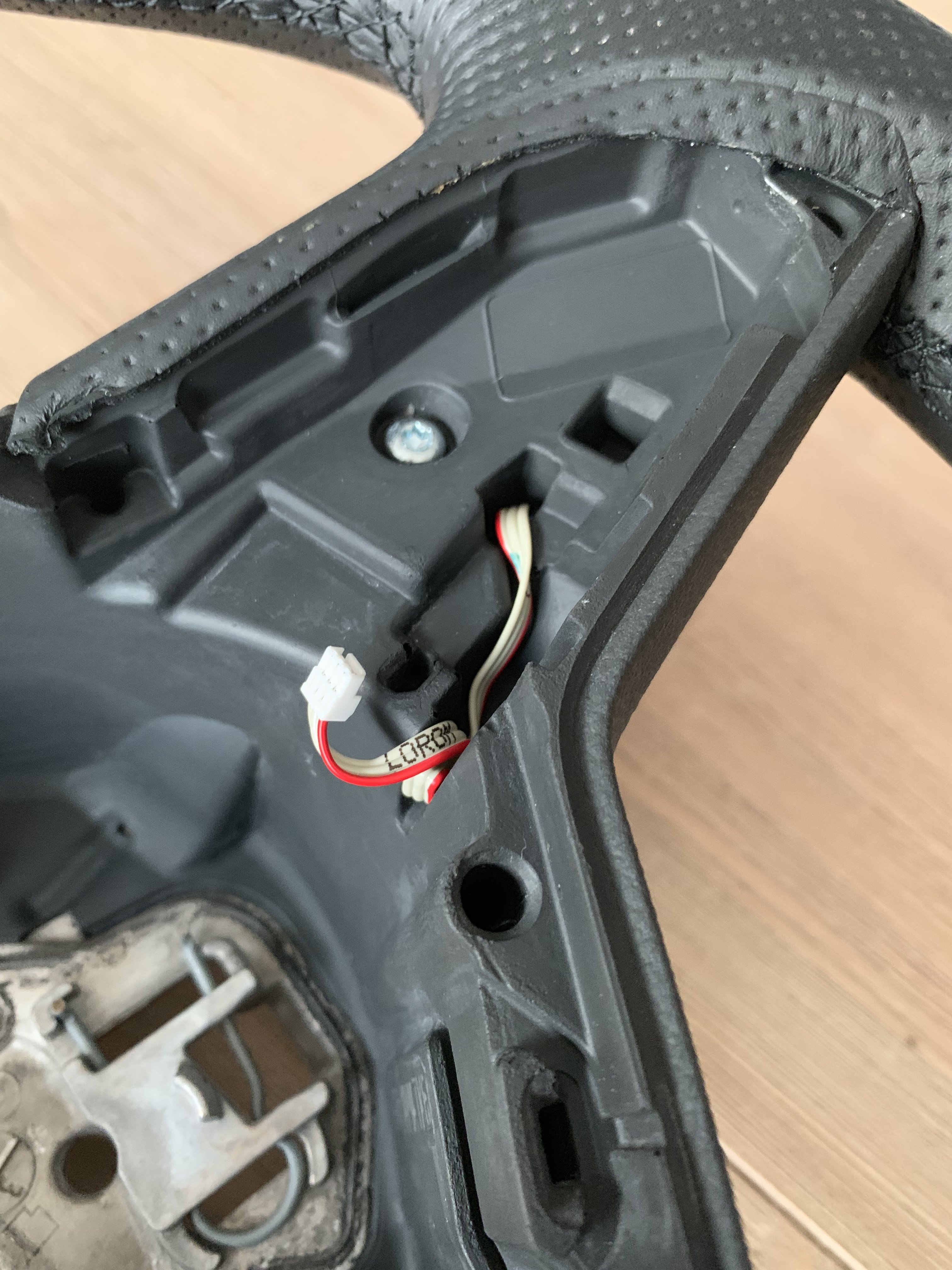

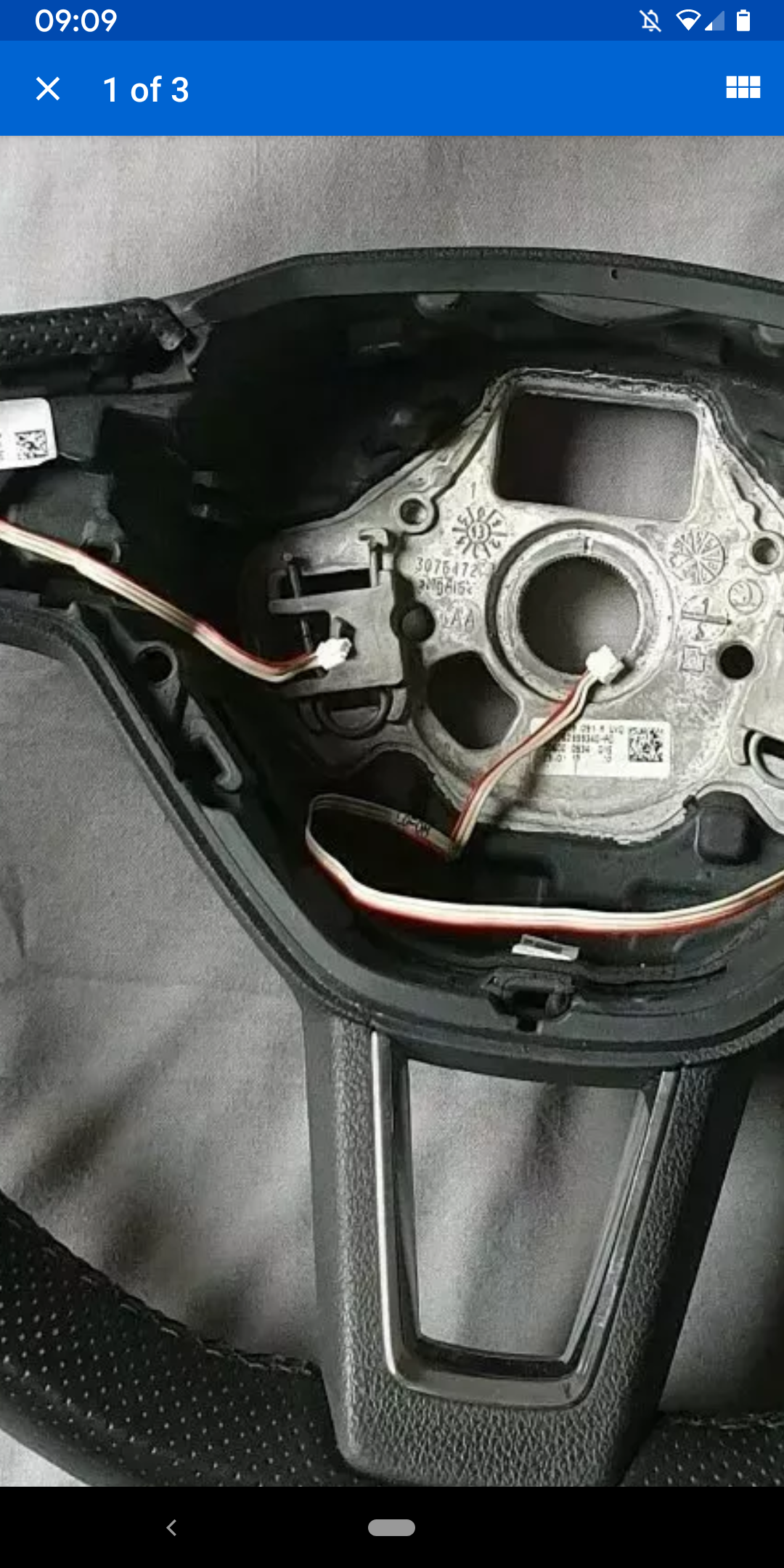

However, the little plugs for the dsg paddles have no home. It looks like they should fit into a plug in the back of the left button pack by the way the cables lie. I was under the impression it would all have the required bits.
@JohnnyType2 is this something you know about and/or have the bits for? It's all back together now. I'll see if I can get the photos off the eBay add.
Edit: the left cable has a link half way down so it can fold back on itself and the longer right cable (once properly in the guides) ends in a similar place.

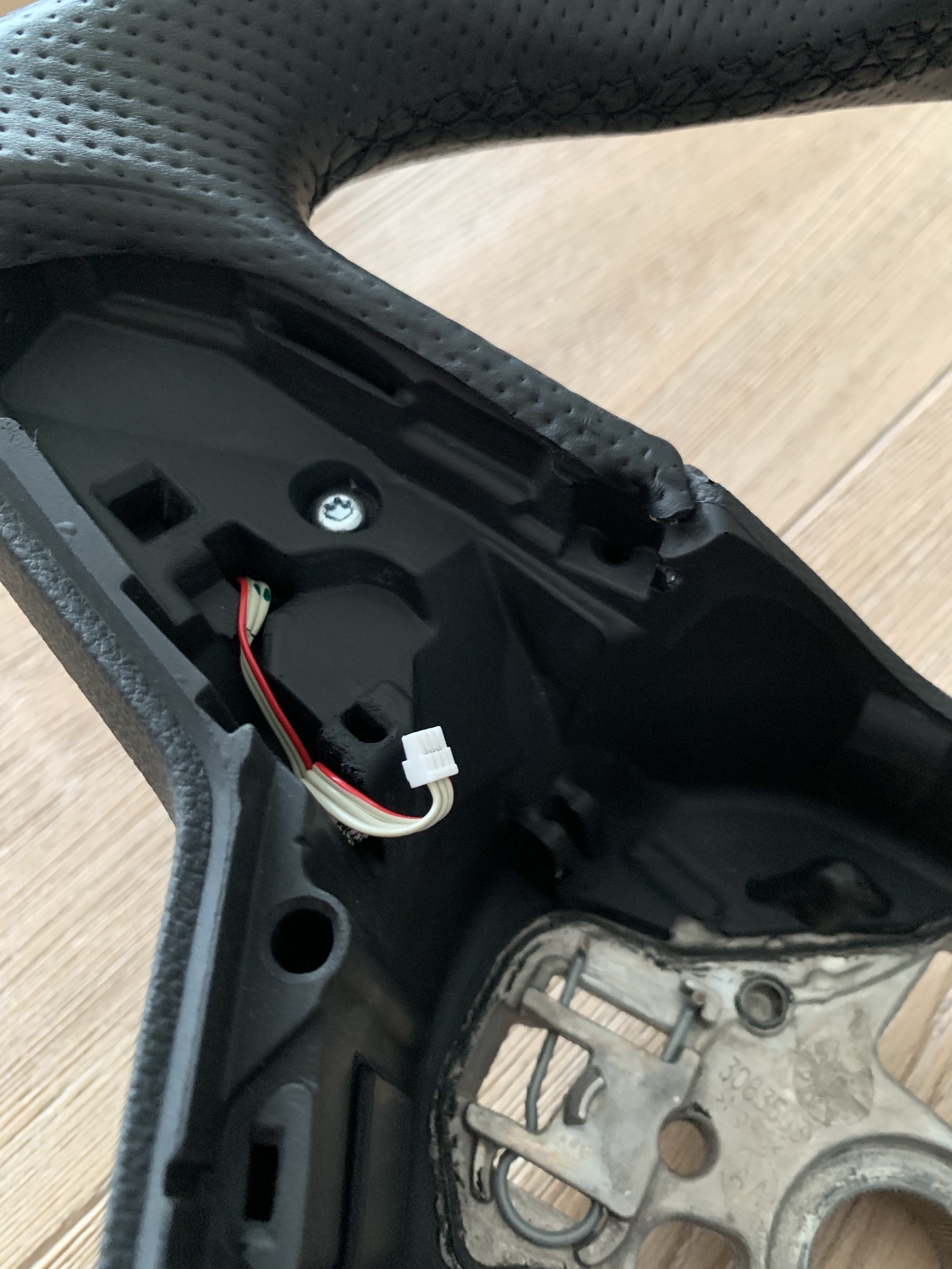

Fitted the new buttons and the socket on the right hand side is different to the left thus different to the plug. Looks like the plug is a larger 4 wire variant where the left plug and socket and the right socket are all smaller 3 wire versions.
The left paddle works and being only 3 wires on both sides is it a crazy idea to either hunt down a smaller plug and wire it in or bodge the larger plug to fit? I don't mind it being a fiddle if it works and I am confident in making it safe (airbag, etc.).

Finally sorted the '+' paddle. Got some cheap paddles (for an Audi) off AliExpress and 'acquired' the connector from the cable. The cable on my paddle has 3 wires but the plug on the end has space for 4 hence why it didn't fit. They are push fit connectors so I popped it off the wire ends and fitted it to the cable on the car. Now works a treat. I got the wheel for a good deal but having now spent on the buttons and 'spare' paddles I'm up to roughly £150. Still cheaper than a whole wheel.
