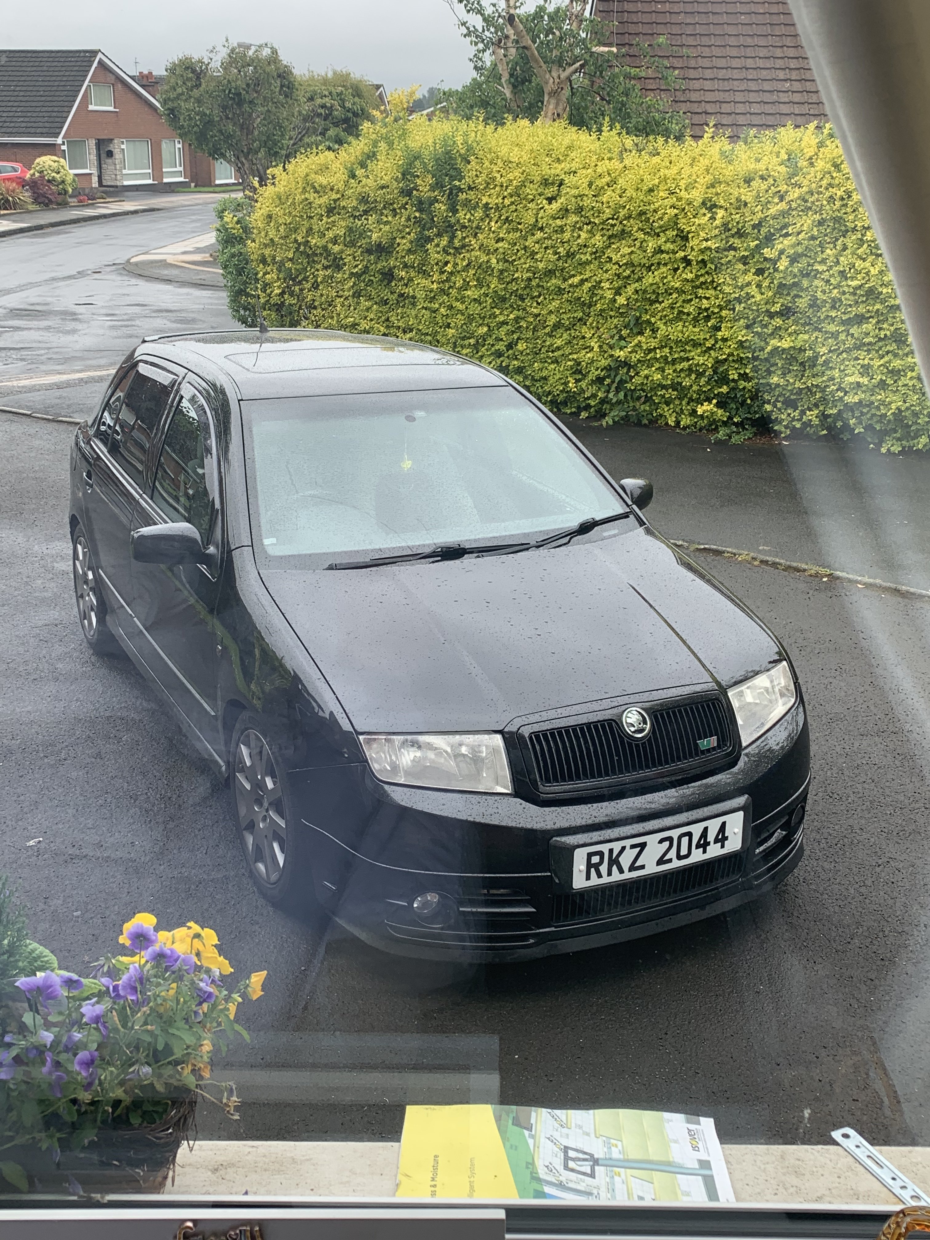

My vrs looking for more power maybe not sure.
Spec for my car
GT1756 Hybrid Turbo (56mm)
Dyno Tuned to 250bhp/365lbft by TT
Allard EGR delete
Full Intercooler Hardpipe kit
Seat Sport Intercooler
PD150 Head Bolts
Sachs Race Engineering Clutch & Flywheel
Powerflex Dogbone
PSB Poly-Bushed Front & Rear
AP Coilovers
Decat Downpipe
Custom Exhaust with Cupra Tip
Upgraded Front Brakes
Upgraded Vented Rear Brakes
Hel Braided Brake Lines
Custom Air-Intake
Darkside Shallow Sump
Gearbox Shim Mod
Shortened Gear Stick.
Just copied pasted the specs from sale of car. From the Dyno sheet the turbo is at its max car runs like petrol which is nice boost doesn’t come in till about 3000-3500 rpm then pulls real hard to 5000- 5100 so I’m guessing if I’m right the next turbo upgrade from that would be a gtb2260 they seem to be making round the 260-300 hp mark. I know I would probably need a injector upgrade has anyone ran more than 250bhp and bigger injectors but not have a lot of smoke. My car atm it’s smokes abit not as bad as seen with people like running 180hp lol. Any input guys thanks
