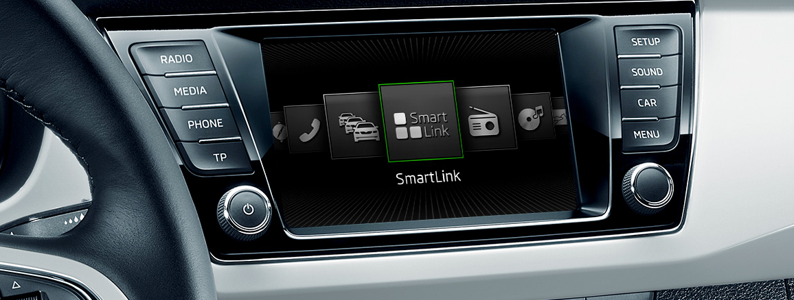

Or if you can’t find that, a pic of the screen will do, I can tell you from that. 2015 is a dodgy year, it might have SmartLink but it might not. If there is no CD drive in the glovebox, just SD slots then you should be able to have it activated. Another way to sell is to look through the menu, if SmartLink is there then it can be activated. If it’s not, it can’t be.
Not much help, but my early 2016 Scout (UK sourced), had the SmartLink option as illustrated above, but required activation, at an extra cost, by the dealer.

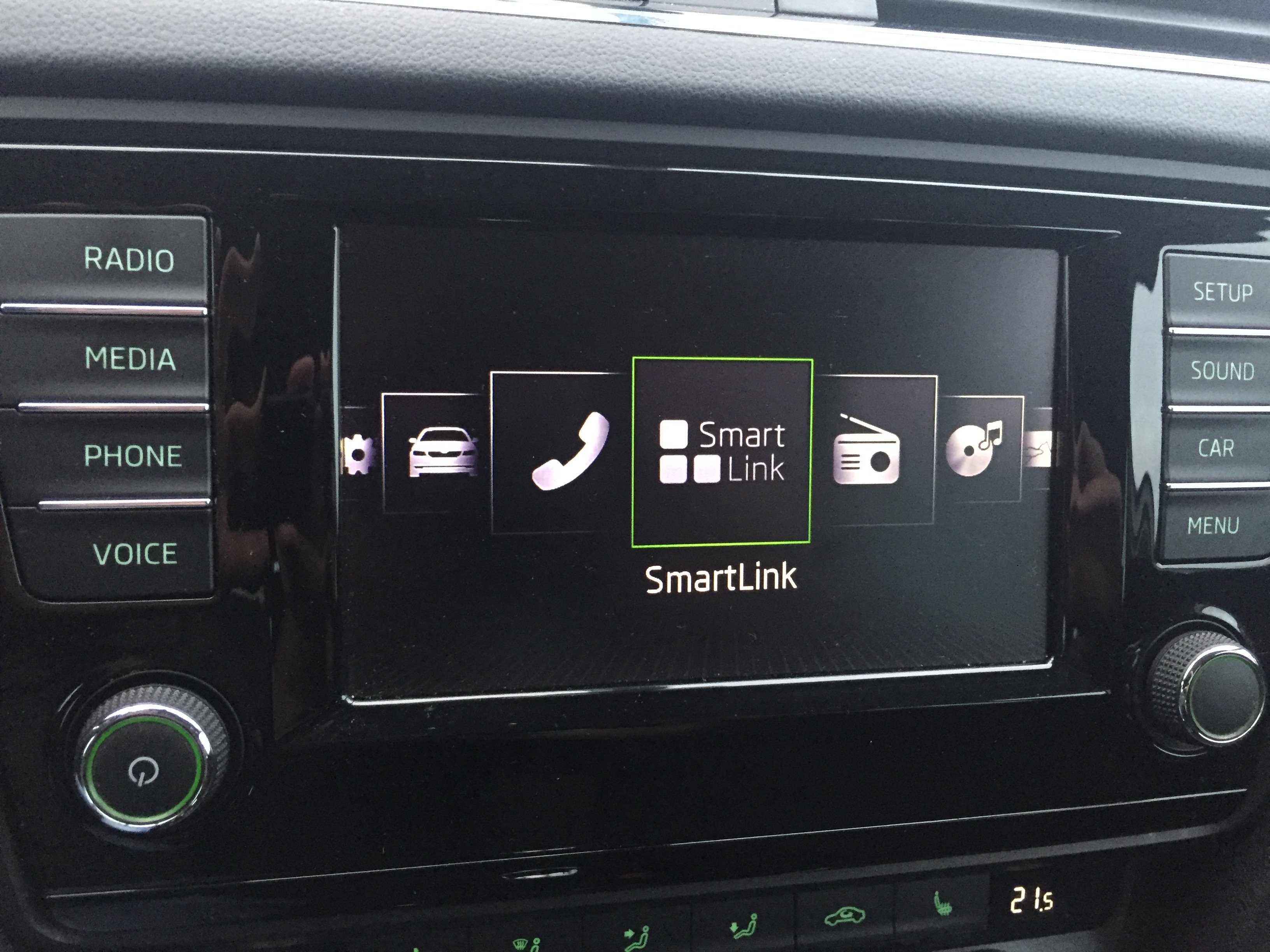

Is this what I was looking for?
If that is your car then you have the required hardware. Have you tried plugging your phone in to the car. Both carplay and android auto require a cable plugged into the socket under the air controls.
If using android you need to have the Android auto app installed. Carplay is built in.
If this then pops up with a message saying visit your dealer then follow the instructions.
