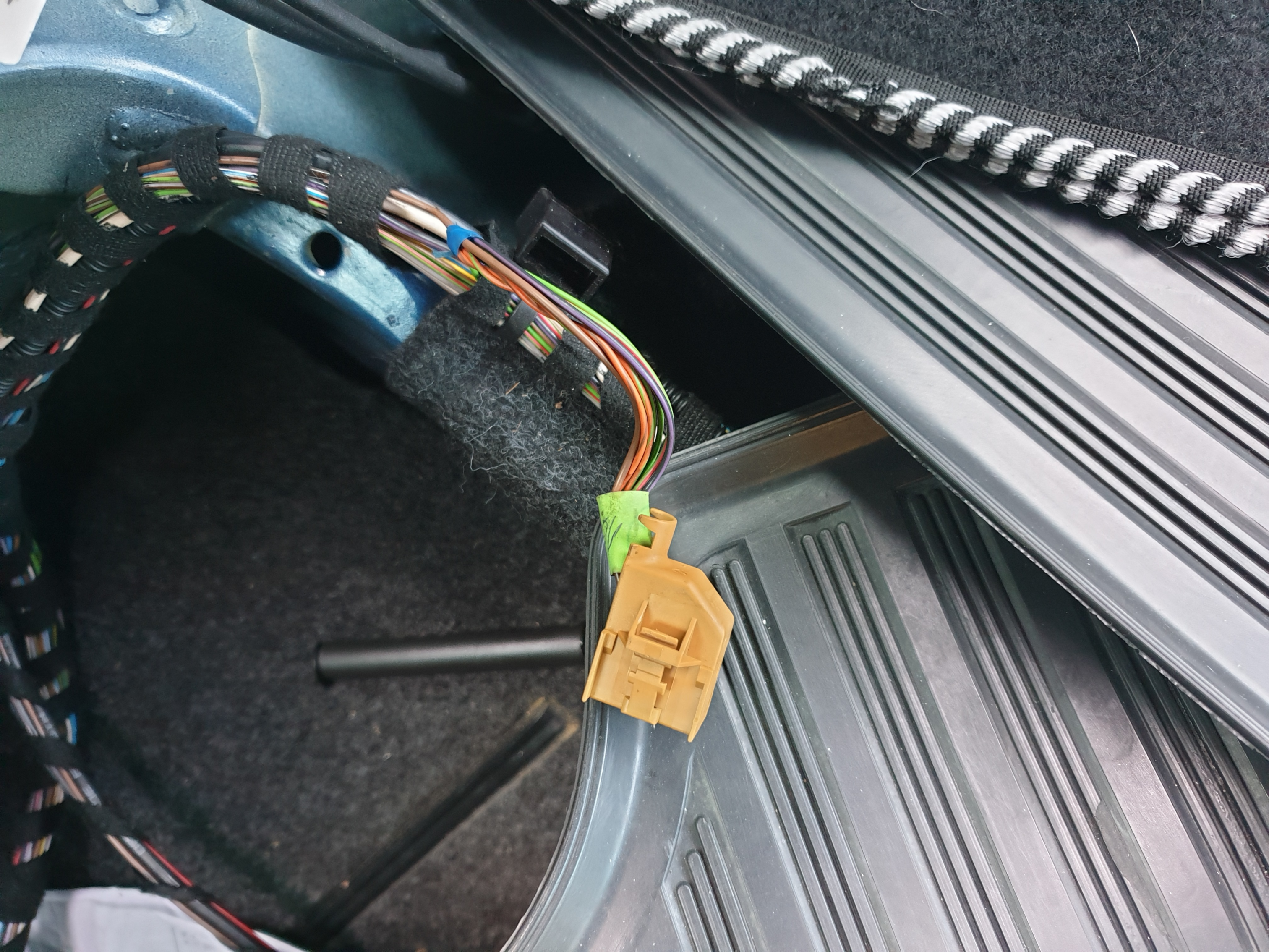

I'm led to believe that this is the connector from the main loom to the control module.  Looks like there's a whole bunch of wires here to splice in.
@J.R. how would I find the correct CAN-bus wire(s) to splice into?
They are a twisted pair and a certain colour code, I think one might be orange from memory.

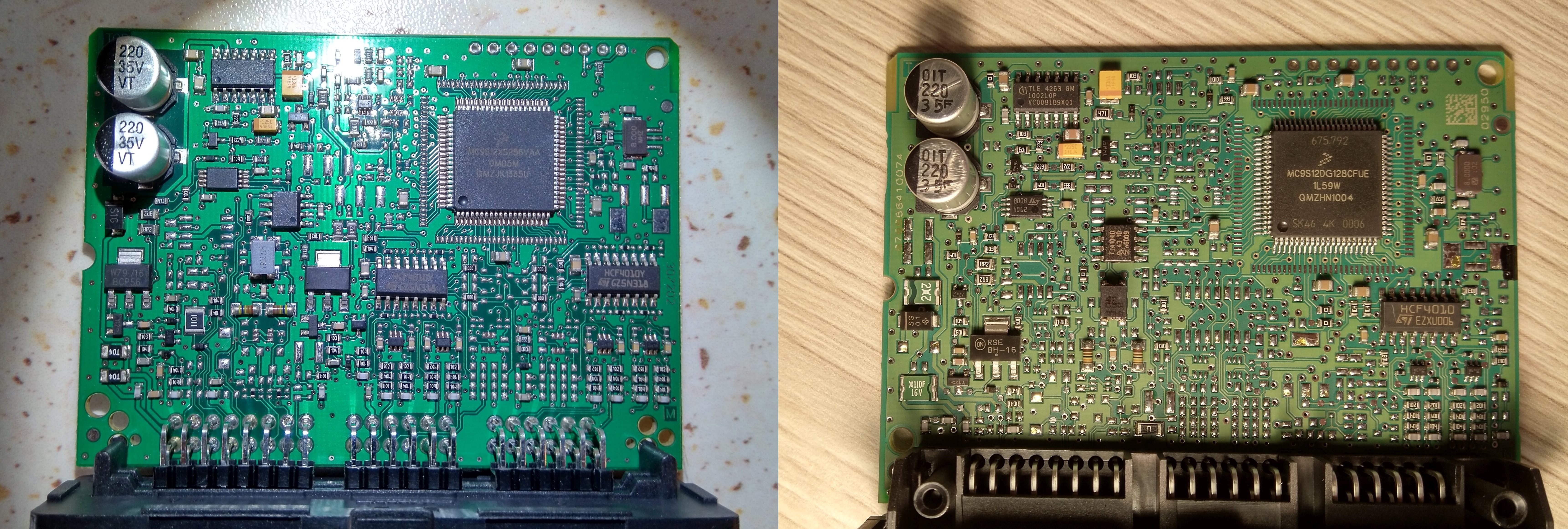

Update.
After a few months, I noticed that there was a non-erasable fault at the instrument cluster (17),  "Function Restricted due to Missing Message(s)". This is a classically stupid error code, it's hard to figure out why and where is the problem.
But it's did nothing, everything worked fine. Except that the PDC shutdown seems to be a bit slow, but I didn't feel it until the exchange.

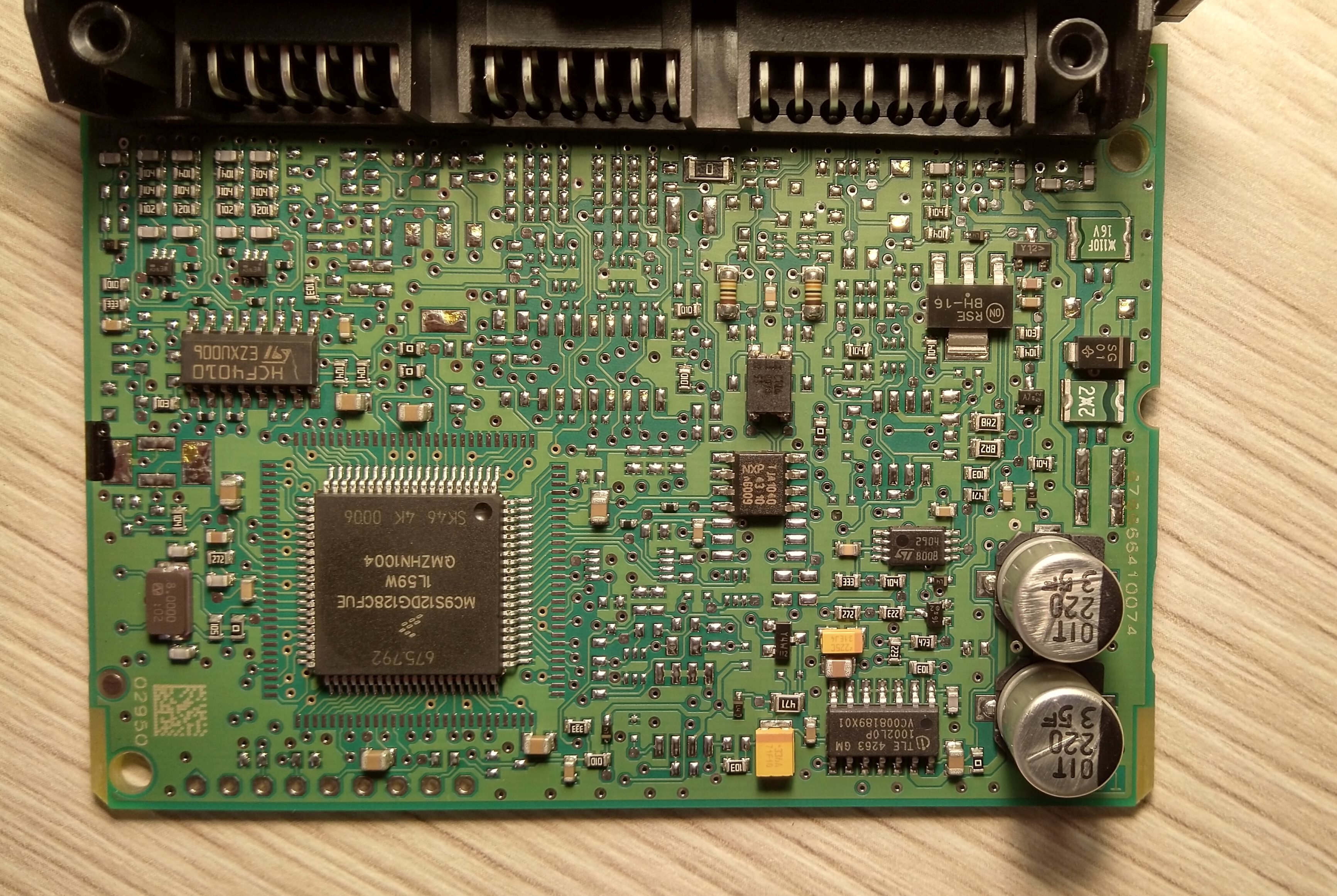

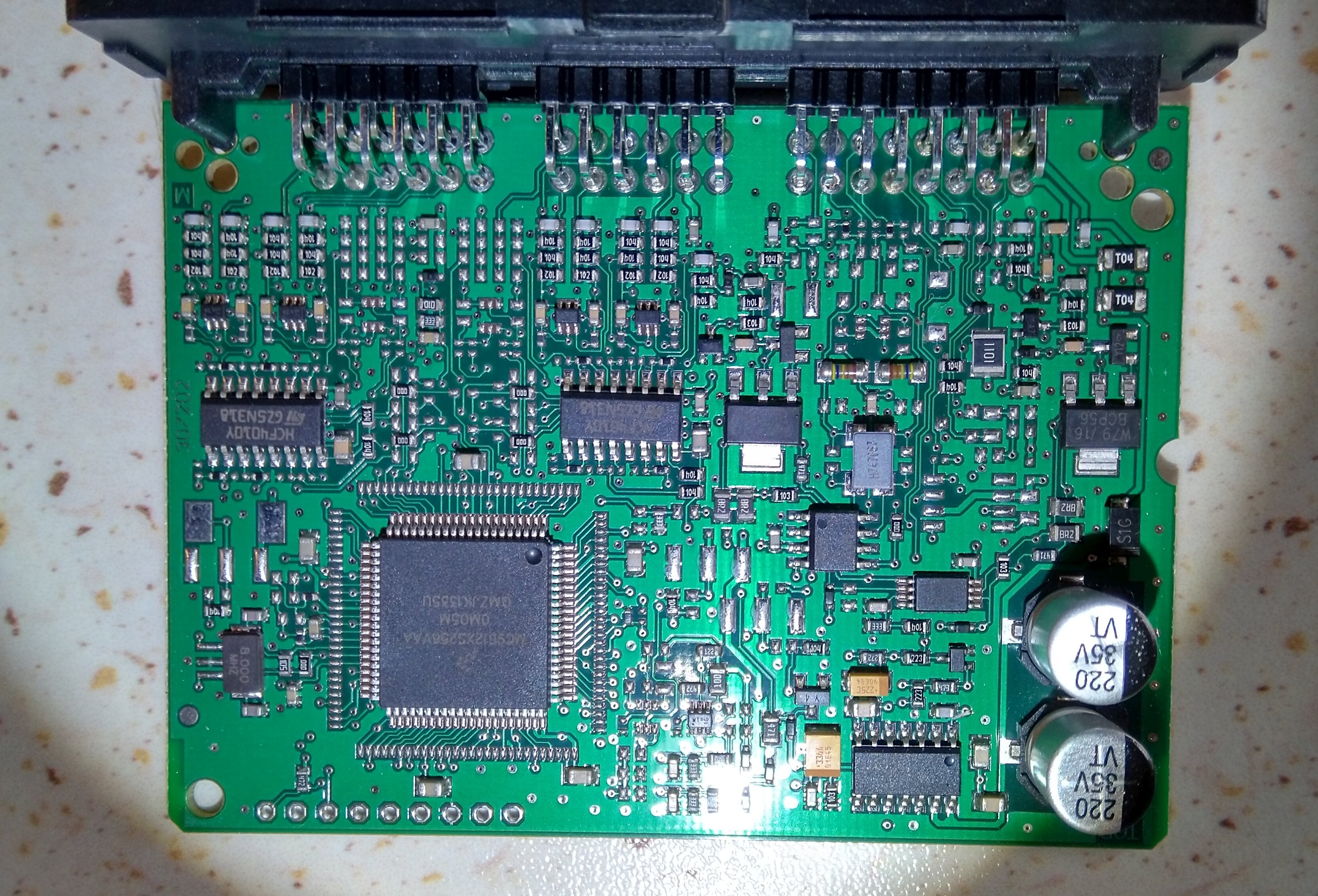

I looked through the parts catalogs and the HW/SW versions, and I decided to replace the controller (7E0919475k ) with  an 1Z0919475B. Just for fun.
The error disappeared immediately and the shutdown also became faster, so I think there was something wrong with the sw version. Maybe a missing electronic handbrake, or something with the CAN protocol.

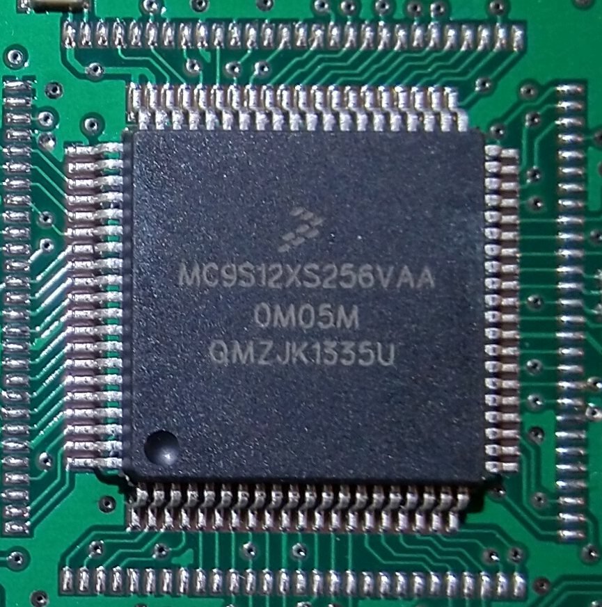

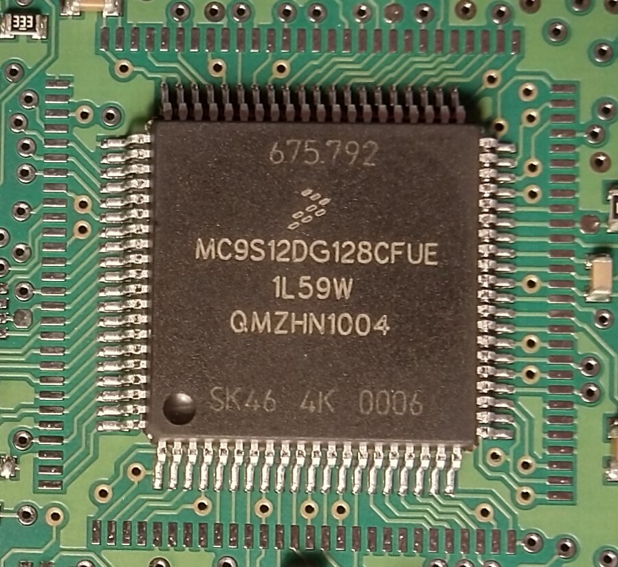

Plus, I checked the two panels.  Very interesting, the "new" panel (right) lacks the circuitry of the first sensors (as the software), but the Chinese contains these, just the sw dumber there, the program simply does not use the middle connector (front sensors I/O).
Unfortunately there is no external eeprom for further play, and the Chinese Motorola processor has 256Kb eeprom, while the 1Z0 has only 128. I have an interface for the MCU, but it's not worth going into it in depth. The circuits, parts and the panels are very similar, there are only a few small differences, some design changes.
Left: 7E0, right: 1Z0 7E01Z0
1k0.thumb.jpg.9cf618ef65908147df10ebc4720274b7.jpg7e0.thumb.jpg.af168f7cbbfe26f0f11c1da14bd8c94f.jpg

Hi @J.R.  It's been a long while and I still haven't done this, although I've got all the bits sitting in a box in the garage.  Are you able to advise where might be the easiest most accessible place to tap into the CAN wires, bearing in mind the loom runs down the passenger cill towards the glovebox?  Cheers!
