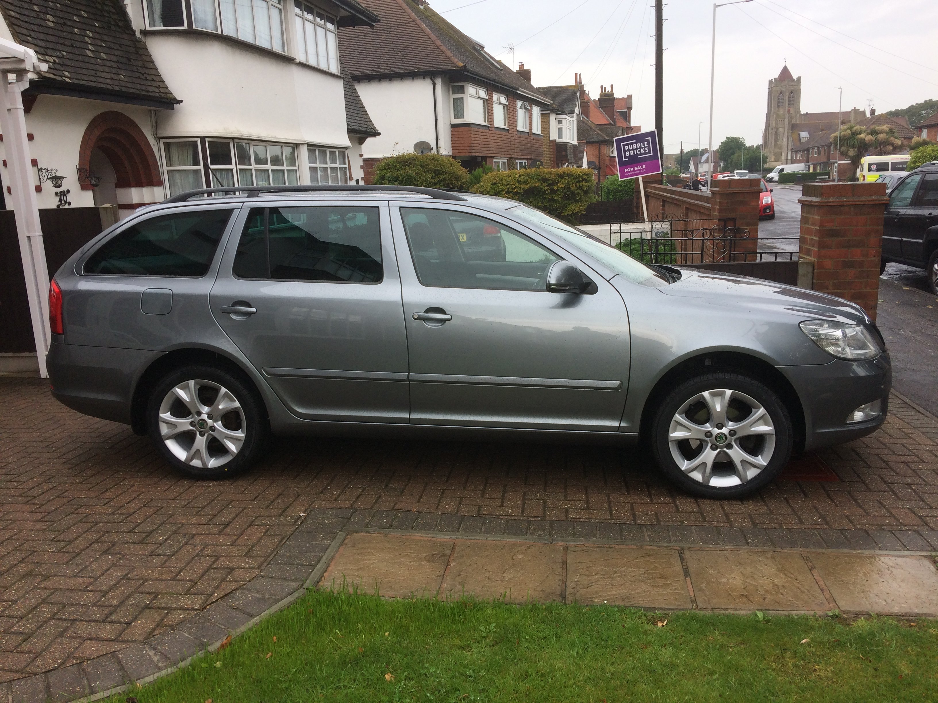

I have just recently fitted Skoda Pallas 17” wheels to my Octavia 4x4 Estate.
That's the look I like! :) Looks like I'd better start saving ...
Is yours is a preFL like mine?  Same colour at least.

33 minutes ago, mac11irl said:
That up there is an FL, can see the head light shape
Cheers.  I was looking at the foglights thinking they would be a different shape on the FL but of course, that's on the VRS ...
