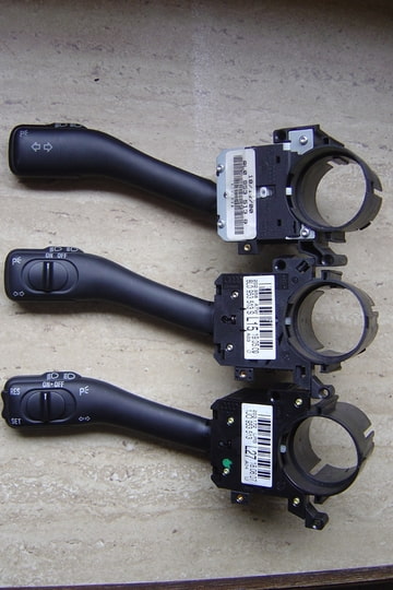

The stalk i have Is a stalk with just the one/off button for the CC there is no other buttons on it. This is what originally came with those MFSW's:
Its the middle one:
are you saying you wired the standard top one to work with mfsw?
Yes, originally I had the bottom stalk, but it now has the top one, all I had to do was disconnect the relevant CC wires from the 10 pin connctor and re-route them to the MFSW controller I fitted in the relay panel

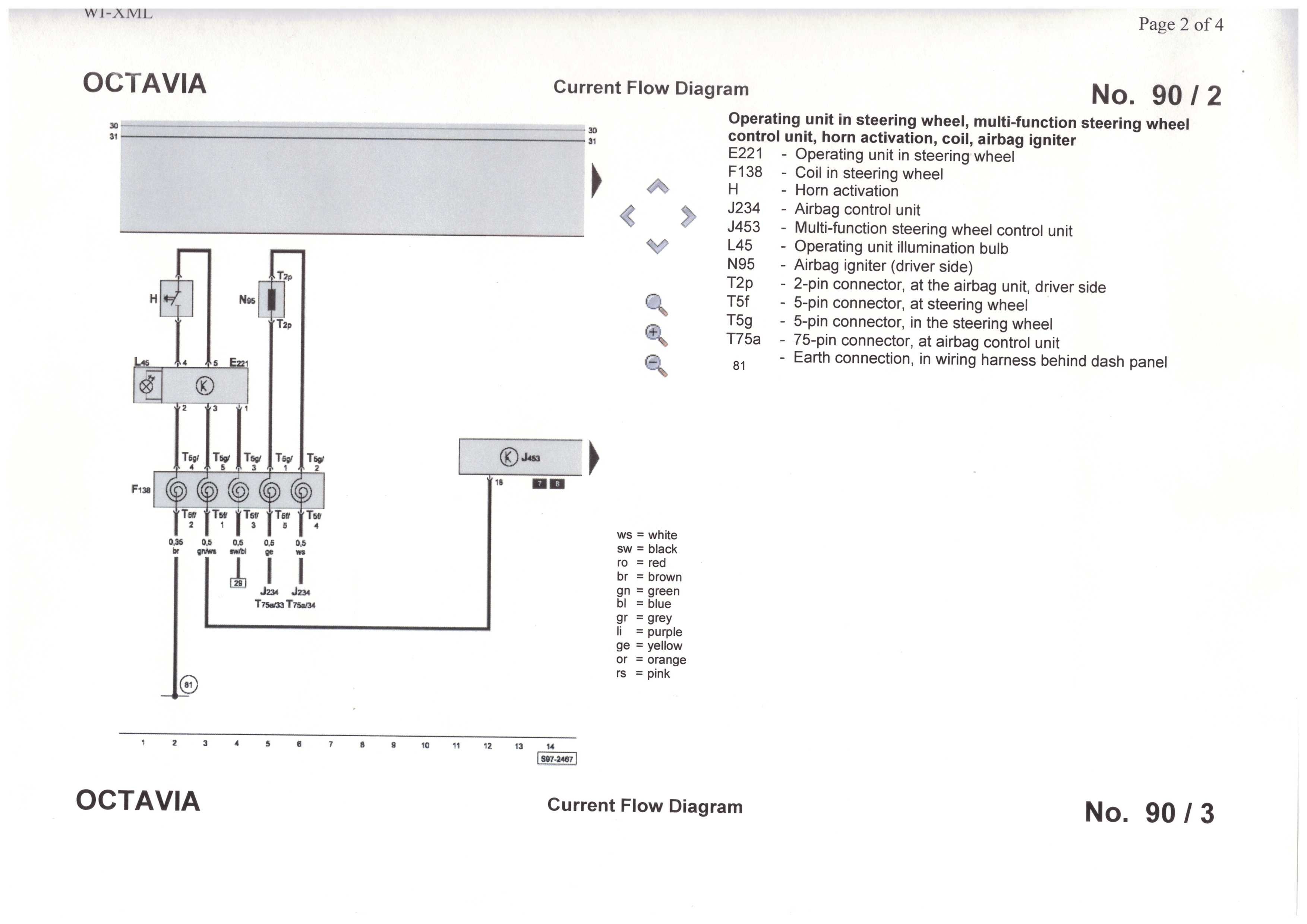

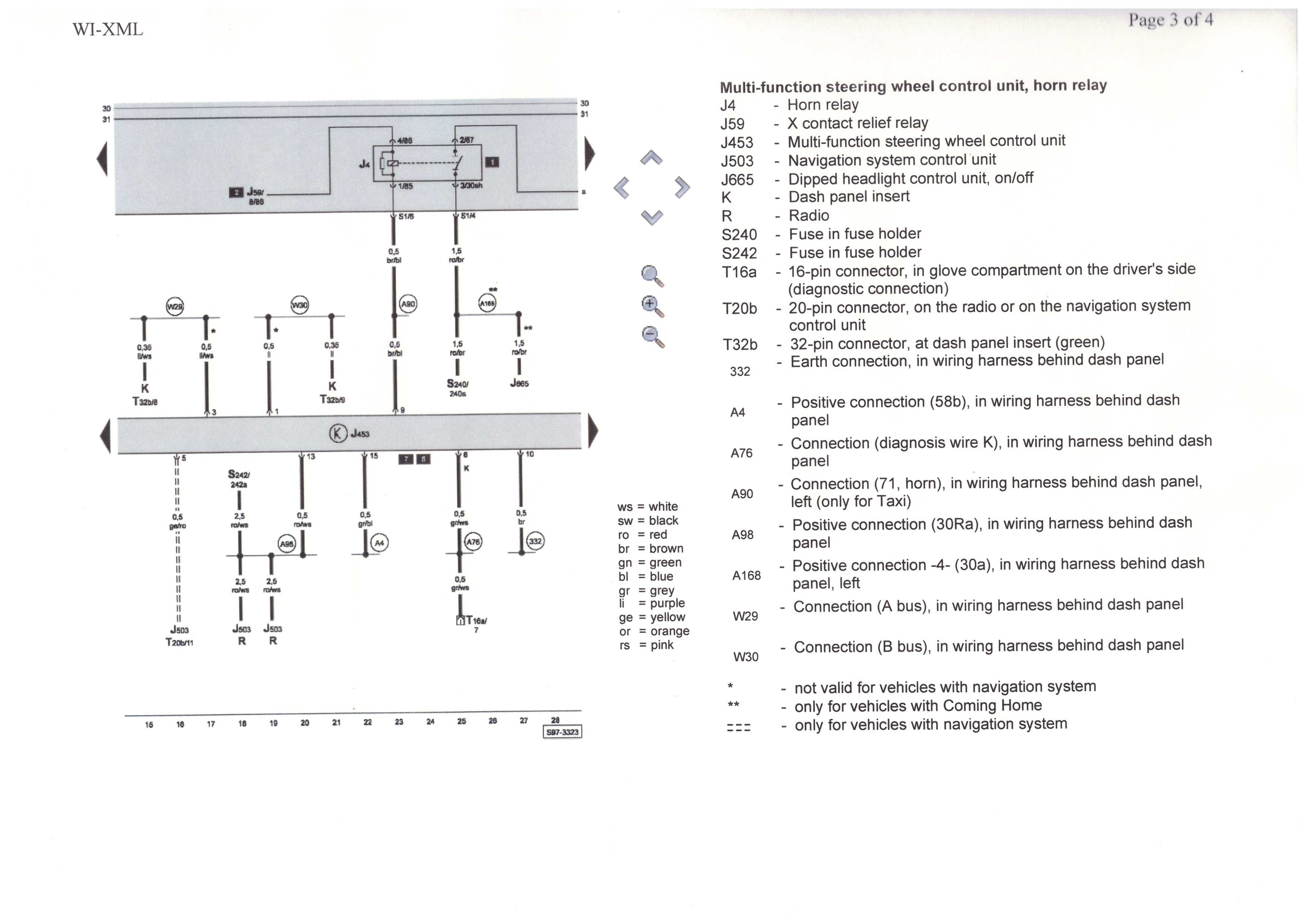

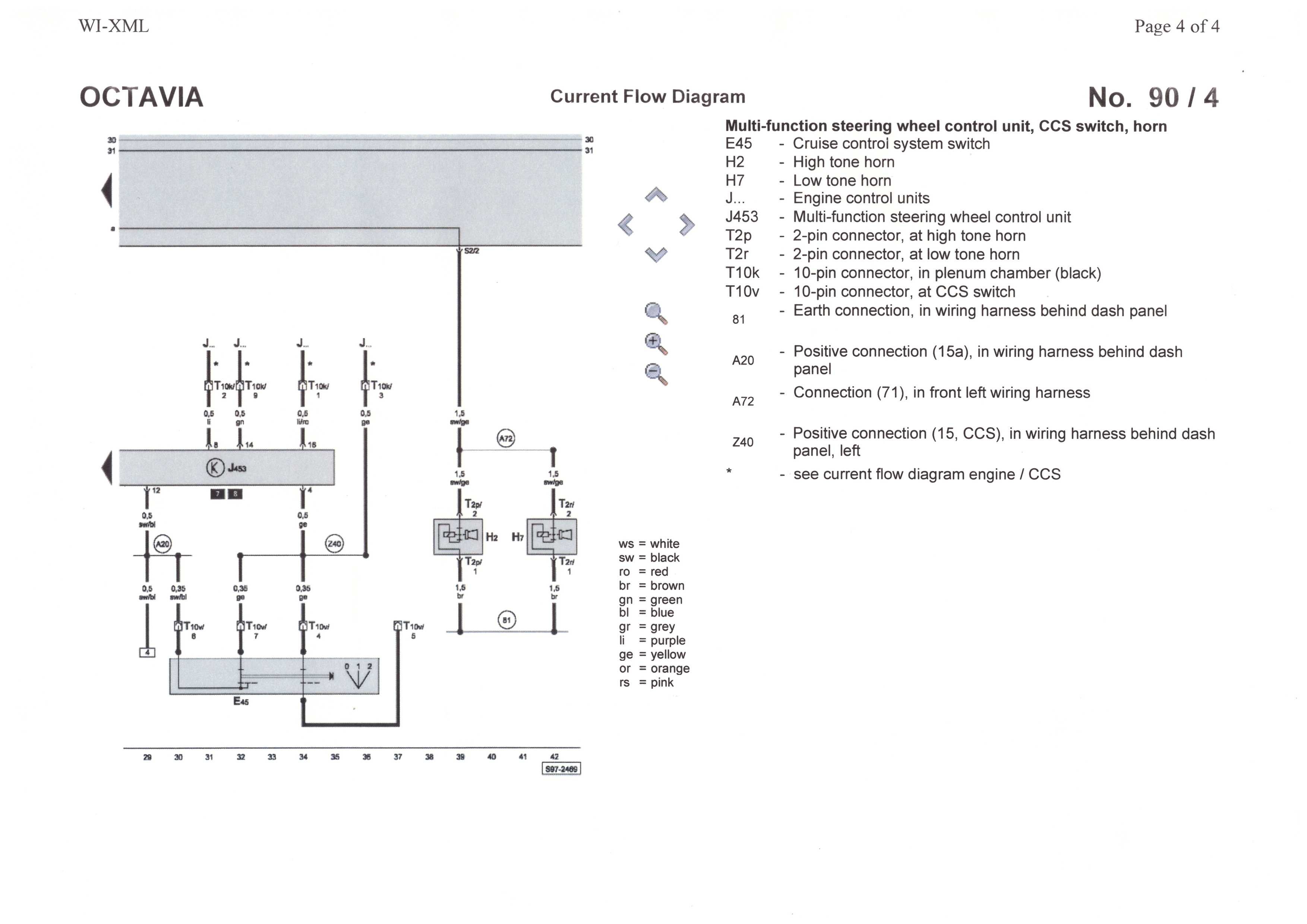

I'll have to dig the diagrams out but from memory, the horn wire connected to electronics units inside the steering wheel and the original horn wire from the old clockspring then went to the MFSW control unit
The horn connects to pins 4 & 5 of the electonics module inside the steering wheel, and the original horn wire connects to pin 9 of the control unit in the relay panel
could you show me the diagrams you have please? this would clear up so much for me.. :)
Its in!! thank you very much for your help!
