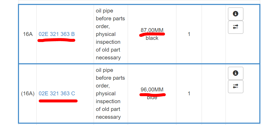

Hi all,
I stumbled across this information.
For the DQ250, there are 2 different sizes of overflow tubes. One is 9mm longer than the other, and if used, the oil volume filling of the gearbox, will accordingly be higher ?
Does anyone know why there is 2 ? Are we supposed to use the C version from now on ?
You use whatever one is fitted to that gearbox originally hence the physical inspection note.
