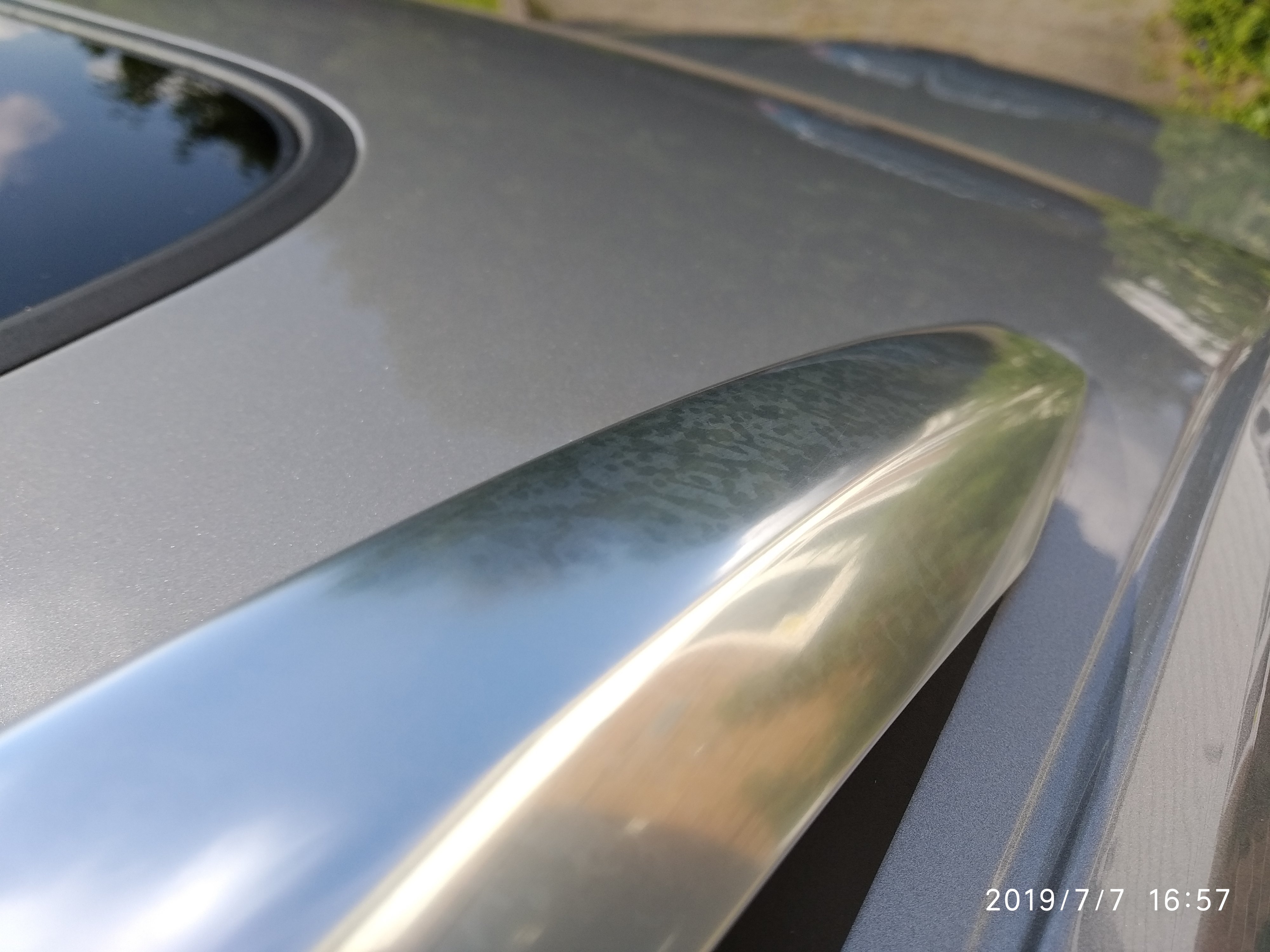

Decided to clean the car for the first time today using turtle zip wax shampoo and it left the roof rails looking bad afterwards- no shine, blotchy etc (possible it could have been like this before and just didn't notice). Got some autosol metal polish expecting it to sort them out but it's only improved things a small amount.
Took a photo best I could in the light. Any better ideas to get rid of the blotchy spots?

They are likely watermarks. I used to get these on my Leon ST roofrails if I washed the car when it was remotely warm.   Try claying them, it should help.

Be very careful with abrasive cleaners on the roofbar finish, such as Autosol. Same with claying. You could end up with them looking worse.
At the very least, test on an inner section that you won't see first!

The best way to try and solve this solve this is using a heavy grade clay bar and a detailing spray or clay lubricant but , unlike on paint don't use a vast amount of spray as you want the clay drier than usual
My roof bars and chrome trim were like this and I removed 75-80% of it with a clay bar after normal cleaning products wouldn't budge it
The chrome around the windows is probably the worst for it ....
It May or may not work but it's worth a shot for little expense
