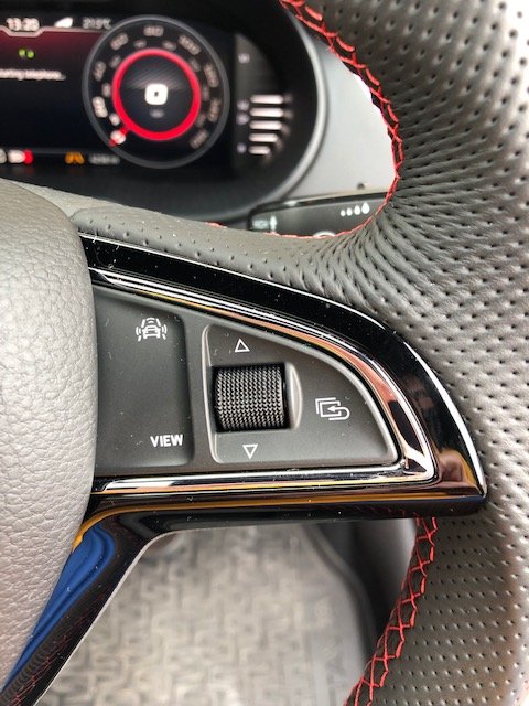

2 minutes ago, Auric Goldfinger said:
I have the View button and my 245 has the VAQ diff.
Can you take a photo and I check if I do when SWMBO returns home with my car. Thanks Andy.:thinking:
As requested:-
Mine has the phone button there, I imagine @shyVRS245does too
Is it related to having VC?:thinking:
could be, I also have a Speed limiter. Works by using the CC  buttons on the stalk but if I select the limiter, drive to the desired speed and turn on using the rocker button on the stalk, just drive normally and the car wont go any faster than the set speed unless you plant your right foot in emergency's.
Using the top button brings up Driver Aids, Lane assist, Cruise and limiter selected by the thumb wheel
Edited by Auric Goldfinger
Thought that by pressing your special view button it may give you different options on the digital screen format, map, no map,speedo,rev counter.:thinking:
