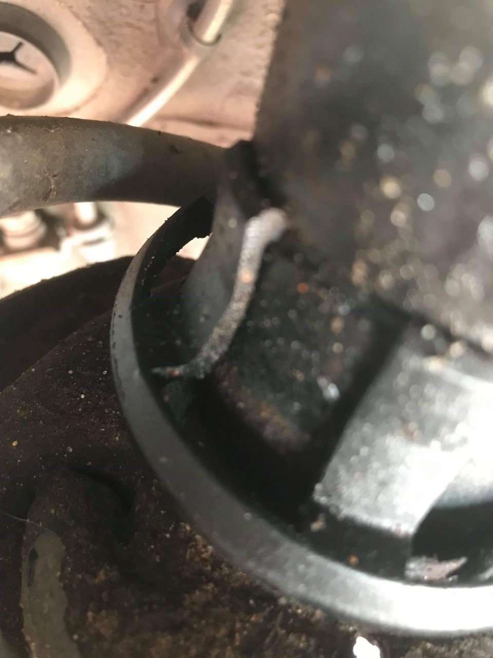

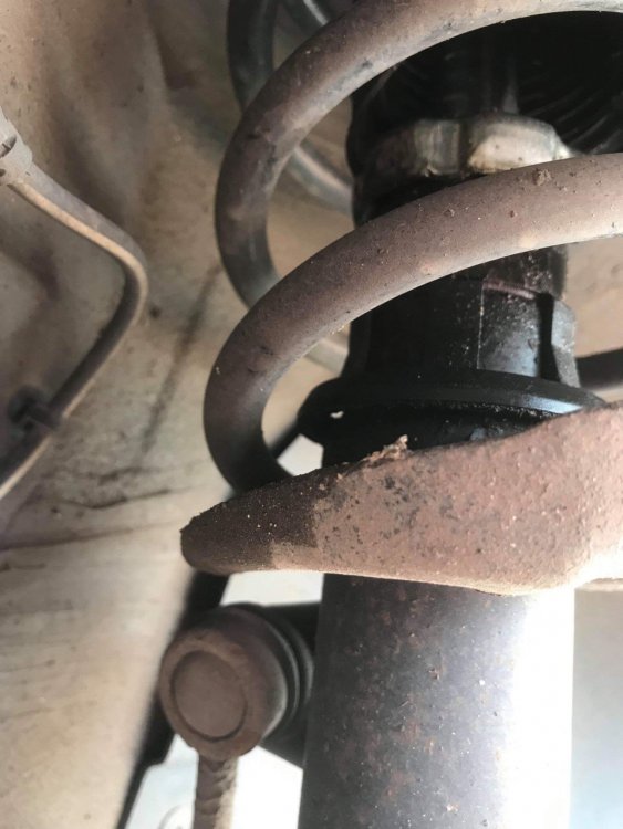

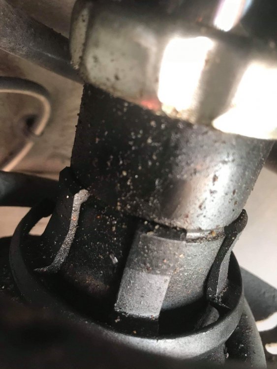

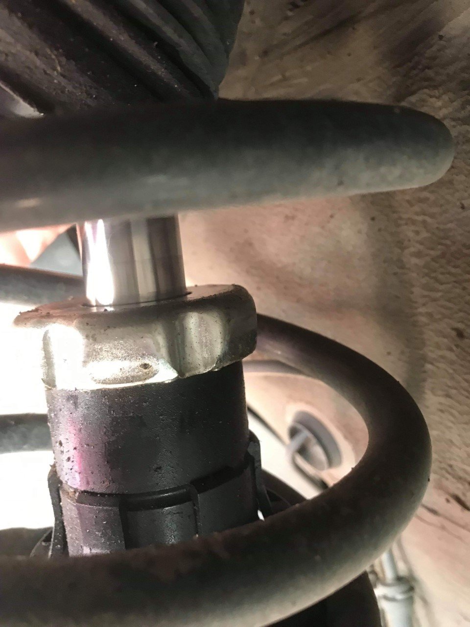

So i've removed the wheel and taken some pictures.  There's some obvious misting on the damper but i can't see any leaks - however, there is evidence of some sort of residue on the bottom of the strut (pic 3), but i don't know if this is definitely oil from the damper.
Any opinions on whether it's the damper leaking and whether i should change it?

Clean it with a rag and some spray brake cleaner and check in about a month.
There will be hardly any misting if any
