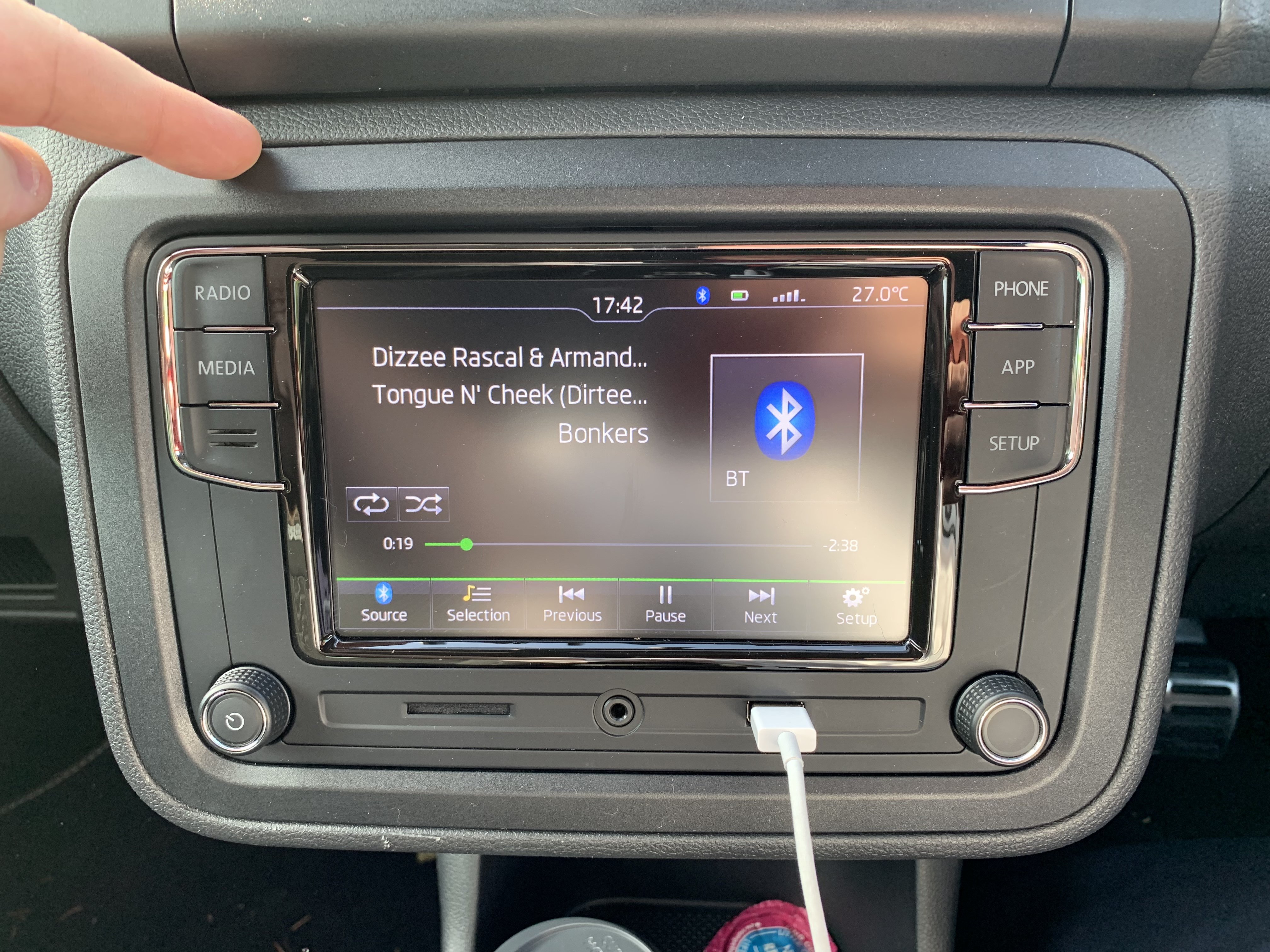

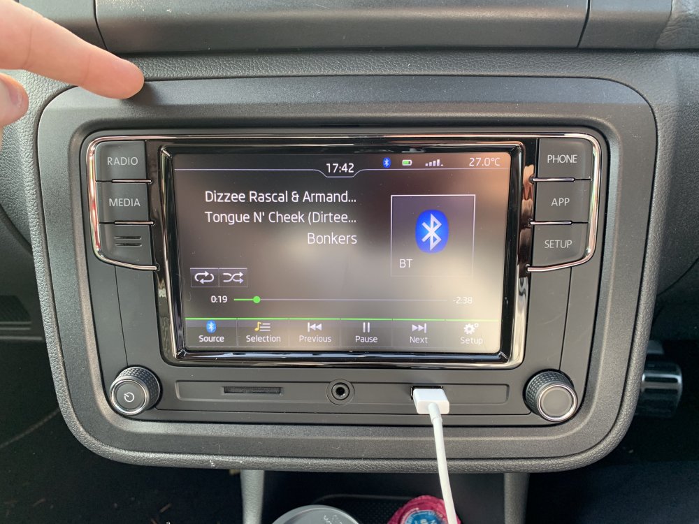

This is the photo of the after install. Where I’m pointing is to the line where you lever the facia off with a “trim removal tool” or other plastic/non scratch flat edged implement. Then the screws are located under fascia, 2 on left and 2 on right to remove unit. Same facia from original, no different one needed.
