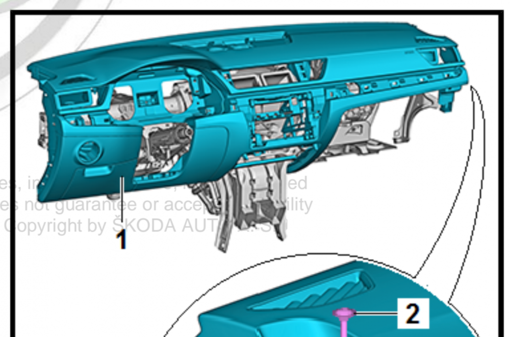

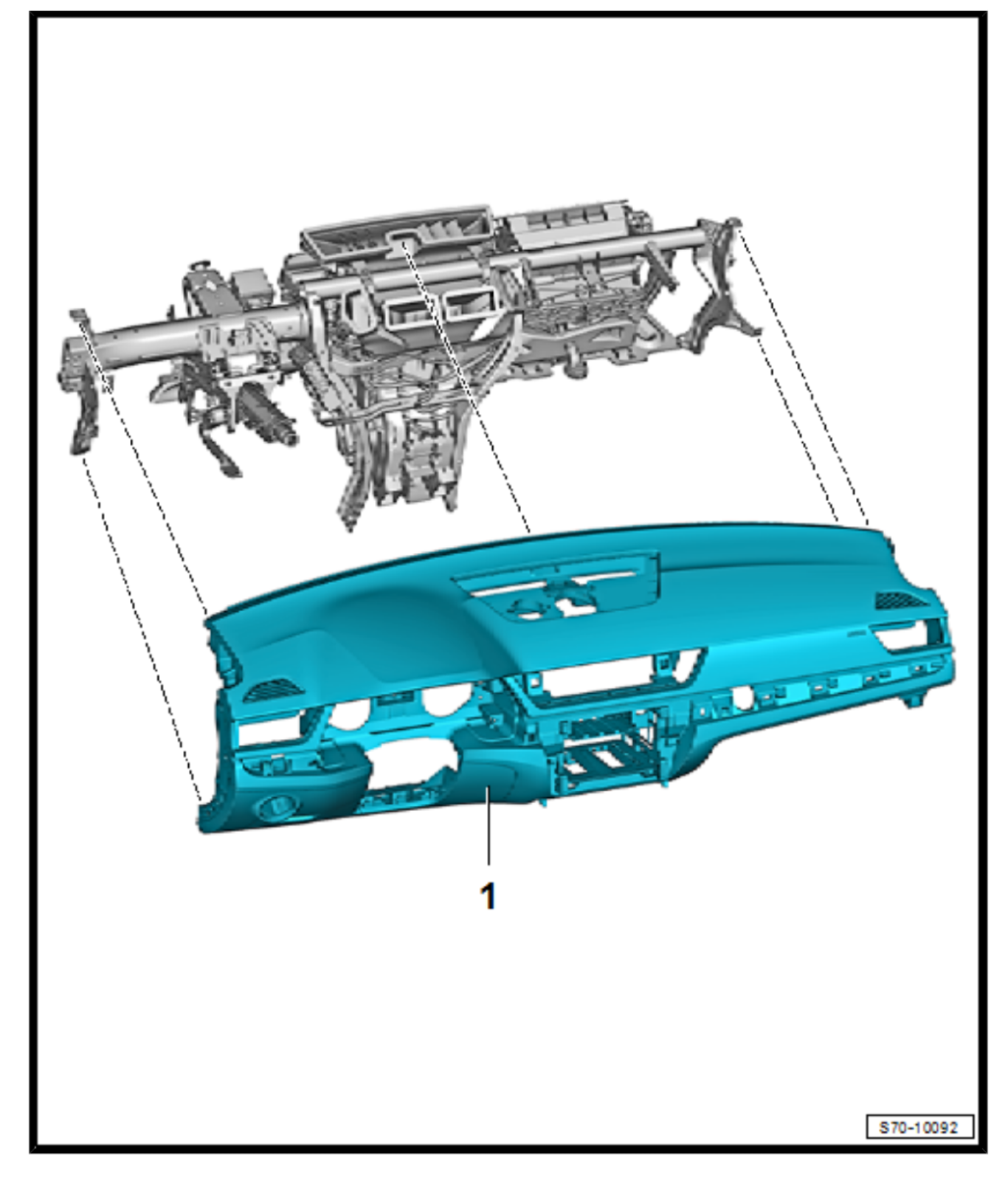

I had a look in the repair manual, but I can't seem to find anything specific to the area ur looking at.
All I could find was this, not useful though.....

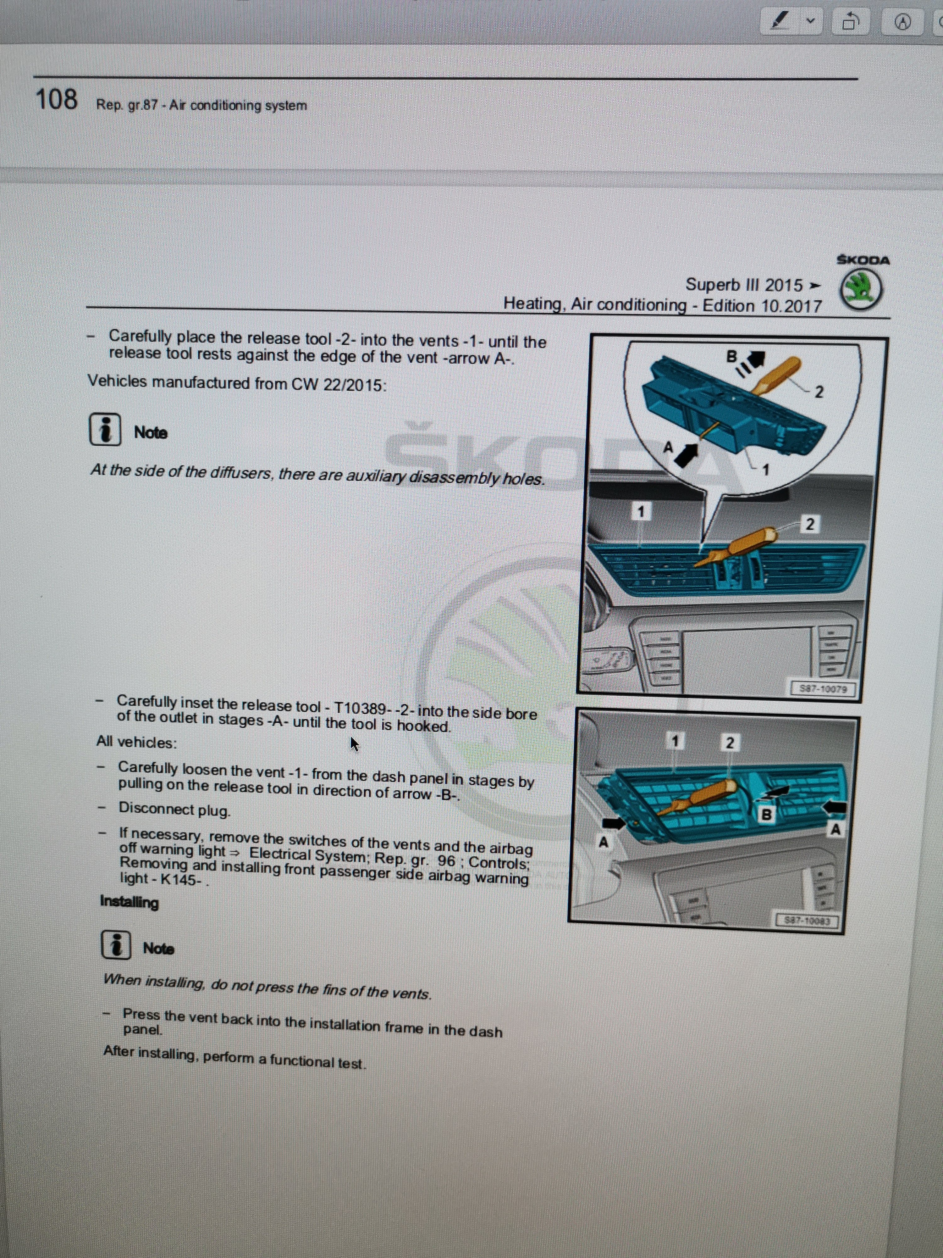

There is a special tool out there. You have to slot it into the vent and hook it from behind.
2 hours ago, Itsrelfy said:
That's just was I was looking for and very helpful thanks.  Now to find that tool!
