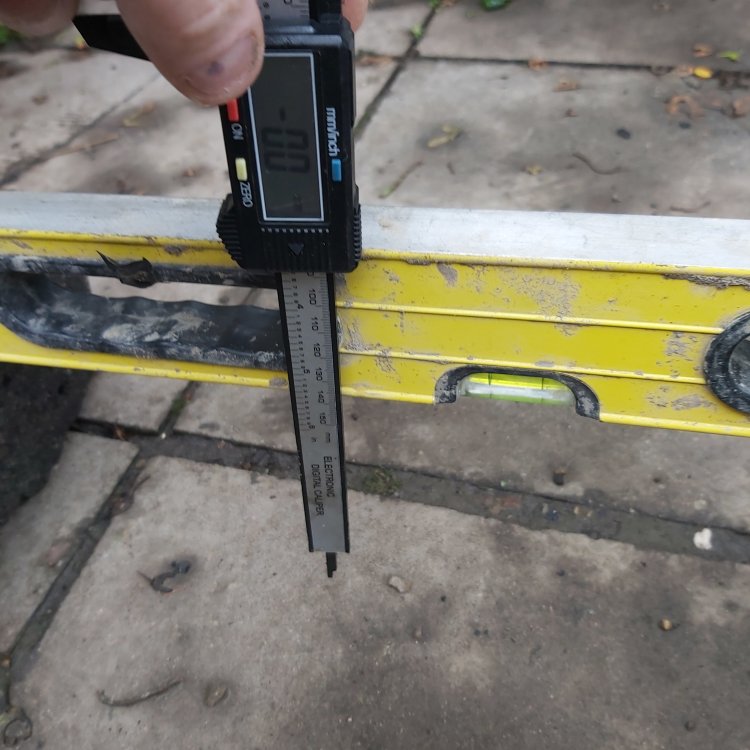

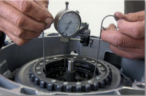

Sorry if I have misread your first post but how did you measure the clearance so that its 0,3 – 1,0 mm without the gauge as below -
Thanks again!
a digital vernier with a metal flat bar across the gearbox found it on youtube measueed at 3 points i ised a digital so i could get it accurate

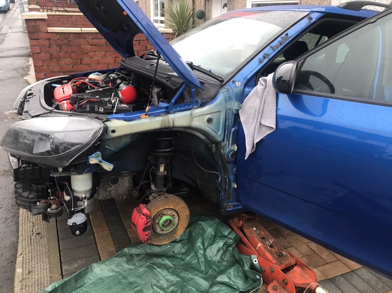

its a lot heavier than a normal gearbox watch for the drop think its about 100 kg im here if you get stuck allow a few days just incase you have problems and dont forget when you take the starter motor off there is a bolt behind in the hole make a not of where the small bolt goes back as 1 of the18mm bolts is shorter   it you tips.
put a rope round driver side drive shaft and lift it up out of the way makes your life a lot easier when putting the gearbox back in depending on what car you have you might be better off dropping the sub frame rest it on a jack and pull it back i held mine in place with a chain i had with the catches but a bolt through will do the same 3rd time i did it i had it out clutch out checked it put it back set it up and gearbox back in 2 hours 1 pair of hands 18mm 5/8or 16mm 10mm 13mm and if you drop the subframe you will need alignment pins ti put back properly of steering is **** and tracking will need doing
sent you a pic i just done to give an idea of setting the clutch up
i didnt use the level i used a piece of metal flat bar the same way and put it across the gearbox put the end of the vernier to the clutch plate and put to zero then it accurate if there is no play ie plates are tight redo it as its incorrect it has to have a small amount of movement of it will not work and cause damage 1 clutch i got to 0.2mm and the other was 0.7mm and works a treat
