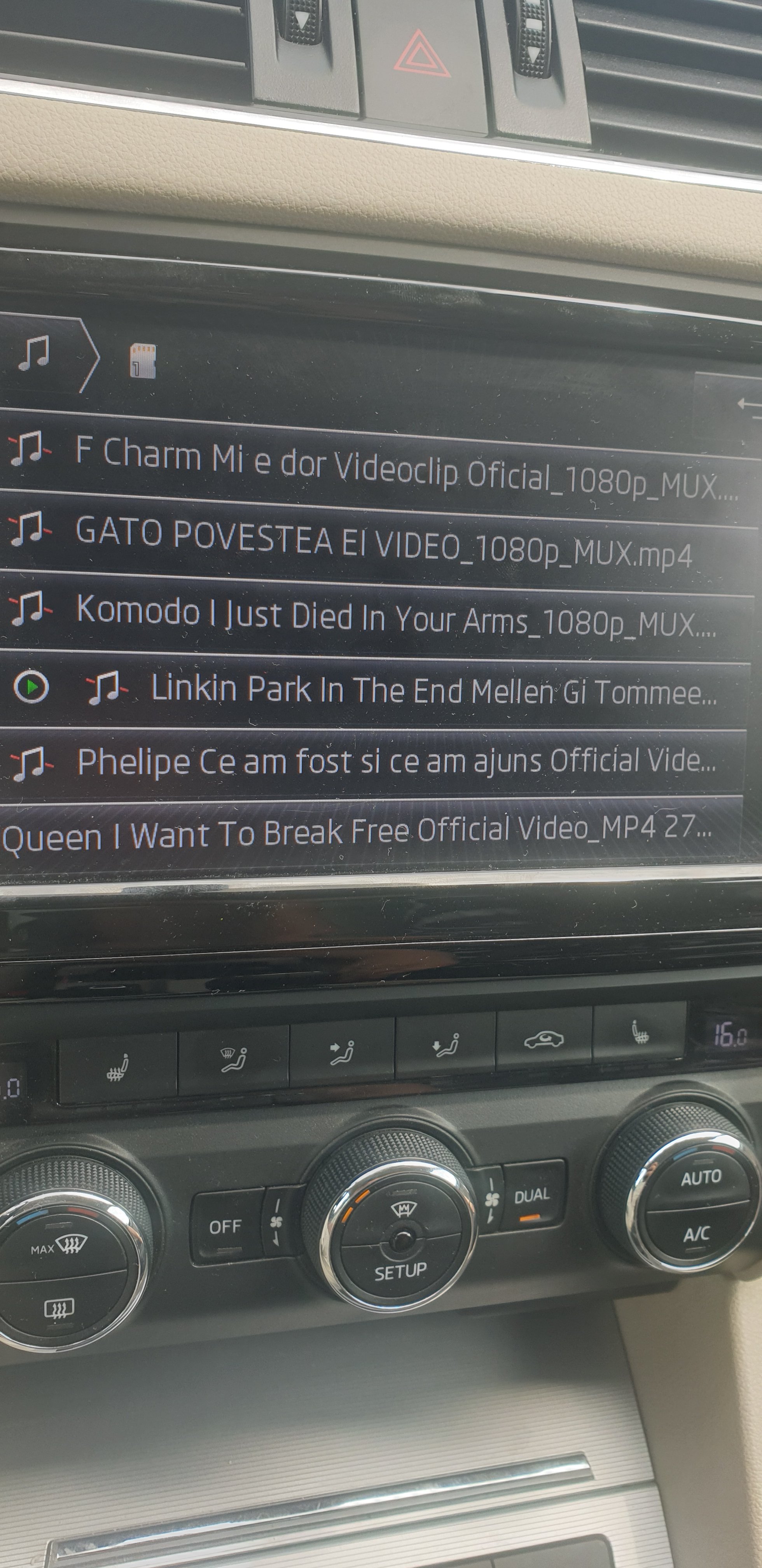

Hello group! I have a columbus navigation I think (the one with the big display) I put about 14 mp4 video on a memory card. the problem appears to me only vodeo the rest of the error. Where could the error be, or what is happening? what format should be made?

Looking at the file names they suggest to be 1080p i.e. 1920x1080 resolution. Columbus is 800x480 and I don't think it can play 1080p files. Encode to lower resolution and try again.
