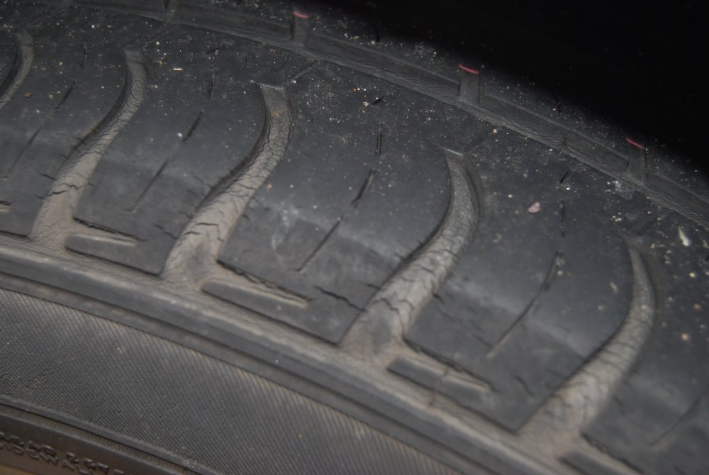

Perishing tyres
I realise that tyres have a limited shelf life but I have noticed that the only factory-fitted rear Hankook is showing signs of deterioration after 6 years.  My sister-in-law's Fabia of the same age is shod with  the factory-fitted Continentals and they have no signs of perishing. I have never had this tyre problem before and am wondering if Hankooks are prone to it? I realise that tyres should be replaced after 5 years for safety reasons. I have always been particular about maintaining correct tyre pressures.
I have contis of a similar age that are going the same way. Planning to replace them in the autumn when I switch back to winters. Can afford the time to shop around then as the wheels won't be on the car. Explain why they are not wearing that much as they have gone hard.
I have an European road trip planned with 4-up and luggage. I had better have it replaced before then for safety sake. Shame as it is only half worn

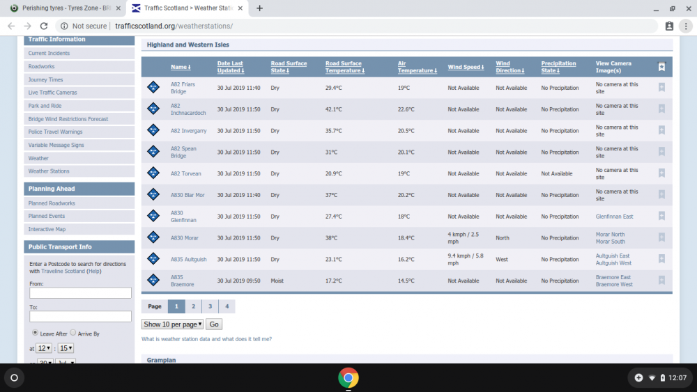

Just a small point re Summer Tyres, All-Season, All-Weather, Winter tyres and temperatures.
It is not about Ambient temp and how often you see that,
it is Road Surface Temp and i think anyone that bothers to check will find 30*oC plus road temps are rather common in a few months in parts of the UK and more common in many parts.
See todays road temp in parts of the bitter north.
http://trafficscotland.org/weatherstations

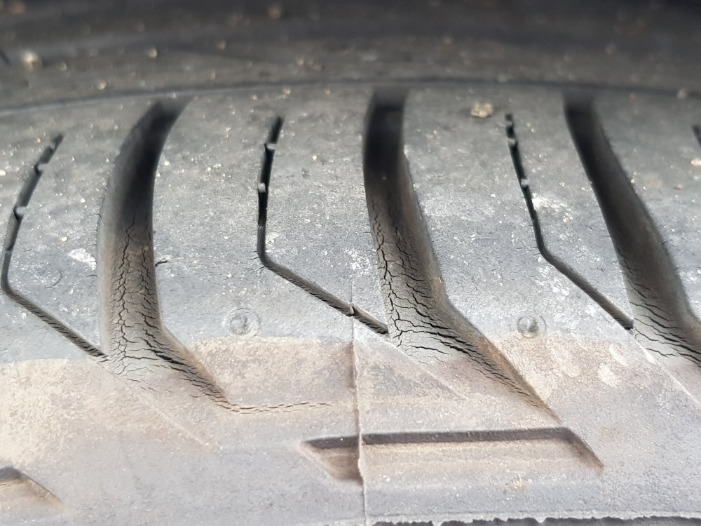

Was advised to replace Nokian WR A3's at my last service in March due to perishing near the treads (after 5 years and 25k they still had 4mm off tread lef).
Swapped tyres over to my Goodyear Efficient Grip Performance and was advised during the MoT to replace them as they were showing perishing near the tread. Again they were about 5yo with 25k under their belt with 3-4mm of tread left.
Fitred Goodyear Vector 4Season Gen2.

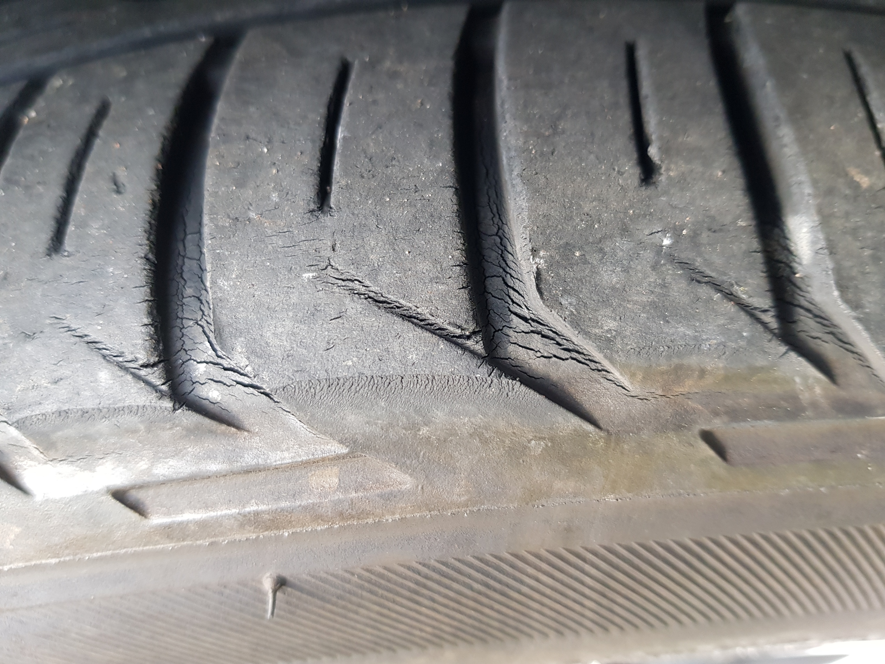

Going to have to replace couple of tyres on our Roomster, prior to MOT this month, one is an original (as date codes just over 7 years), got similar perish cracks to Op in first post.  The tyres are Bridgestone.
The other is a 2015 tyre, came off the front last year when got a puncture, and replaced both fronts, so could keep one, but chosen not to, so all 4 will be same type
Looks like modern tyre formulation starts perishing sometime 5-7 years around

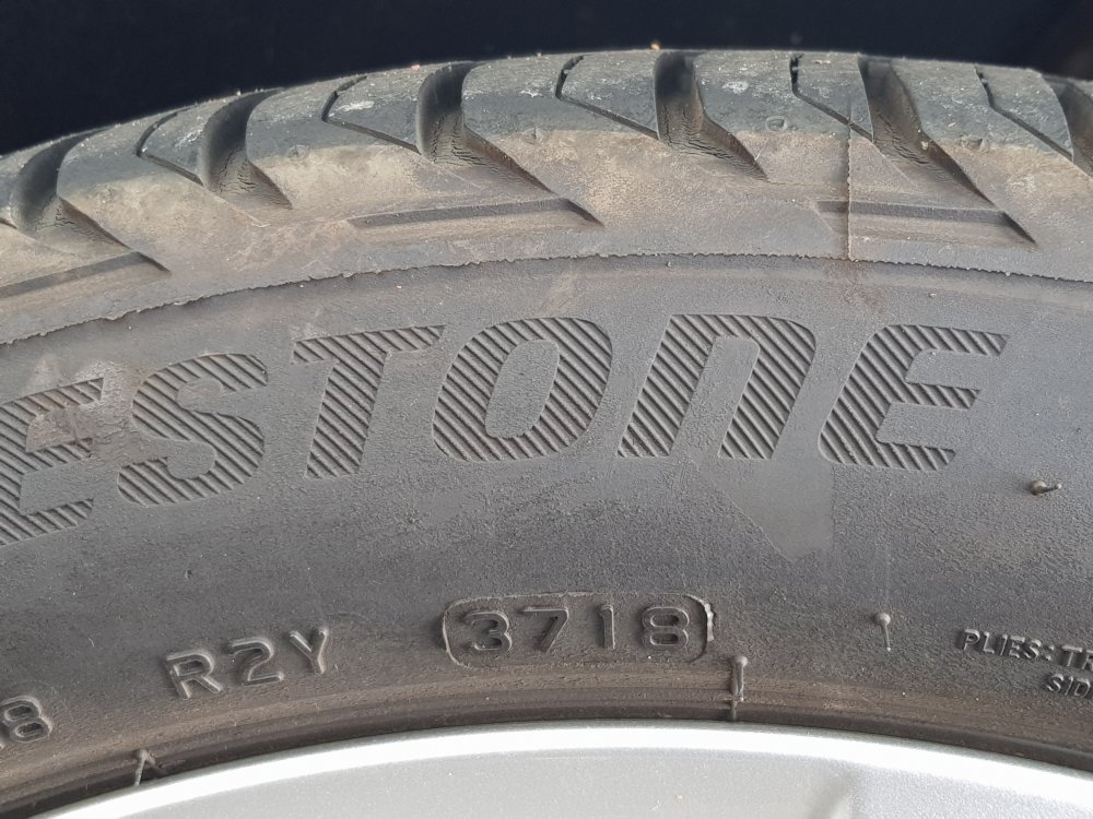

This is what all 4 of my OEM Bridgestone Turanza's look like after less than 3 years and under 8500 miles from new.
Problem seems to more widespread than first thought.
Yeah. I checked my neighbour's 2018 Audi with 20K miles, and he had cracks too.
I don't recall young tyres cracking like this a few years ago.
