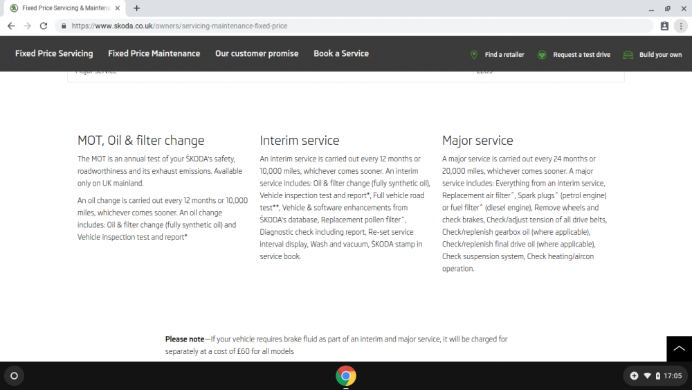

Edited by Roottootemoot
Brake fluid changed at 3 years which must be now or soon, so oil service plus brake fluid change?
Just no Oil Service if the owner does not want on a 3 year old car with 22,000 miles covered on Variable / Flexible Servicing first serviced @ 2 years if the Technician correctly reset the
Service Indicator.
