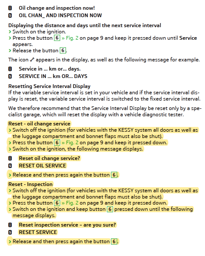

If I can remember correctly, when you get to point 3 in your post if you continue holding the reset button the option should change from reset service to reset inspection or something similar. You then need reset that option. You have to be quick though as it changes fast. At least that is what happens on my vehicle.
That's what I thought as well but it doesn't ... it never changes to reset inspection - just continues to say reset service! Will continue to have a play. (I recently had my car re-mapped, maybe they buggered something up)

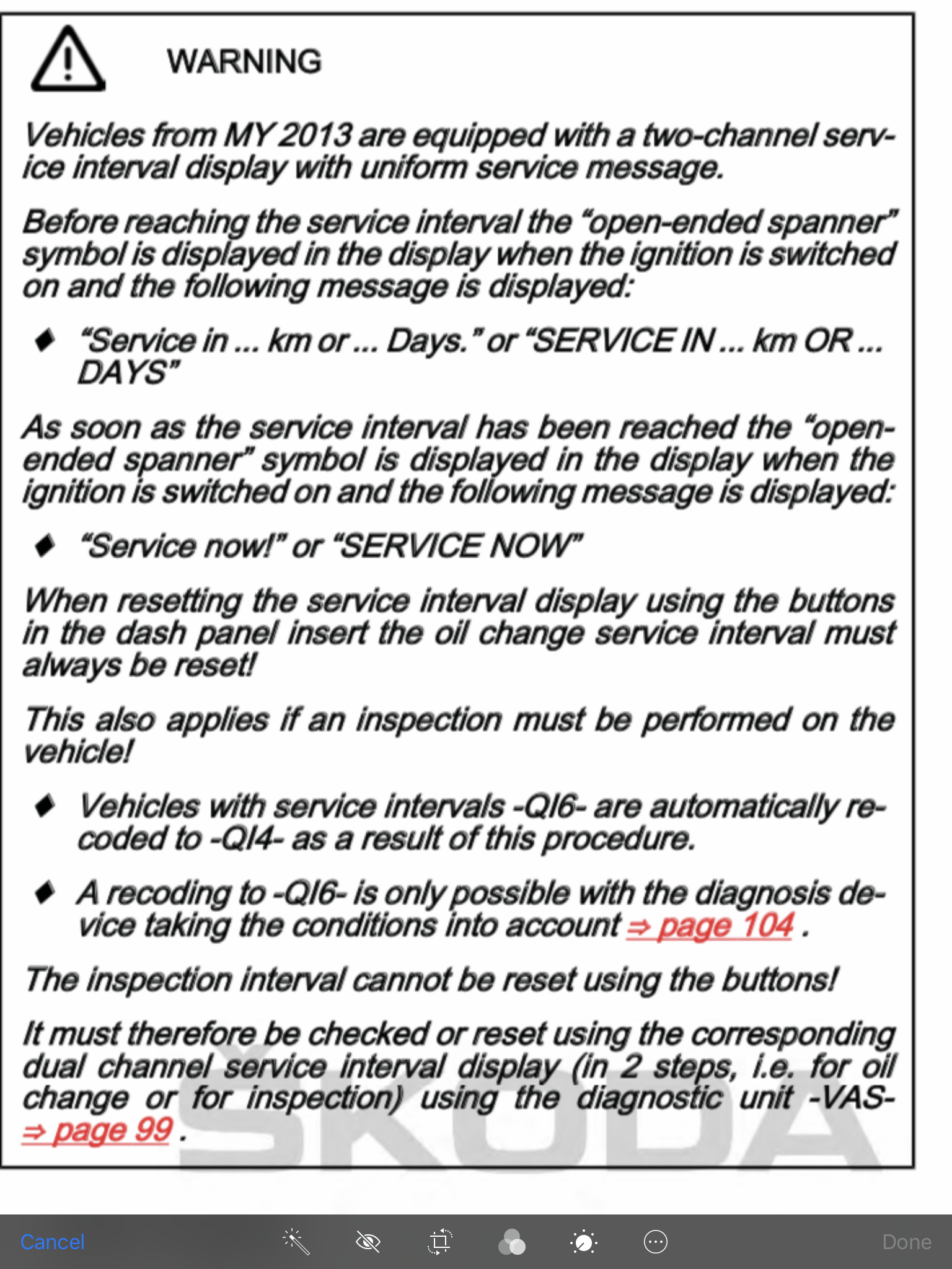

Just had a look in the manual and it seems on Model Year 2013 year you can’t reset the inspection interval with the buttons but on MY 2014 onwards you can...(Sasha, of course, was right !)
It explains why I was able to reset mine as it’s a MY15.
Edited by classic

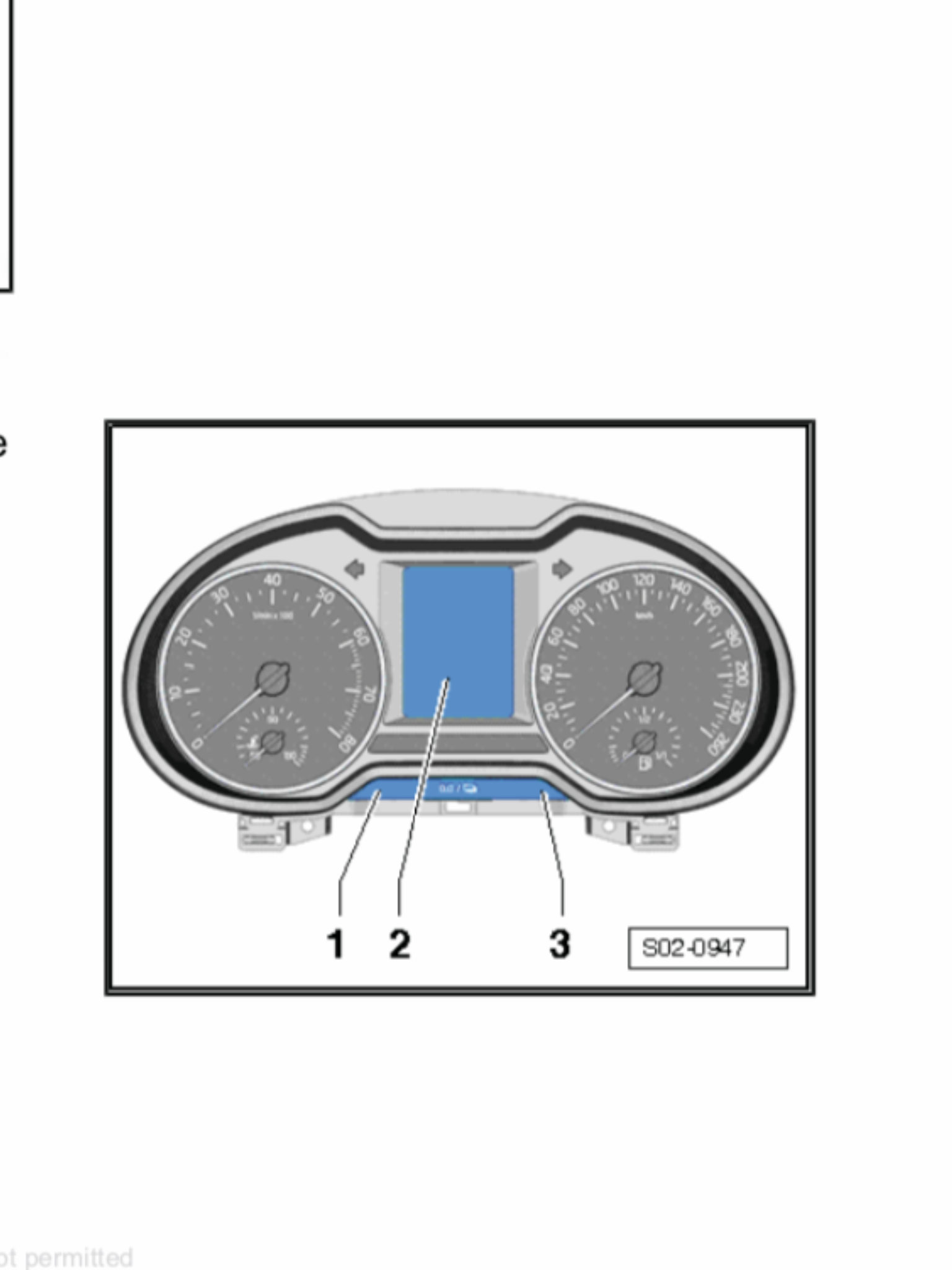

63762BED-A719-48D3-B48A-2F7887E78EC4.thumb.png.8ac45589fb12fdc2a90dbd20a5fc7542.png4BF0A364-6F07-44CD-B00D-C46D6ECA4005.thumb.png.107aaec79cd8b0e46c8c07059afc0baa.png
This is the procedure to reset by the buttons
Step 1 - switch off ignition
Step 2 - hold button 3 and simultaneously switch on ignition
Step 3 - release button 3 and press it again

To quote my own earlier post, the screen shot above is from the workshop manual for MY13 cars and seems to be exactly what your car display is saying.
Unfortunately the workshop manual says “the inspection interval cannot be reset using the buttons!”
Are you pressing the right hand side of the button (3 in the diagram) ? That’s the only thing else I can see to try, as the manual describes pressing the left hand side (1) for some other functions, and (3) for service resets.
Edited by classic
Yep, I think you got it right first time. On my car it cannot be done, if only I'd bought a car that was 12 months younger I'd be OK. Go figure.
