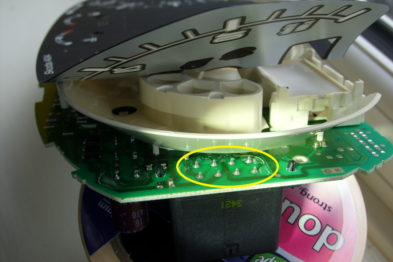

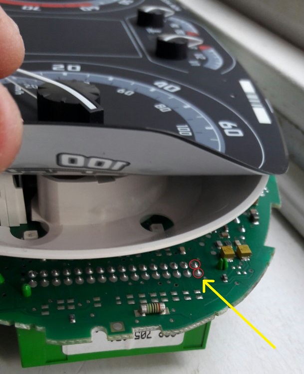

The cluster is very easy to remove. Take the plugs off the back and  spray them and the cluster pins with contact cleaner. If that doesn't work, check the solder joints where the plugs go.
The two joints shown in this first pic are the immobiliser ones, but check them all...
Green socket...
Black socket...
