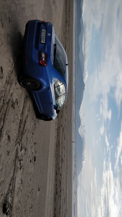

Heya guys, so thanks for the comments and all the advice! Unfortunately I couldn't afford a superb this time, so went with a 0% pcp manual 1.6d octavia.
Here's a pic.
Thank you all again.
Your Octavia produces a lot of downforce to stay up there.:tongueout:Congrats on the new car, as we all know Octavia's are better than Superb's despite their arrogant name.:blush
