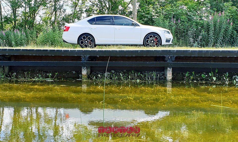

I recommend you find a new photographer. That reed in the foreground is really irritating. 😀
Edited by dan245
Haha (the reed) but a bit harsh!
Welcome Sean and nice car! White ones are the best!!
Revo Stage 1 would be awesome!  Others will have better advice than me for the other parts!
Enjoy your new car!
Sorry i wont take any more pics as i was the photographer 😉
Better ... ?
66518798_2836498389698178_1381034892803964928_n.jpg.03073da5ec7b1ea6c7d5be403f570f58.jpg.7fb4a89f29e0c63601b722bb028ce067.jpg
And yes white is best ;)
Edited by vRSWitter
🤩 Much better
..and another +1 on the white vote from me
