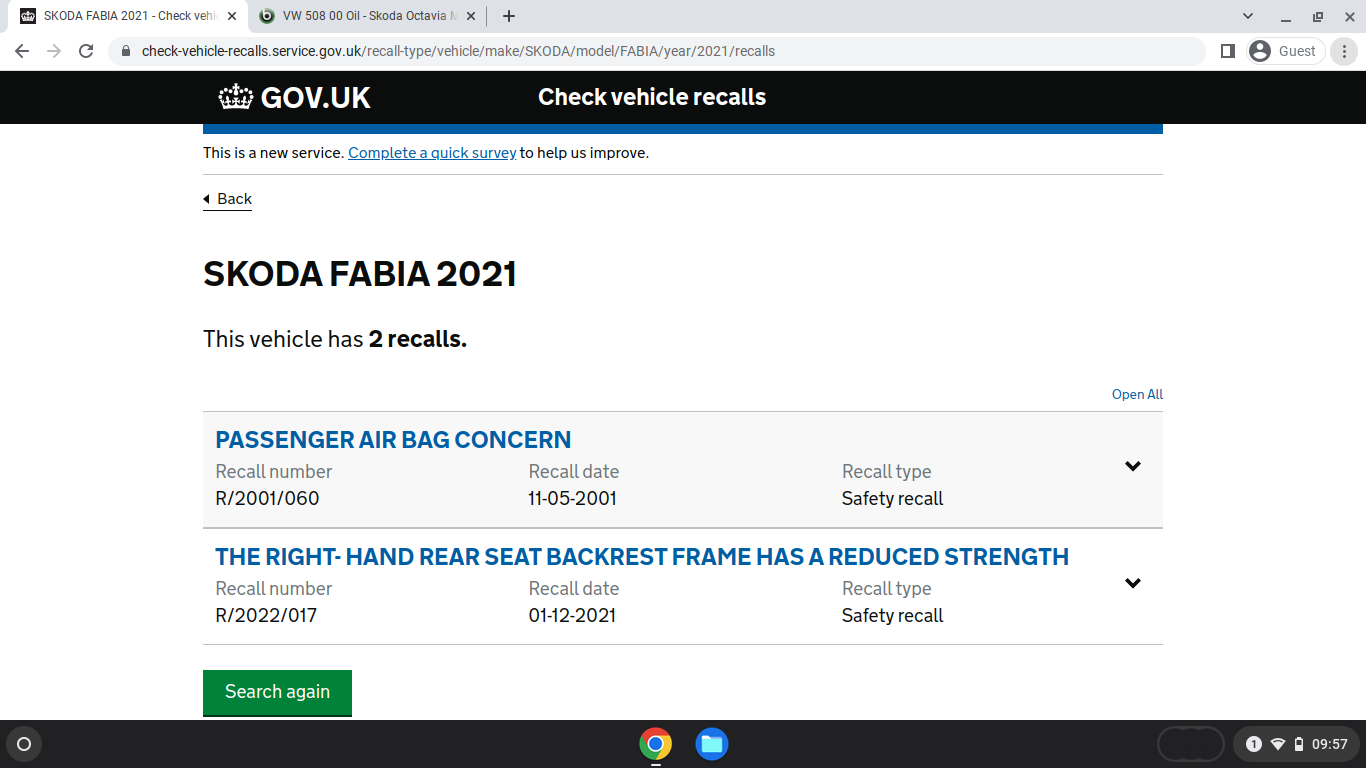

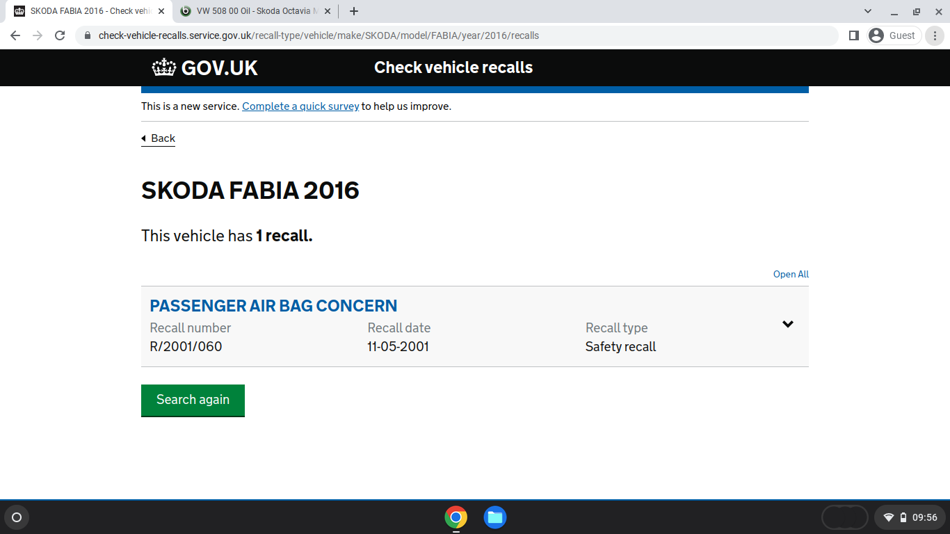

PS
Re Battery Recall.
  No there was not a Battery Recall. There are TPI's, even Recall Actions / Workshop Actions.
http://skoda-auto.com/services/recall-actions
But owners / keepers with cars not getting Main Dealer Services were not communicated with to have the car RECALLED because of a Safety Critical matter and the DVLA giving the VW Group / Skoda contact details.
*If you had issues or complained you might find out, you might even not find out and it came out of your pocket.*
Edited by toot
