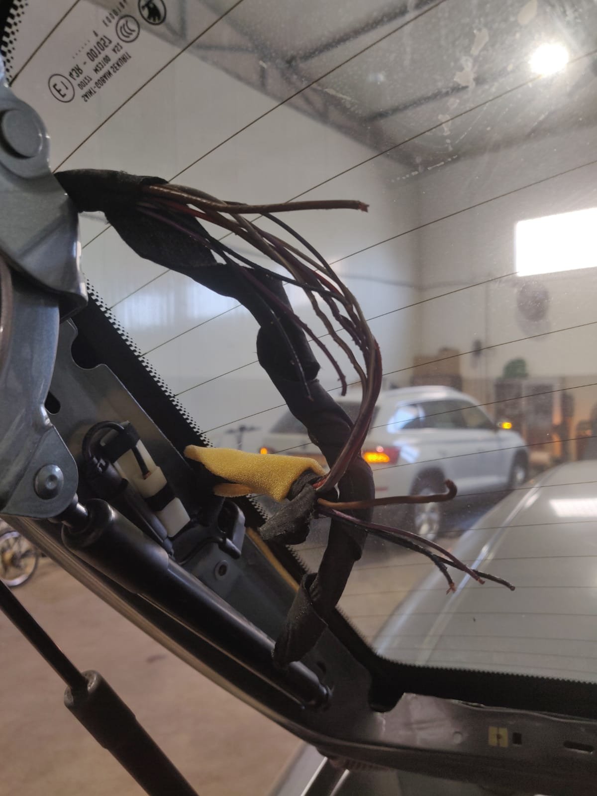

Good morning lads.
Yesterday I went to Skoda main service garage and told them of the problem I have. Of course they were astonished to hear and thought I puling a joke on them, but when they saw it happen no one laughed anymore.
To make  a long story short.. just look at the harness they took out ...
Some body is going to pay for it....

The failure of the wiring loom in the exact same position as yours is a common weakness on the MkII Superb Twindoor...
On 16/08/2019 at 07:19, Hiliks50 said:
Good morning lads.
Is the car an estate with single bonnet or hatchback with twindoor bonnet?
In the picture above (with the broken wires) the roof is visible. And there are no roof rails. So it's a hatchback. With the common wiring fault.
The internal struts are also visible, that are otherwise hidden by the trim and that operate the saloon / sedan mode of the Twindoor system.
