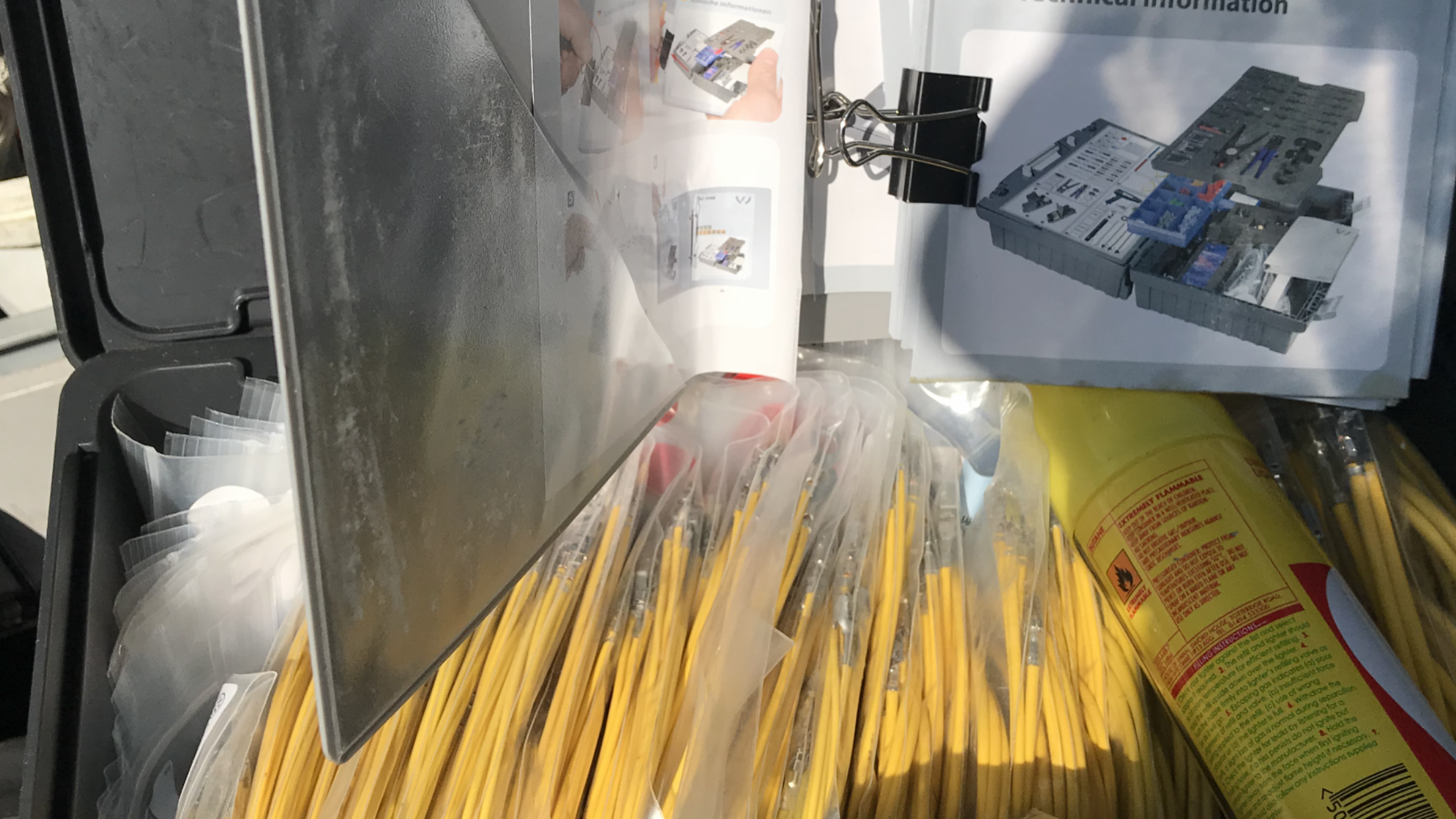

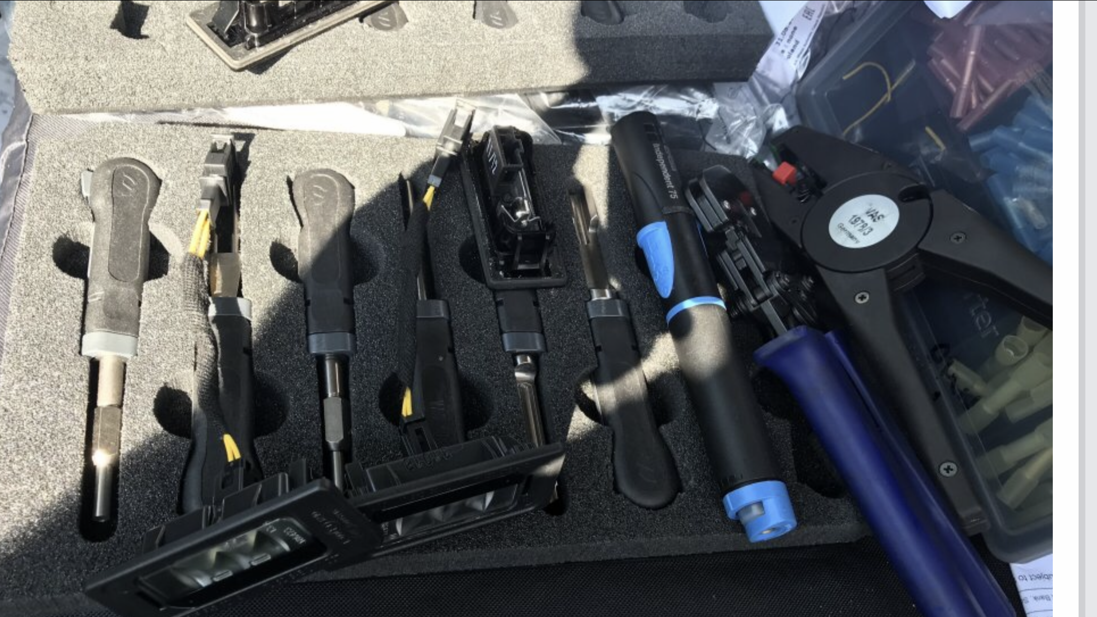

I still have a full VAS 1978 kit with the wire ferrules, terminal seals and correct tools to remove the terminals from the connectors without damage. It also has most, but not all repair wires and one of the best tools I’ve ever owned.
Top tip, do one wire at a time so you don’t loose track of where you are and take a photo of the plug connector prior to removing the wire again so you don’t put the repair wire in the wrong slot.
A pink lock may be on the connector which will prevent you removing the old terminal, it will need to be move to the unlock position prior to using the removal tool.
Tell TPS the part number of your connector and they will be able to tell you which removal tool you will need to buy, this will allow you to remove the pin from the connector without damage.

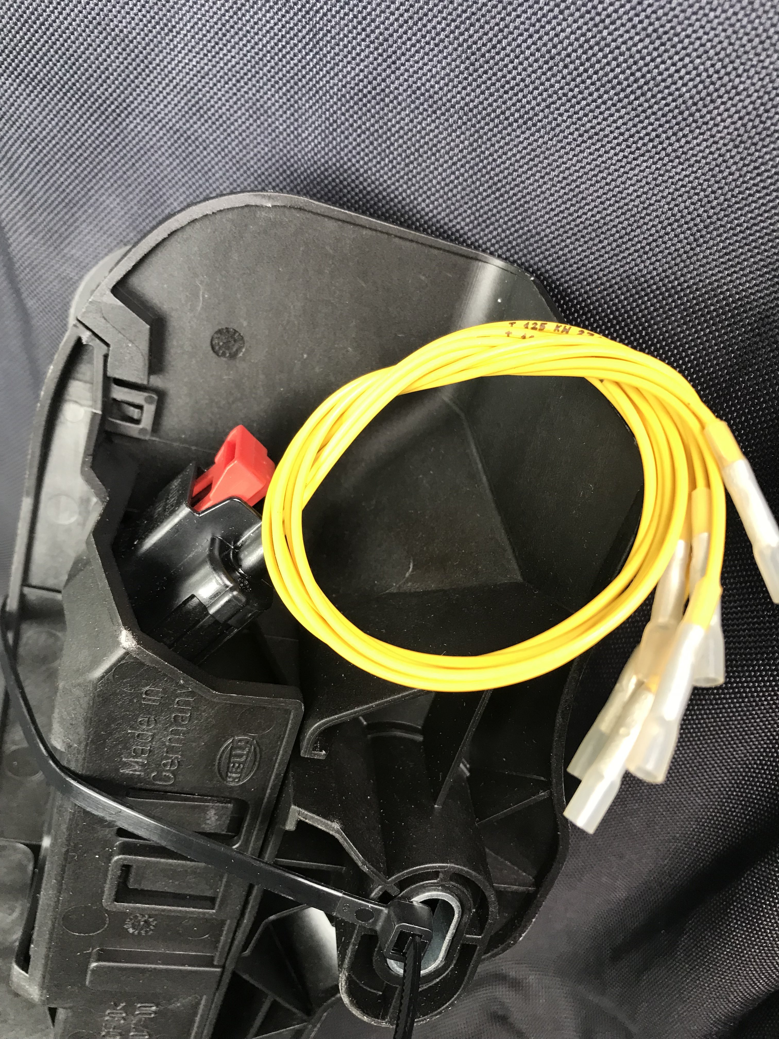

Repair set I made for throttle pedal connector:

Making adaptor looms for my genuine LED number plate lights with the 1978 kit.
